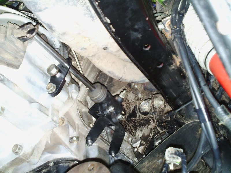

So i decided to do something about my over heating clutch slave cylinder, after a good thrashing she's a bit hard to get into gear!
As you can see there's not much room left after the exhaust went in.

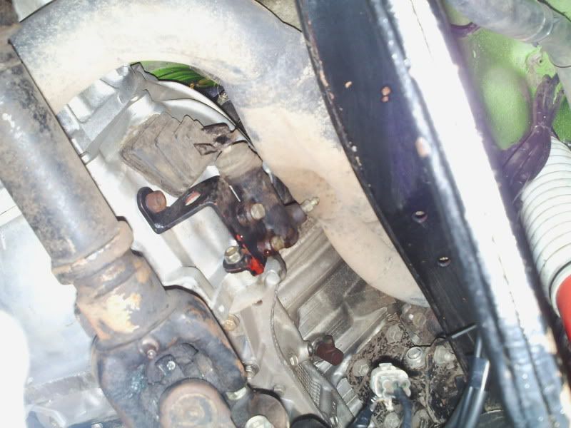

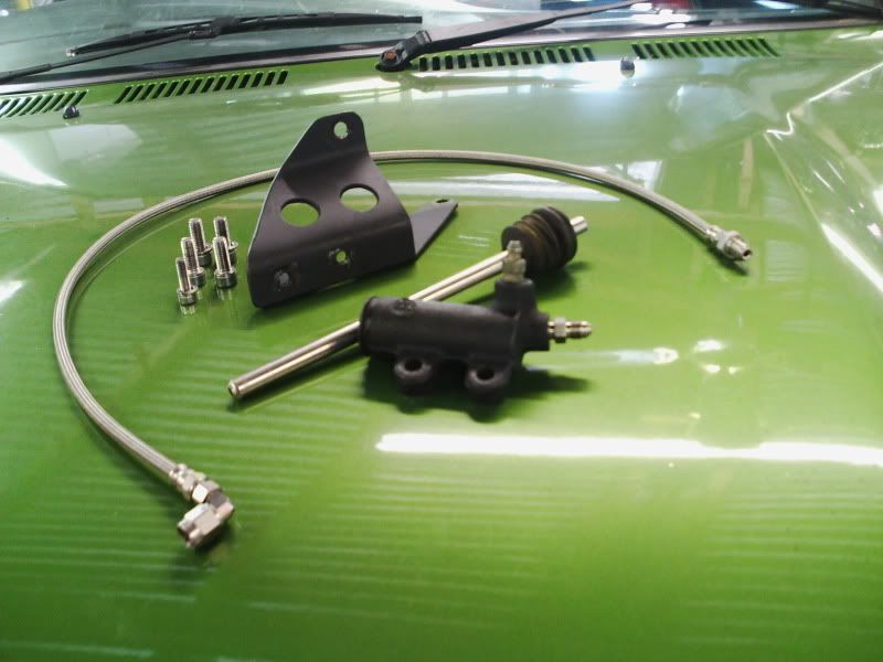

So whipped up some new bits, including a new fancy pants braided hose to replace the 2 brake lines joined together that were my clutch line
Installed all the new bits, a lot more room around the slave now. May add a heat shield later aswell.

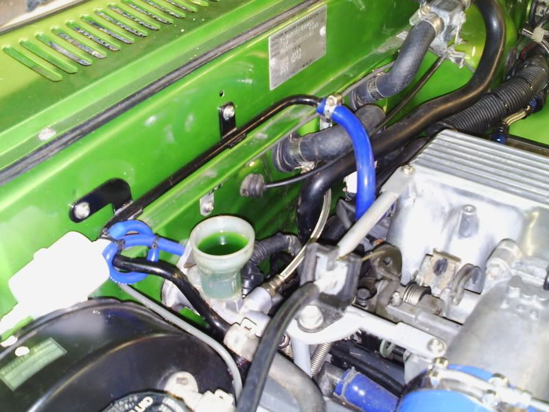

Topped up with nice green fluid and she's all go again
