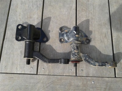

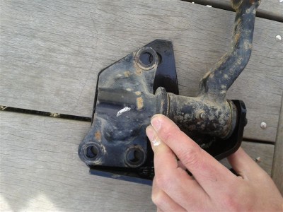

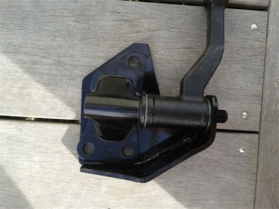

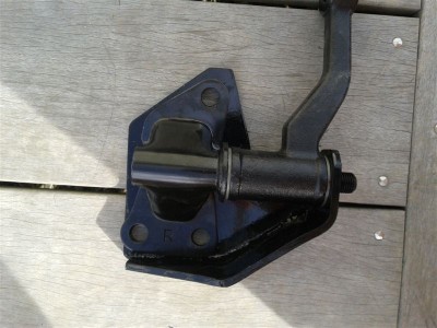

Anyway, had some interesting fun with the idler arm brace.
Seems like there are 3 idlers out there:
- The stock standard Nissan (12mm shaft and slightly longer)
- The replacement from BNT, Repco or Part Master (14mm shaft and shorter by 5mm)
- Some other one which I haven't seen yet, but apparently it's bigger again.
Just watch out when you are looking at getting the brace. Not sure what Calmini provide but you could end up with slop on the bottom shaft or 5mm out on the main body mount.
Thanks DEATH_INC for sorting it all out :)
Anyway the brace is in .....
Old vs. New (14mm)
Old vs. New (14mm)
Old arm on new brace
New arm on brace
New arm on brace
