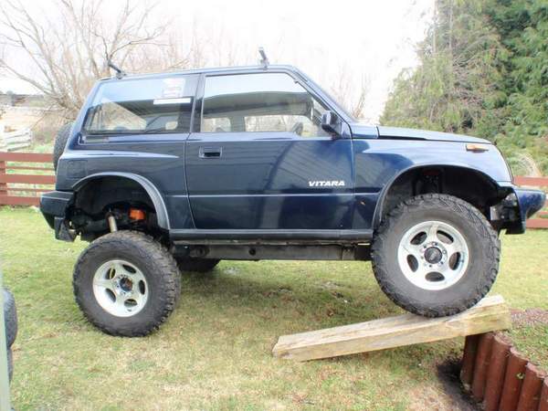

Obligatory flex shots. Testing the set up with the new additions. Checking what the current limitations are etc. The 'wheel ramp' was 900mm high.
The front has the sway bar still on it. Actually the sway bar limits the travel on the front.
I had to stop on the ramp as the front drivers side wheel started rubbing on the arch. I didn't cut any of the fender material out when I put the flares in. Just metal out of the inside.
The rear passenger side tyre still has some space to travel into the wheel arch. The spring was fully compressed, so should not hit the arches.
Note that this is without cutting the rear guards.

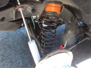

It is hard to see, but there is 10-15mm gap visible between the rear spring spacer and spring. When on the jack stands there is 60mm.

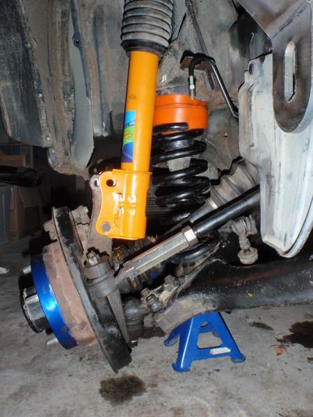

Spidertrax wheel spacers, FTS struts, Extended brake lines, Strut spacers, 15mm + 32mm Spring spacers, V6 springs. Would love to add control arms too, (and bigger springs). I bought some spring compressors to help install the springs. Big help. At full articulation the tie rod sits on the sway bar. The sway bar would have to be removed to go higher.
This shot just shows the FTS shock repositioners. Can't be seen in this shot, but they are also held by the pin that holds the rear control arms in addition to the original shock mount holes.

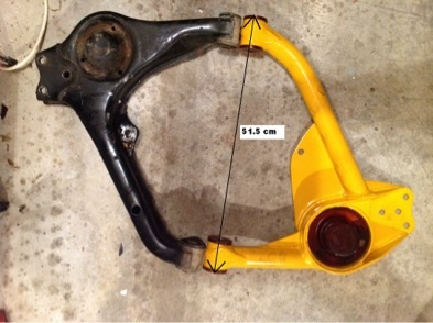

New control arms and spring angle.

how high can you get the front wheel off the ground with the other 3 still on the ground?.
Re: V6 springs + VL Commadore shocks
Posted: Thu Jun 28, 2012 6:11 am
by crzyfl
Right now its 900mm+.
Expect if I do something to increase guard clearance in front it will be up to 1200mm.

i mean under the wheel, it looks like you got about 500mm or so at the most, if 900mm like you say you could put a 31/10.5/15 wheel under your front wheel and still have space, on my old one i could get about 650mm with more wheel travel in the rear and no sway bars and longer shocks in the front and the front suspension was compressed ,the pics of it were on the cheap vitara lift thread but seem to of gone now. they are a awesome little 4x4 but let down by the front suspension, and the front diff is about as strong as bluetack ,i blew 7 front diffs and 1 front axle in 3-4 years of hard 4x4ing including a couple of comps,probaly still bits of alloy scattered through 42 traverse and ngaroma :lol: . rear locker will help preserve front end, i locked both diffs in the end and was good then,need some pics of it dirty.

That bit of garden the ramp is resting on is 900mm. It might look a bit smaller as I was moving around to make the photos look more dramatic.

On fitting the control arms I found an issue...they do not fit. Contacted the supplier, and showed him. He said this is often encountered with vehicles that are driven hard off road, and that they spread the control arms to fit with a hydraulic. My vit was towed with an a frame (I still hit my head on the brackets). Something to be aware of. The difference is 12mm! See below,
I tried spreading the arms with my trolley jack, and managed to get a few mm, might go try to get some more now.

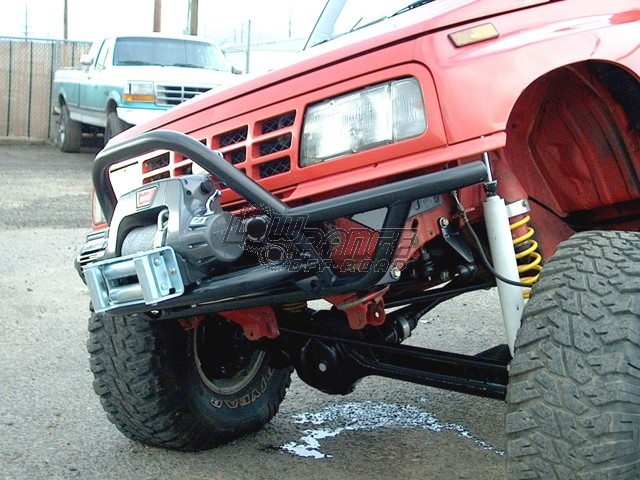

Back plate of intake manifold for carbs is cut. Just need to get runners welded on. Mate just put two sets on his v8 rover track car.

This is her now.
