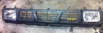

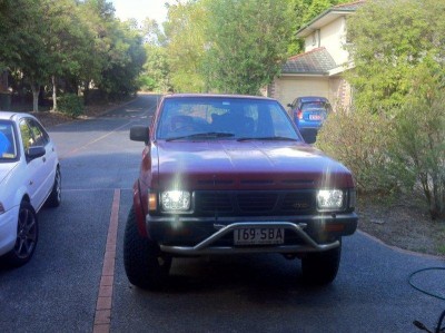

Got my new hid lights today. Also fitting a later model navara grill from a d21 ute I chopped up.
Give my terrano the more modern look, I also think the grill will flow more air as well but hey who knows.
The stock lights are a joke. Like a dad joke( not funny).

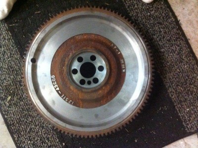

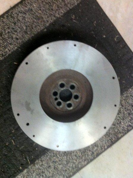

Here is my flywheel lightened up.
It was at 17 and now its at 13 kilos.
I asked to have more removed but getting quality work out of an Australian is near impossible.
So 4 kilos will have to do

wax wrote:Got my new hid lights today. Also fitting a later model navara grill from a d21 ute I chopped up.
I like those grills. This is something I would like to do to my Terrano if I can source one cheap enough.

Yeah they do look better ay.
A friend and I bought a d21 for 350 and wrecked it. had a td27t in it as well as lot of other parts. Manual locking hubs etc.
If you decide to get one of these grilles you need the light support brackets as well as the park lights as this grill sets the head lights higher in the car

I put the lights and grille in today. I will be interested to go for a drive tonight and see how bright they are.

Looks good Wax. Those the crystal type lights?
I guess another bonus of changing to those square style lights is you can get full sealedbeam type, good if doing much river/water driving. Just make sure you get halogen not the cheapy ones as they are terrible light output

Yes they are the crystal type. its semi sealed ones. They are hid lights.
http://www.ebay.com.au/itm/150601545378 ... 861wt_1185
http://www.ebay.com.au/itm/230528077616 ... 150wt_1139

F'n cool grill 8)
Retro HIDs not road legal here in low beam :(
Beware the slider for high beam can seize up :wink:

I have been out today just getting my flywheel ready to be machined to fit a gtr pressure plate. They have the same cover as an rb20 std from what I can gather but bugger that I want this sucker to hold in there

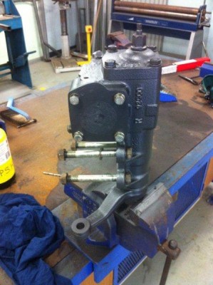

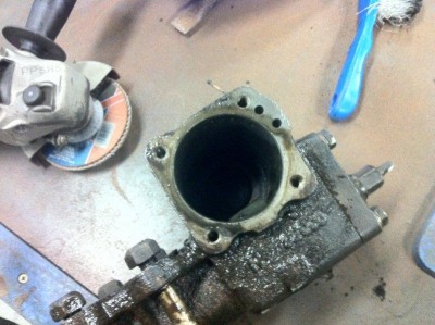

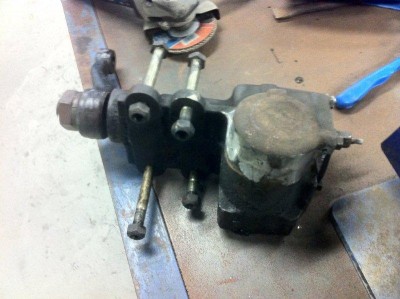

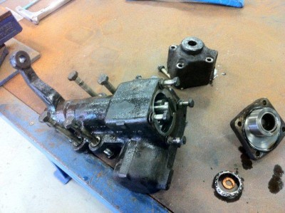

Ok well its full speed ahead on fixing my steering now as its not a nice thing to drive anymore on account of the centre link worn out again
I have decided to do the steering box idler arm thing and started on it today.
Here it is stripped then extra stuff cut off and welded back together. Its great being a shop teacher.

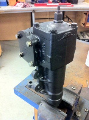

OK well here is the steering box all cut down and almost ready to go on.
I have to slot the holes but I decided to paint it and will touch it up afterwards as well.
