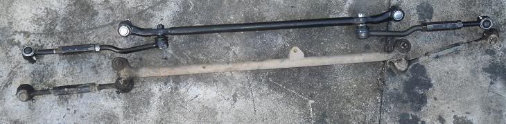

Old steering setup Vs modified 2wd setup

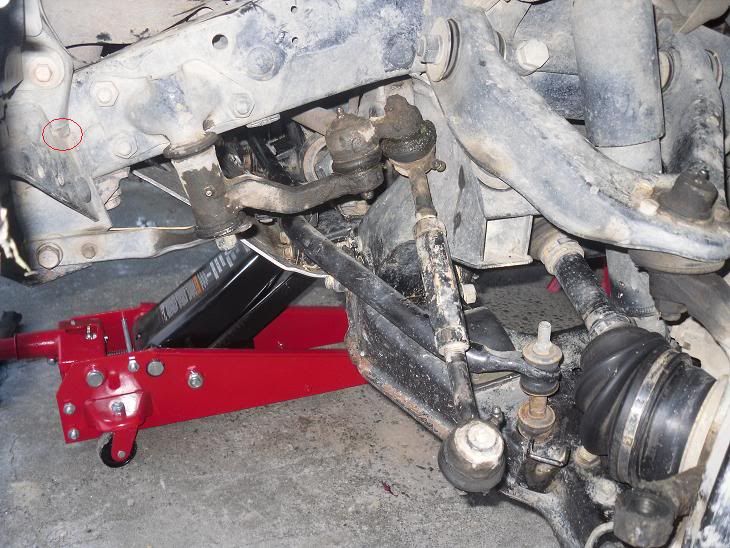

Removal of old system. Found a crack developing at bodymount (circled in red). Can see my simple idler brace too.

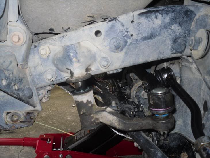

Easiest way to fit is to drop idler as new tierod sits right under chassis rail.

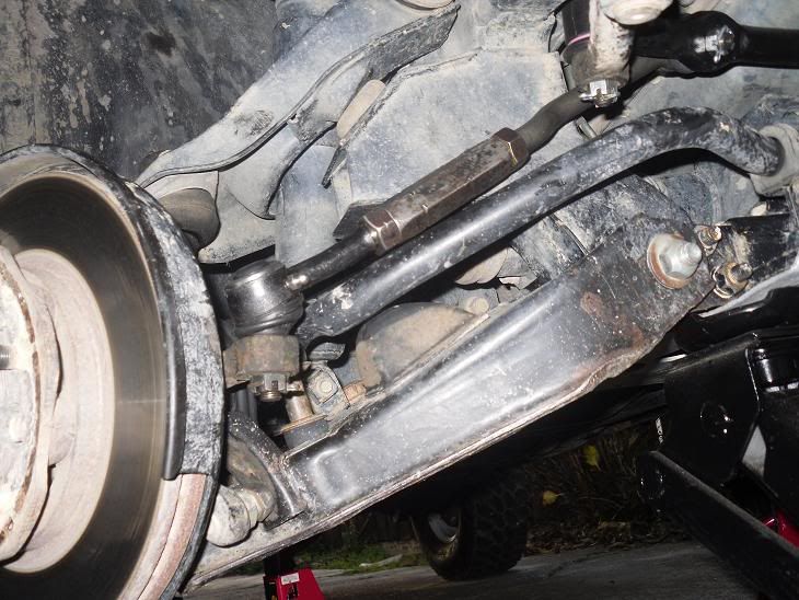

At steering straight ahead, max down travel, still heaps of angle left inside tierod outer joint

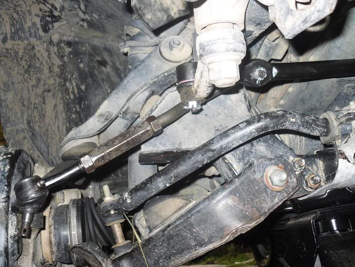

Full lock, max downtravel, not much clearance between swaybar and tierod adjuster (not just photo angle making it look close)
