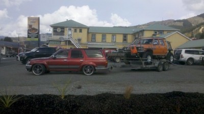

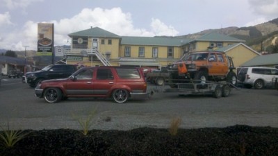

by imsohi
I disagree with the title of this thread, yes if you think you can jump into a 1kz vehicle and think you can tow a big trailer cause its got the power you will run into issues but with the right things done to the motors they can be great. in saying this every motor i have got has had a head cracked previous to me getting it and i have replaced it with a GENUINE replacement also doing waterpump thermostat and getting the radiator striped and cleaned at the same time then throw a egt and in my case a manual injector pump and front mount intercooler to date i have had no issues. Last year we did around 10-15 thousand kms towing around both the north and south island, this wasnt easy towing either 3 1/2 ton of competition truck/trailer and spares,
along with this we also have done a south island tour and a trip to raglan all in the same vehicle without an issue. My egts get up around 680-700 max pulling uphill around 60-70 kms at 16psi before i will back off and that takes around 60 sec. IMHO i think The 1kz are a great motor to tow with if you spend the money and do the right things to get them right for towing.
