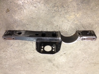

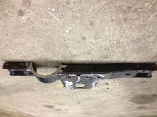

So time for a quick update. Got the cross-member all finished tonight.
Will be making templates tomorrow to mount the radius arms.
Have found that I can use the factory sump with only some small mods required to make it clear the front diff. Ill post some picks when I can get some clear shots.
Here is the cross-member for now. Sorry about them being upside down. Stupid phone sometimes does that.

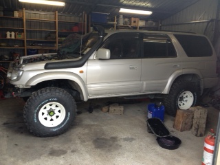

Been a busy day, got the radius arms mounted up and the truck sitting on its own weight. Got it sitting pretty good I think but will have to get it outside and see what it looks like. There are alot of loose ends to tidy up yet so I guess im about half way. The surf chassis is about 100mm wider than the prado so ill need a new panard and steering rod made to suit.

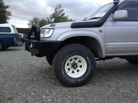

Update time, got my bar last week. Looks the bizzo, seems my truck has had a hit in the front right corner before. Will take a little tweaking to get it to fit.
Also got my sump sorted, a fella I work with gave me a 1kz short block out of a 130 surf. Had the pickup and all the stuff I needed. A small amount of panel beating and shes a good fit.
With not running and body lift and keeping the trucks height quite low I have found a few areas that needed addressing, 1 being the sump and the other is the front drive shaft wanted to hit the bell housing (on bump stops). To fix that I am running a normal hilux diff head (low pinion) in the front and am making all of the steering run off the front of the knuckles similar to a FJ40. Should be a pretty good setup I think.
Then its out with the motor and box and get alot of welding, wiring and cleaning up done. All seems to be on track at this stage.
Ill try get some pics tonight with the bar on.

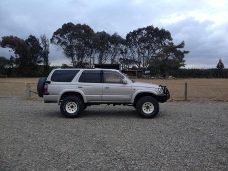

Few pics of it on its feet.
