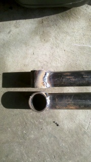

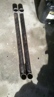

Made up my spare arb front diff today also pressed the bushes out of my rear link arms so i can get them all welded up.

Diff arms all welded up need a quick spray paint then press the bushes back in

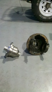

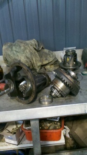

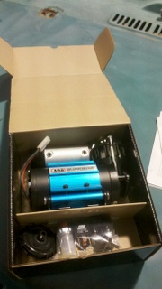

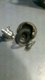

Yay :mrgreen: Shiney new bits showed up today

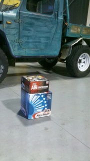

Arb locker and compressor Many thanks to Bruce hughes (Hughes Autos) in Winton who did me a real sharp deal on these Being the Tokin Maori is paying off :lol:
now waiting on the bearing kit from central 4wd so I can put the 80series diffhead togeather thinking it will be wednesday. Pics of all the gear including the 4.88 ring and pinion i brought off trade me 2 months ago

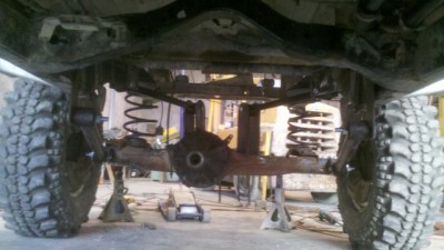

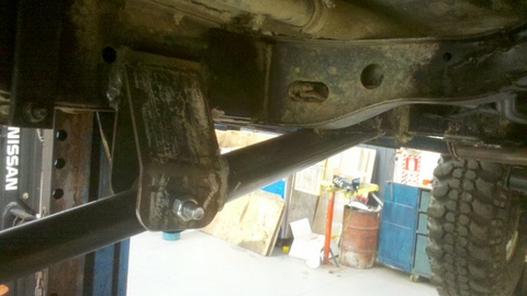

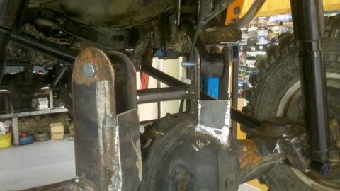

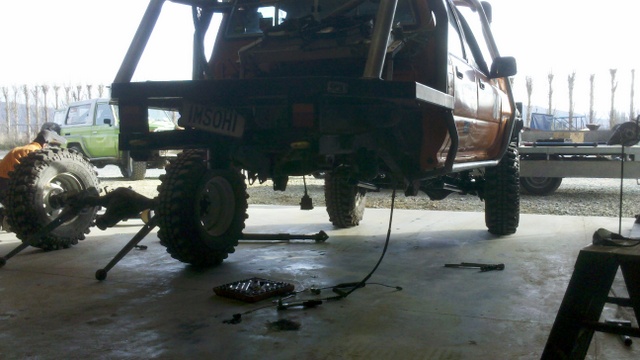

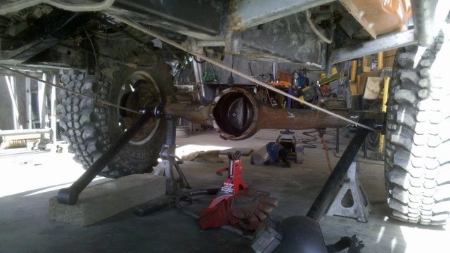

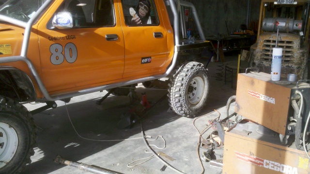

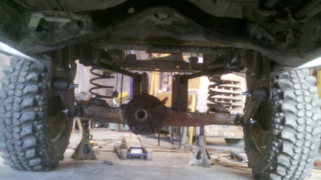

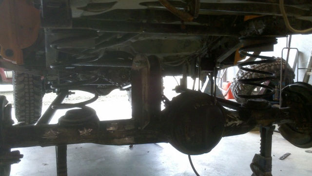

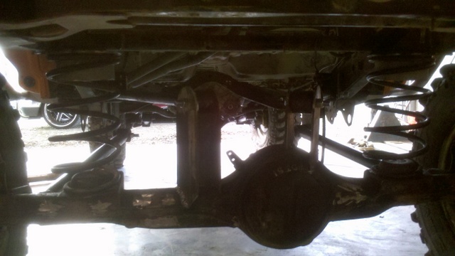

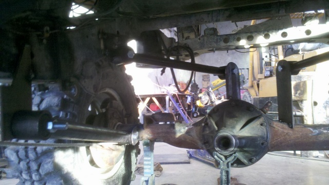

Finally got my enthusiam levels up and got to putting the rear axel in the hilux, the axel is an 80 series landcruiser with custom 4 link setup thanks to Craigs4wd and DaRam for the info on 4 link setups and a huge thanks to Pete Spring Creek Engerneering for the use of the workshop for the weekend.

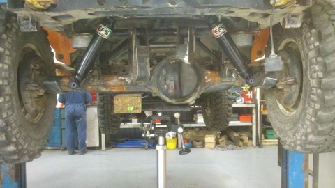

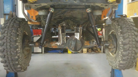

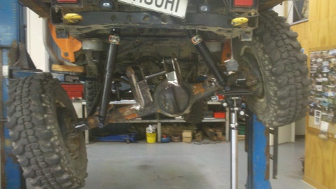

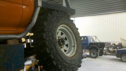

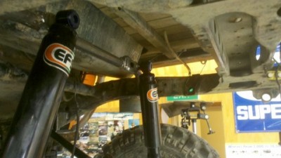

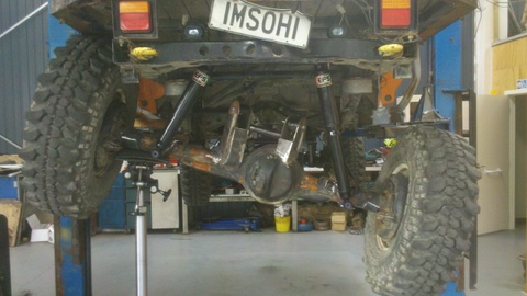

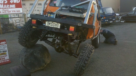

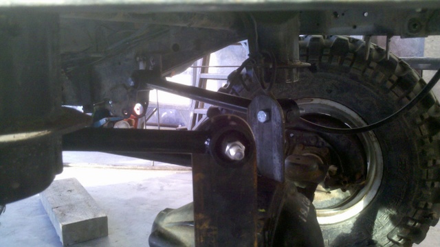

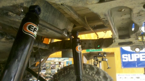

Finally gave the motivation tree a good soak and got a weekend of work done on the hilux rear axel, its all mounted now :D . EFS long reach shocks that match the twin shocks in the so all 6 in the truck are the same. This was my aim through the truck as all bottom/top link arms are matching and all wheelbearings are the same, hopefully should lessen the parts i need to carry.
imsohi
Posts: 727
Re: V8 blowen coiled LN106
Post by imsohi »

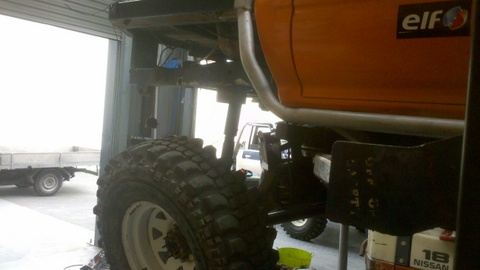

it has ok articulation at this stage but need to lift the deck as it hits and is only using 2/3rds of the shock so can still go another 80mm up something to do later down the track.
uses all the shock here at full up and has 30mm of clearence off deck.

Pretty slick man 8) 8) What are the rear link bushes out of?

tomsoffroad wrote:Pretty slick man 8) 8) What are the rear link bushes out of?
Thanks. Link bushes are from a surf

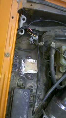

Another weekend sorting some things on the hilux, had the miss's as a little helper for the weekend so got her to put all the interior back togeather while i sorted out mounting the two front seats from a wrx. Also got my relay box mounted and started wiring it up, and my rear brakes put on and ran my brake hoses, not much interesting to take pictures of.

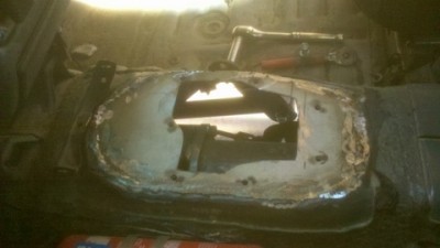

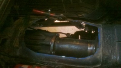

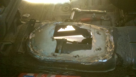

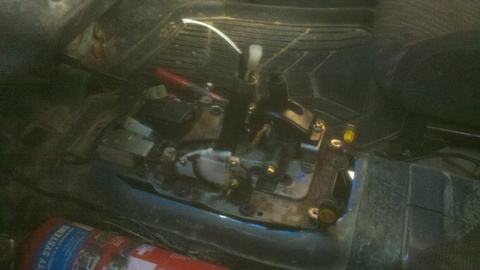

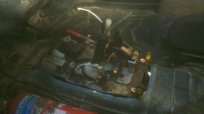

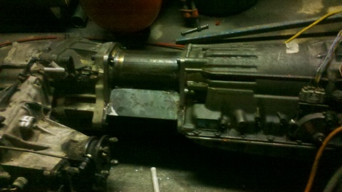

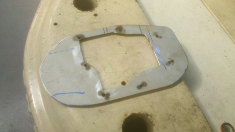

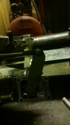

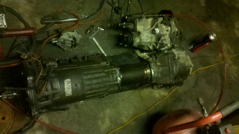

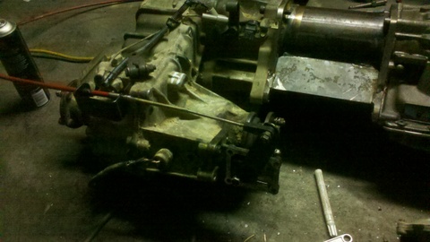

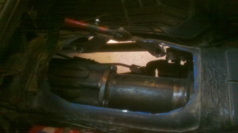

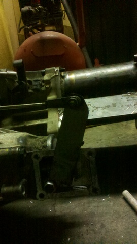

Tonight pulled out my spare auto and transfer to sort my adaptor spacer after getting it from my engineer last week, i have made it as my drive shaft is to short and to much stress will be put on the uj's. also removed the vacume engaged 4wd and made a morse cable lever setup instead

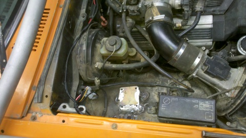

this weekend sorted my auto shifter and hi/lo shifter and made up all the arms ect. mounted my arb air comperssor removed pipe below the window and fitted the bonnet properly, hooked up window washers. all slowly coming togeather now need to get drive shafts measured and made
imsohi
Posts: 727
Post by imsohi »

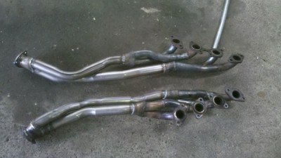

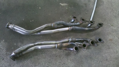

got the truck dropped off to Andrew Murry at Murrys Muffler Service to make the extractors and a tempory exaust on thursday then was off to seafest for a good old blow out on the weekend. got to see these before i left
imsohi
Posts: 727
Post by imsohi »

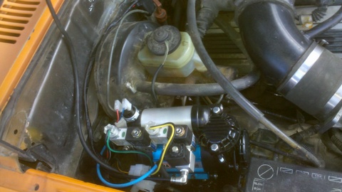

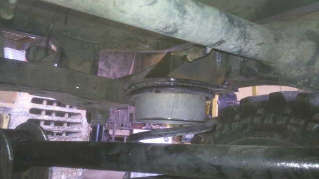

imsohi wrote:mounted my arb air comperssor removed pipe below the window and fitted the bonnet properly
Mounting point for the compressor
All mounted and plumbed up

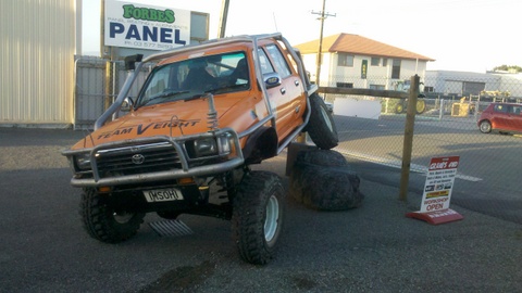

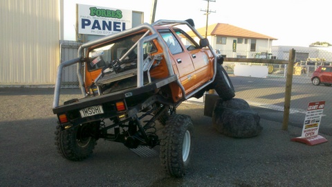

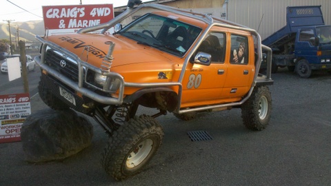

Went in today 4.30 to check on driveshaft progress Nothing but he said he was about to start them. 5.30 went in to see him 1 down and the other one 50% done :D 6.15 2 new driveshafts. Now off to Craigs to fit them and see what it is like on the rock.

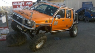

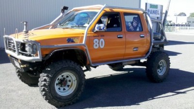

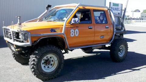

Finally all togeather looking
front up
front up
back up
back up
