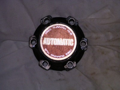

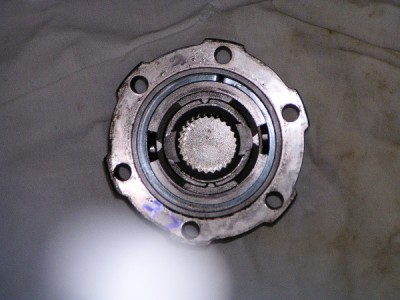

Finally I have the time to get back into this.
The Hub is 27 tooth. And if i do this right looks like this.

sibainmud
Posts: 1846
Re: When 1 wheel looses traction, all wheels stop driving.
Post by sibainmud »
Nel wrote:
kiwipete wrote:I may still have my old auto hubs here somewhere if you want them, but you will have to pay postage from Christchurch if they are what you want.
Give me the spline count off yours and I will check them out for you.
This would be most appreciated. Yep not a prob to pay for postage. Do you have fastways down there, they often cheaper than NZ Post. and always cheaper than NZ Couriers.
I will get some more time over the weekend and PM you then.
Yours will be 31 spline, Pete.
27 spline common as dog poo. I have a pair here that are surplus as i have upgraded to 31 splines :twisted:
Contact me if you need, Nel.
