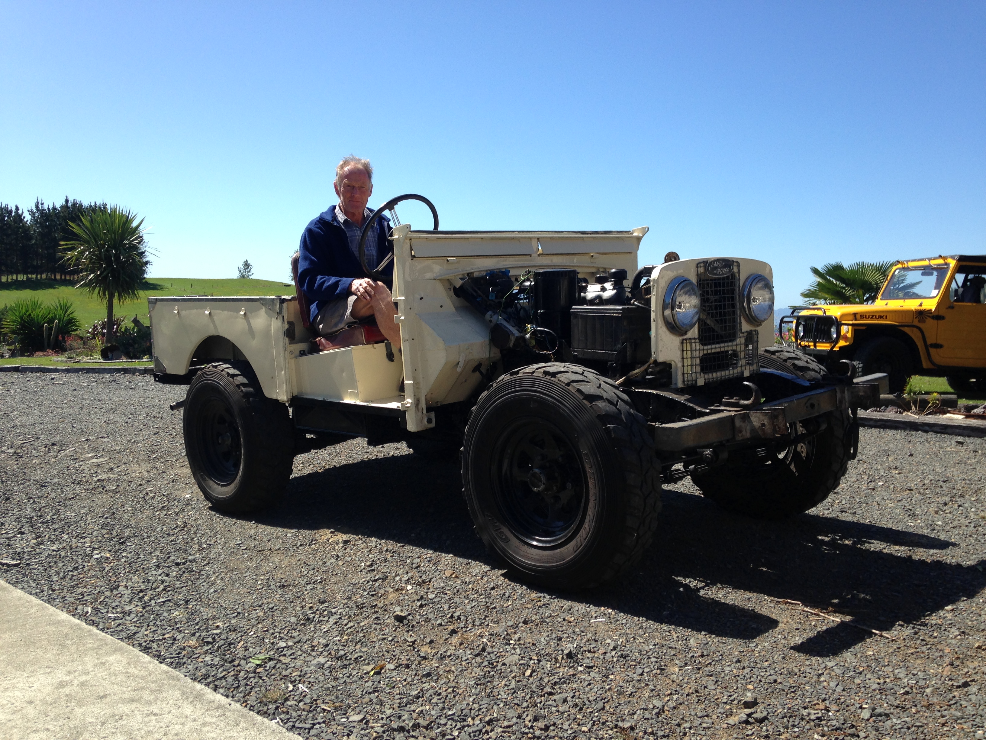

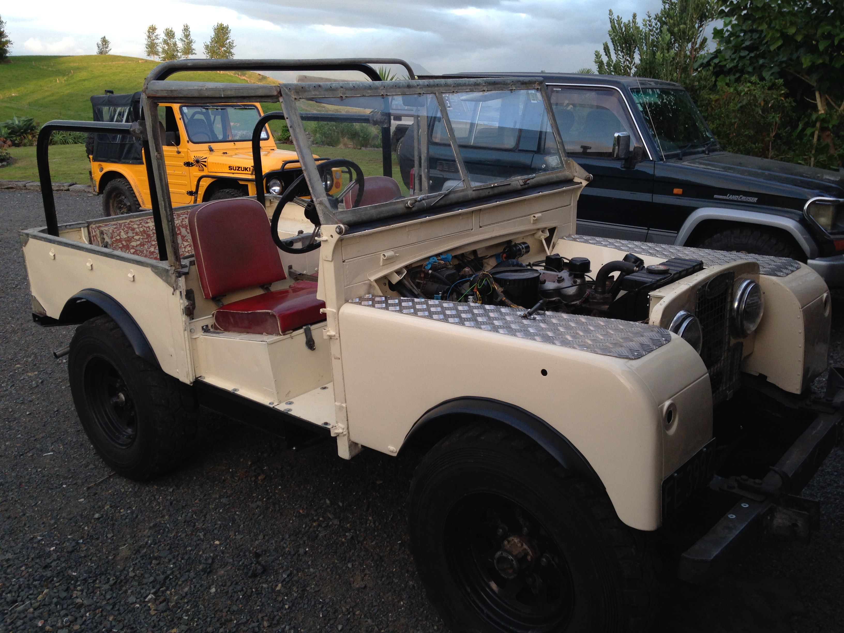

The other weekend it left the garage under its own power for the first time in 4 years.
Re: Rocky Rover 1955 Series 1
Posted: Mon Mar 21, 2016 7:26 pm
by DieselBoy
That afternoon we got carried away and started fishing parts out of the depths of the shed to refit....
Posted: Mon Mar 21, 2016 7:35 pm
by DieselBoy
We have had the restored front fenders stashed away carefully, so with the exhaust valve clearances set (side valve engine), the time to fit them was now :)
Posted: Mon Mar 21, 2016 7:39 pm
by DieselBoy
To finish off the guards and hide some of my repairs, we adapted some S3 alloy guard tops to fit. They make good work benches too.

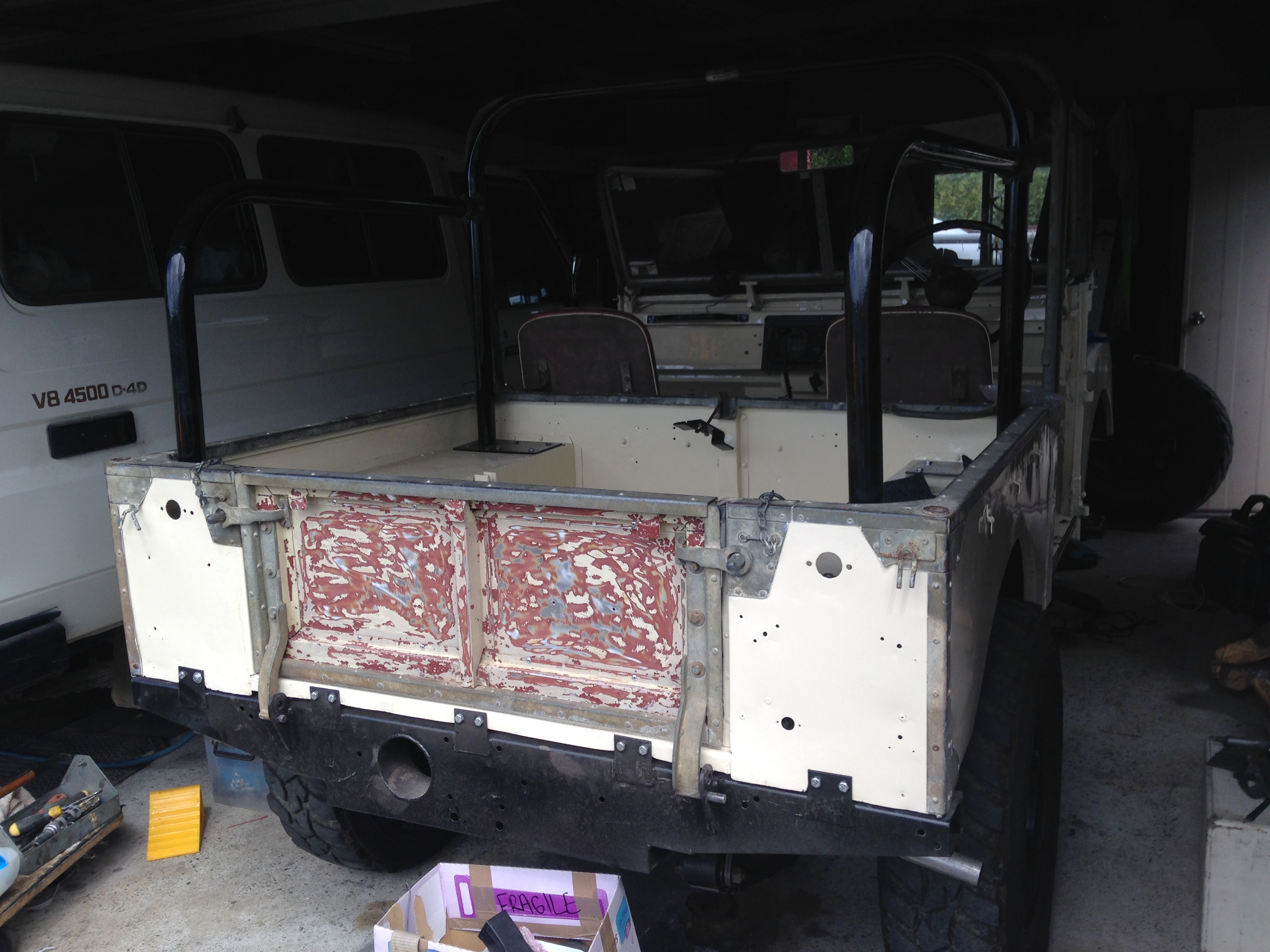

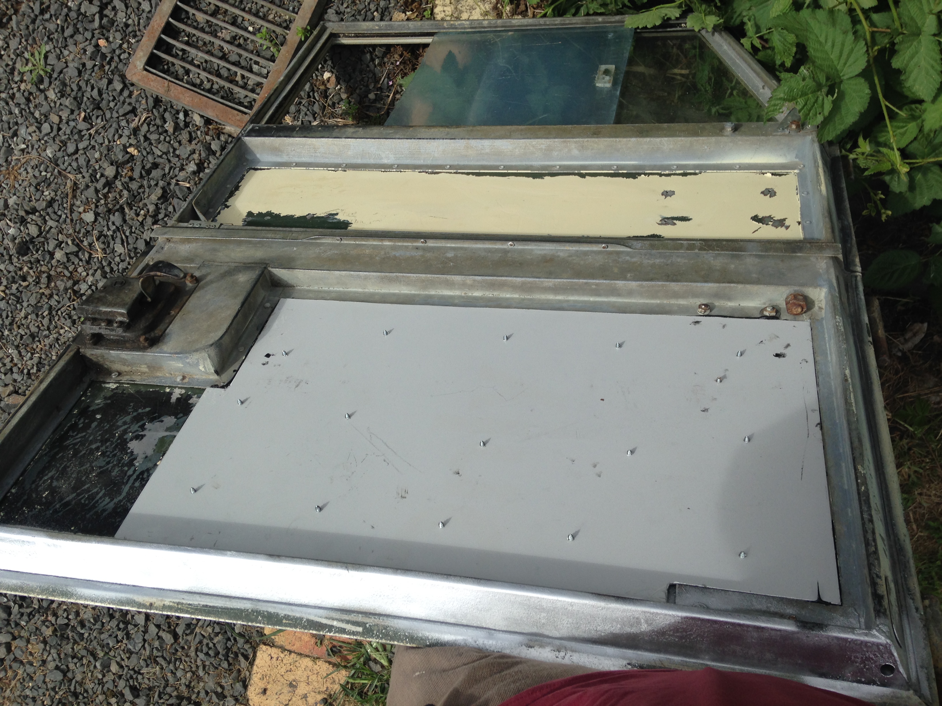

Posted: Mon Mar 21, 2016 7:58 pm
by DieselBoy
Time to sort out some of the minor issues, wrecked doors, tail gate that doesn't fit the new cross member, bent bonnet etc
This is the best I can do to give the doors another chance short of making a new skin for them. Maybe I'll do that on the next rebuild ;)
So what your looking at, is two alloy doors that are quite damaged. Once alloy is damaged it doesn't come back into shape, it stretches and gets a spring to it.
So the experiment is to make a reinforcing plate to go in behind, and urethane it in place to take the spring out of the skin. Most use rivets to hold the reinforcing plate in place until the urethane sets. You them grind the heads off the rivets and job done.
In this case you see both sides of the door skin, so rivets weren't ideal. Tried self tapping screws as an experiment and seems to have worked out ok, the screws came out tonight and the plate stayed tight to the door skin :)
Posted: Mon Mar 21, 2016 8:08 pm
by DieselBoy
Dad on the strip disc taking the bonnet back to bare alloy. It's hopefully gonna be the blingest straightest panel of them all. Maybe haha
And the bloody tailgate. Who knew huh :lol:
Better tidy this up properly later on ;)

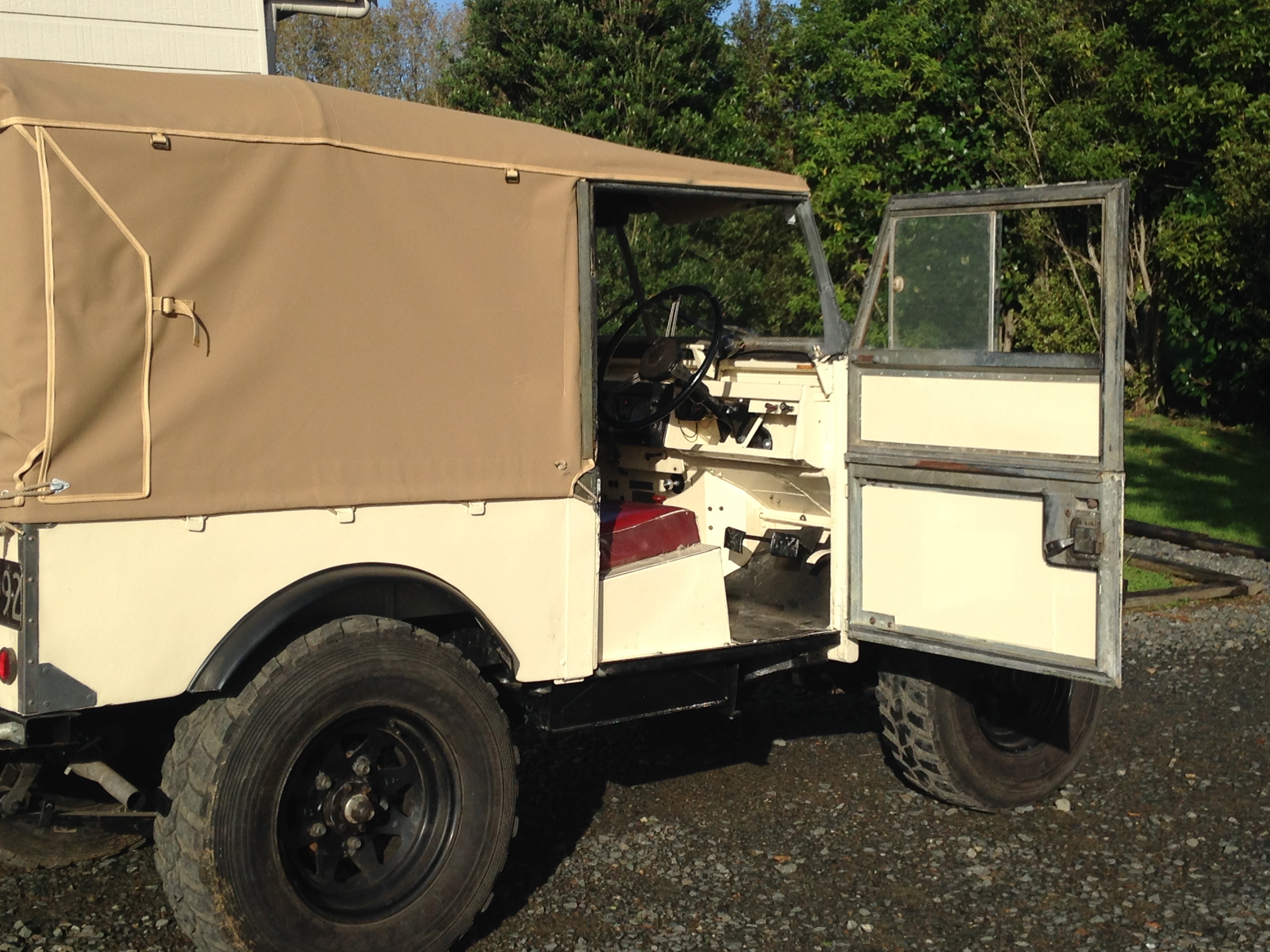

Doors :)
Posted: Sat May 21, 2016 10:45 am
by DieselBoy
They look ok on the inside too :D
