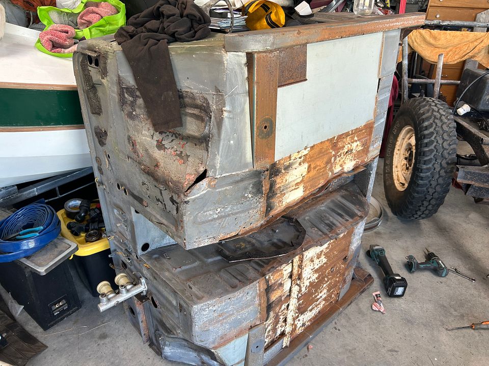

Cut the cage and tub off ,
Then cab off for the first time in 12 odd years

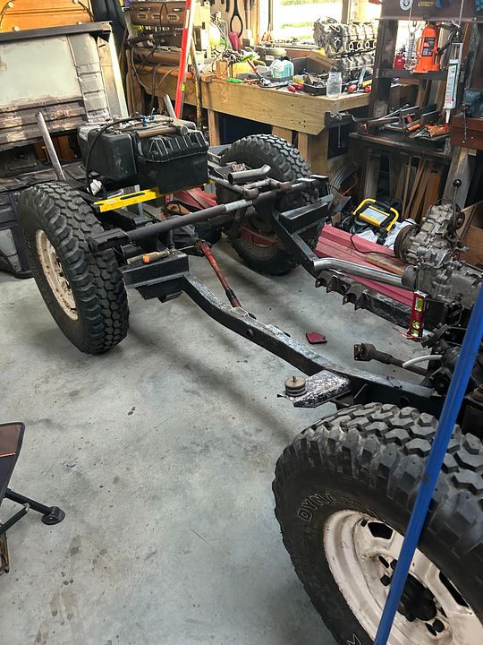

Quick exhaust mockup and out with the x-fer to finish the chassis welding

Fuel lines in
Brake lines in - going replace these hard lines with new eventually
Fuel cell and battery box mockup sorted , and a plan is in place for the rear tub .
99% of the chassis welding and xfer mount welding is done , let’s just say it’s strong and I’m a really good grinder …….
Exhaust is progressing but waiting for a muffler from a mini to show up.
Next is gearbox out to check the clutch situation . Because I can’t remember what’s in there
And then the body can go back on temporarily to get the rear roll cage mounts positioned.
