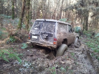

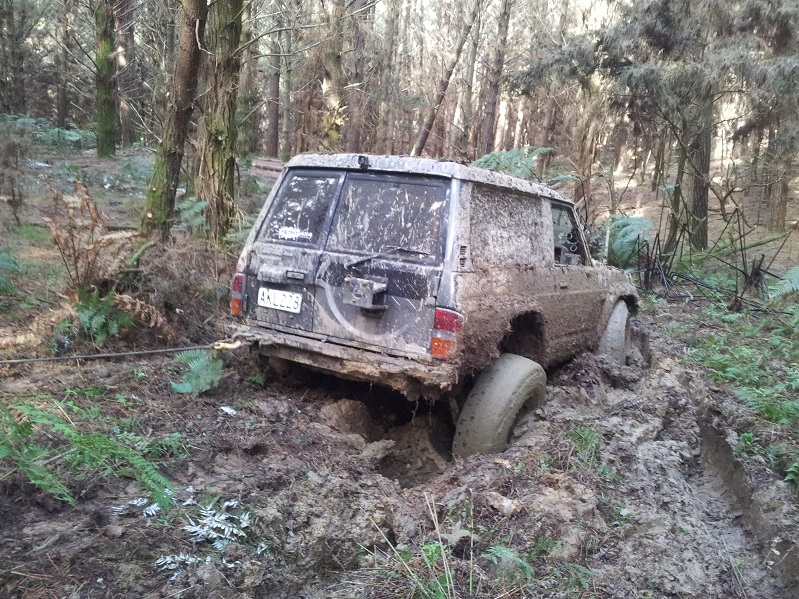

Well, I suppose I should give an update...
Ive been out wheeling it a fair bit (never as much as wanted).
Damage List:
Wing Mirror
Hubs x 2
Glow Plug Relay
Gearbox
Alternator
Batteries x 2
Shes taken a fair beating but just wants to keep running.

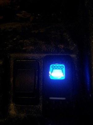

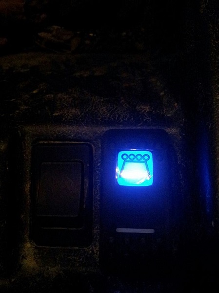

Have added some fancy switches:

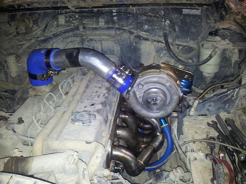

Oh and one of these appeared in the engine bay :mrgreen: :mrgreen: :twisted:
What a huge difference, am yet to give it a tune and finish the exhaust.
Am attempting to fit the PTO winch setup I bought before the weekend rolls around so fingers crossed I can tick that off the list also, the it'll be off to CP Racing to get some bar work done hopefully :mrgreen:

Nice turbo! Were did you get your switch from?

eins wrote:Nice turbo! Were did you get your switch from?
BNT sell them dude. Its a Narva Switch

looks like one of the new switchs from narva.They have a whole range aimed at 4wds now http://www.narva.com.au/products/browse/4wd

The Narva 4wd ones are only 12v so I guess they will not work the on Safari being 24V If going to buy switch like that really one the illumination to work

can fit a resistor inline with the illumination(think narva even sell them.maybe might be one of the other guys) to allow them to be used on 24v or use the led ones with a stickersheet http://www.narva.com.au/products/browse/led

eins wrote:The Narva 4wd ones are only 12v so I guess they will not work the on Safari being 24V If going to buy switch like that really one the illumination to work
http://www.ebay.com.au/itm/140815746630 ... 1423.l2649

These are 24v switches which come blank and you buy the sticker sheet separate with about 50 different designs and logos.
The difference between the switches are the illumination bulbs... 12v = Bulb, 24v = LED.
Good switches I'll definately be buying more.

rough cost of an LED switch? i want some

I think it was about $20+ for the switch and $6+ for the sticker pack.
