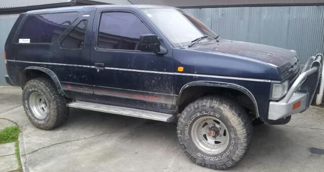

Looking at buying some 15x7 white spokes to fit my 32x11.5s so they are a lower offset so the wheels dont stick out as far, which hopefully means less strain on the cvs ect.
Do you think they will fit up alright?

Standard Terrano wheels are good for that, they have a good positive offset which would help, but how close is it to rubbing now?
Ive got some sitting here, that id be willing to swap/sell if you want them.

Will have to have a look inside the wheels, im pritty sure there is a lot of room between the inside of the tyre and the suspension. Only place it rubs is on the back of the front gaurd when turning while reversing or flexing slightly, the gaurd is slowly geting bent out of the way :lol: :oops:
What type of rims do you have Dirtydog? The rims on my truck are a very nice 3 peice wheel id love to keep them but i just dont think they are doing the truck any favours

Factory 15x7 Lego alloys are super light, but won't fit 11.5 wide unfortunately... you'll get frame rub all around.
Your theory about putting less sideways strain on wheel bearings, hubs etc is sound, but you may find that this is offset by the fact that your tyres are heavy and wide anyway.
The wider the tyre, the more leverage and weight, the quicker the wear on balljoints, control arm bushes, tie rods, everything really. Its the height you want = more clearance.
Check out Sibainmuds setup, tall and skinny super aggressive tyres on light rims. I think he's only done one inner CV in 4 years or so.

Hmmm bugger so the 11.5s wont go with a 7" wide rim, is that because they will baloon out to much?

Only 6" wide tho, a 31x10.5r15 is getting pretty big on them. Do fit on and not rub without a lift tho (just)

Could i run 15x7s with 33x11.5s with a body lift, would this be ok or am i just going to run into issues, because the only decent 33 i can find in a 10.5 are the BFGs, seems most other makes the smallest 33 they make are 11.5s?

you could always go to a 16" rim and get 235/85-16 tyres
about 32" tall and is a nice skinny tyre so easier on the steering

terrano wrote:Could i run 15x7s with 33x11.5s with a body lift, would this be ok or am i just going to run into issues, because the only decent 33 i can find in a 10.5 are the BFGs, seems most other makes the smallest 33 they make are 11.5s?
I have 33's with big rims and I am seriously thinking of downgrading to 31's when they wear out as the guard rub is pissing me off. I have a B/L, S/L and front guards trimmed and still they rub.
Sure the truck looks great with the big feet but I do not think it is worth the hassle.

Cheers for the opinion, i think i am starting to agree, I think i will be going for a skinny tyre with a bit of height, just a shame not many manufactures are available in those sizes
Also what width are your 33s and rim size?
