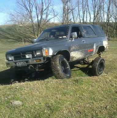

A wee update
On advice he has swopped the brake booster and master out for a double diaphram one from a late model KZN surf... big improvement in braking
Had an issue with local engine builder not happy with me shortening the rear drive shaft apparantly 0.14mm of run out is too much to balance :shock: last time I deal or recomend Qualities... force Nobber to pay them to cut and re weld it $150 for an hrs work :roll:
Made up a front drive shaft :lol: this thing is over kill 300hp PTO shaft and 6mm thick tube from an old CF Bedford axle (only thing I had in stock that could match the dia's to sleave the outer to the UJ joint)
And the best news its pass'd its cert no problems
:lol: hey skid.... yet another one I've done :wink:

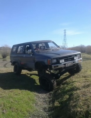

tryed 2 pt my pics up frm my fne bt there all 2 big 2 load on here nd dont hav a computer 2 try reduce thm bt hav managed 2 turn pic size dwn on my fne so wil hav 2 pt sum up once ive taken it owt 4 a decent run nd got sum new fotos realy happy with it so far :D bt havnt found ne thng big enuf 2 test flex owt so far owt of the 2 times ive taken it owt so far

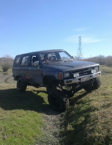

Nobber
Posts: 33
Joined: Mon May 06, 2013 9:44 pm
Re: De Ranged Nobber truck
Post by Nobber »
doesnt flex to bad :)

That's looking alright fella.
Lucky for you that Reese was on the job as well. So many guys think that having a decent RTI is all about how far you can get up a ramp.
The trick is to get the front moving in unison with the back. This keeps the body sitting level(ish) and counteracts a lot of the COG problems that people have.
