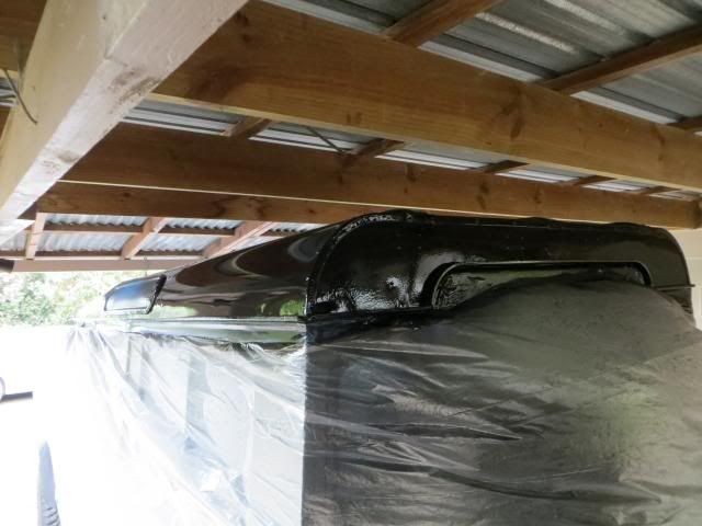

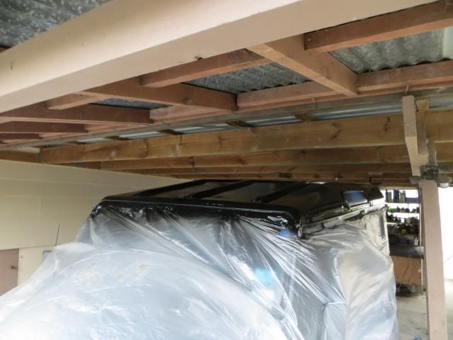

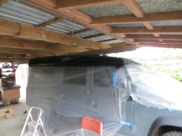

I had some time to kill on Saturday, so took it upon myself to re-colour the roof. It was either black or white. I had black in the shed
See how hot it gets in the summer, can always spray it white again

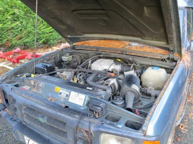

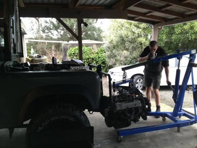

Mission on today, up at Land Rover Spares at 8am to lay claim to this:
Its a running 3.9, one of the early ones with the V belts.

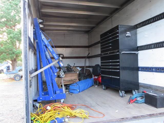

We pinched the truck from work and turned it into our mobile work shop

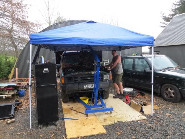

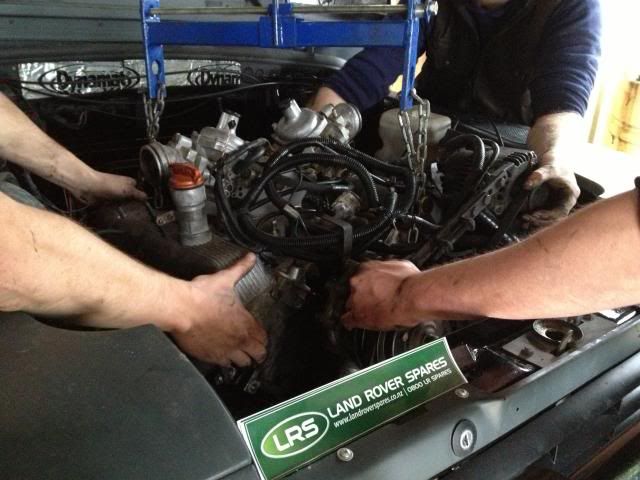

A few hours and some very tricky to get at bell housing bolts later, it was out:

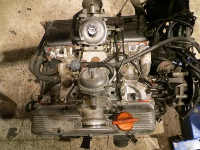

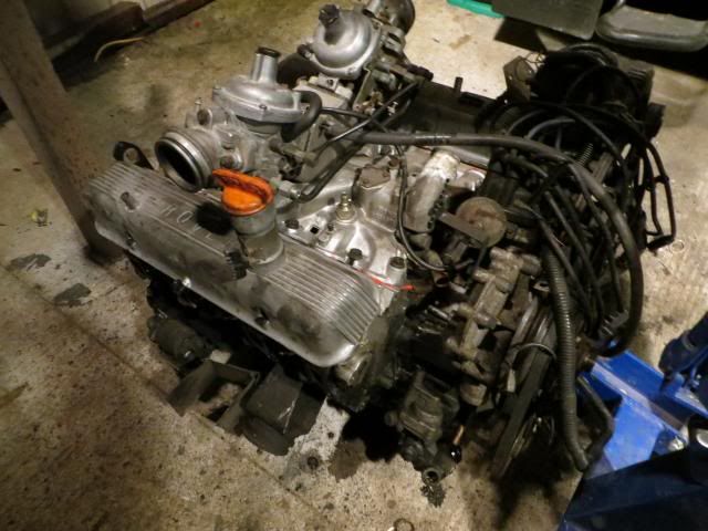

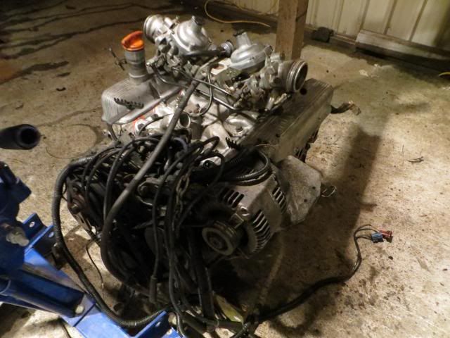

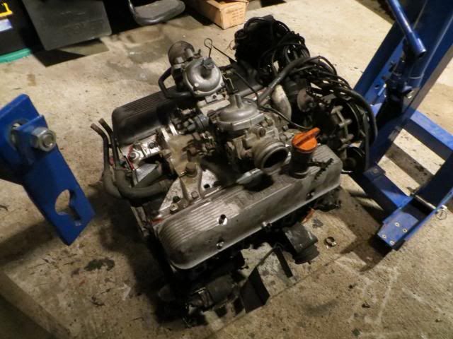

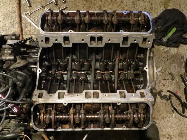

Once home, we stripped the top end down ready to receive the carbs. In reasonable shape in there, a bit of carbon deposit coating things, cam wear looks minimal which is what can let these motors down if the servicing is not done apparently.
So we bunged the carbs on, and while i was scrounging through the pallet of stuff that is the remains of the lunched original 3.5, I found the rocker covers. They look way cooler than the 3.9 covers, so on they went.
3.9 in disguise
We were all keen to bung it in the hole, but a leaking plug and this adapter thing on the end of the crank stopped us fitting up the fly wheel. Grrrrr.
Getting closer, maybe next weekend we might get another day on it
3.9 in disguise

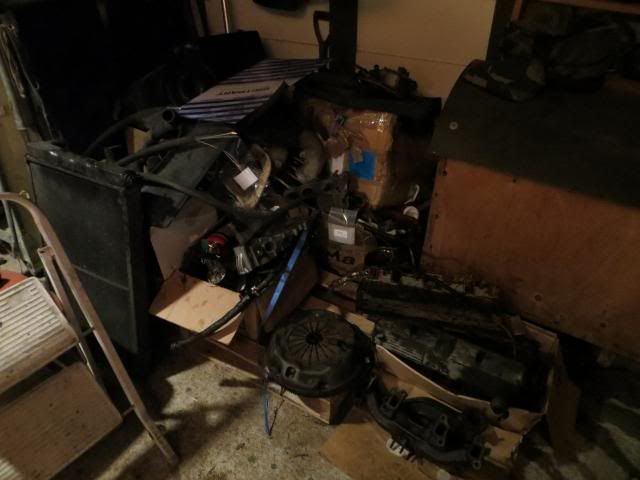

I thought a quick pick of Daves accumulated pile of engine junk would be a good way to kick things off
Its a pallet load!!

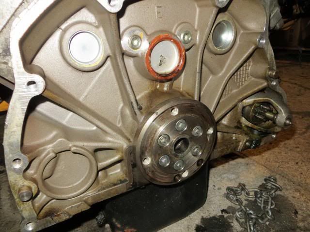

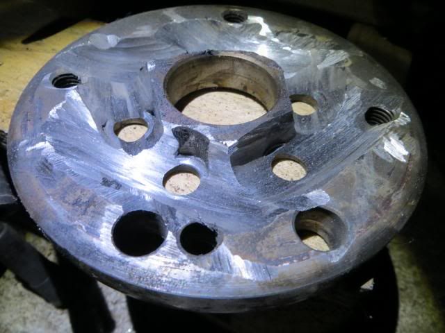

First mission was to remove the flex-plate adapter from the crank shaft so we could fit the flywheel. This is the little plate here, just undo the 6 cap screws and it pops off.
Oh no it doesn't.
Yup, after stripping the hex out of the them all with the rattle gun, attempting to drill the heads off, i ended up spending an hour with the grinder tickling em out. I didn't touch the crank with the grinder either. Fawking amazing

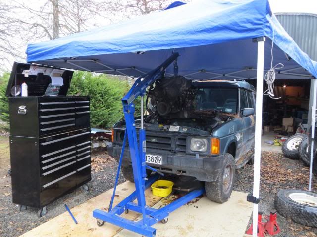

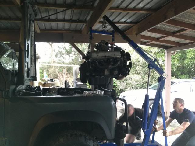

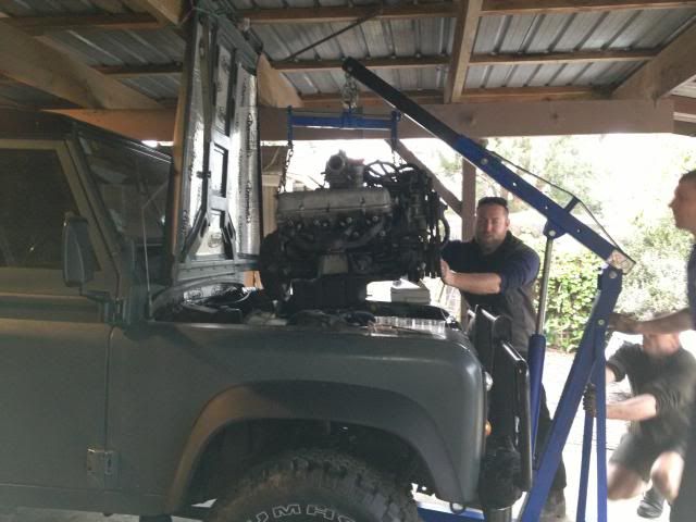

Dave swapped on the fly wheel and clutch, we cleaned up the input shaft, hunted round for ages and finally found the release bearing retainer hiding in the bottom of the bell housing, and then hoisted it in.
No time for a coffee break Dave!!!
Yup, its gonna hit the roof.
Few hands and some maneuvering
Bit of a wiggle

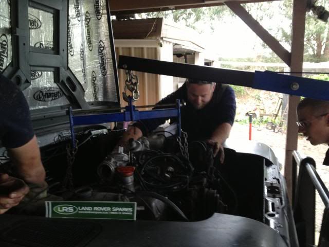

More wiggling, and its in!!!!
The hole is finally filled!!!
So now we gotta plum it all in.

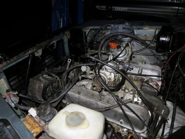

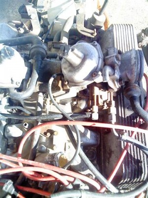

Anyone running the strombergs got a photo of their engine bay?? I have done a google image search with out much luck. In fact haven't even managed to find a work shop manual online for the Land Rover 110. That would be even better
Bit of a wiggle

what do you need to know? Are you planning on rejetting the Cd175 strommys for the 3.9? often they are lean enough for the 3.5
Re: 4x4Amb's Land Rover 110
nakimud wrote:what do you need to know? Are you planning on rejetting the Cd175 strommys for the 3.9? often they are lean enough for the 3.5

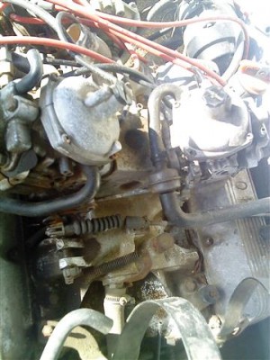

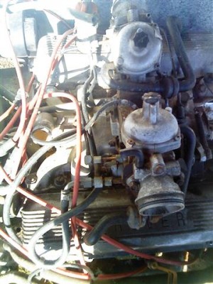

Just a pic looking down on the engine would do it, we have a box of hoses, and we don't know what we do and don't have. Some of its obvious like fuel lines and the vent hoses, but how the crank breathers are routed, and other misc vacum hoses, diff lock vacum hose etc are not. Just need a pic for referencing and it would all fall into place quickly.
Fill us in on the jetting, we are all ears. The carbs are going to get an overhaul at some point soon so new jets could swapped in during the overhaul.

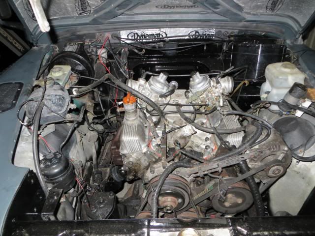

Hope they are some help, just ask if you can't make out much, just took them as I was passing by the shed, is my 3.5 that I pulled out of my 110. well over 200K genuine and still ran bloody well,(ok timing chain and cam getting a bit buggered) The previous owner ALWAYS changed the oil at 5000k intervals and I reckon if you look after a rover it will look after you, especially the 3.5. As for the CD175's 3.5 on a 3.9 if yours are later model ones like mine they aren't adjustable(early ones used a special tool though the dashpot to raise/lower needle to change mixture throughout rpm range) sooo either it will have to be modified to take SU needles or find a great carb specialist who can modify the needle. They are a bloody simple carb and great once they are set up, flow sucks, but still be ok for a 3.9. I would just hate you to melt a valve stem or piston by leaning it out. I guess you could try it first and pull plugs to observe colour
Diff lock vaccum hose was behind the carbs(rear end) down on the manifold
