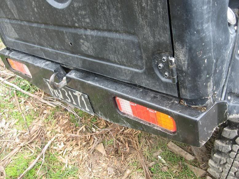

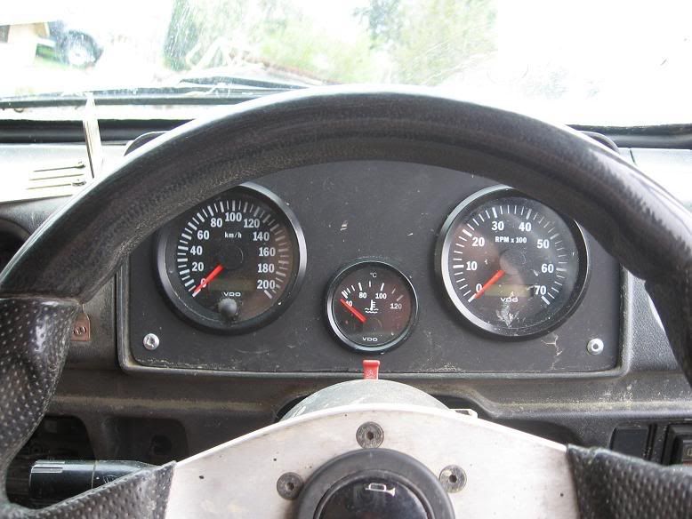

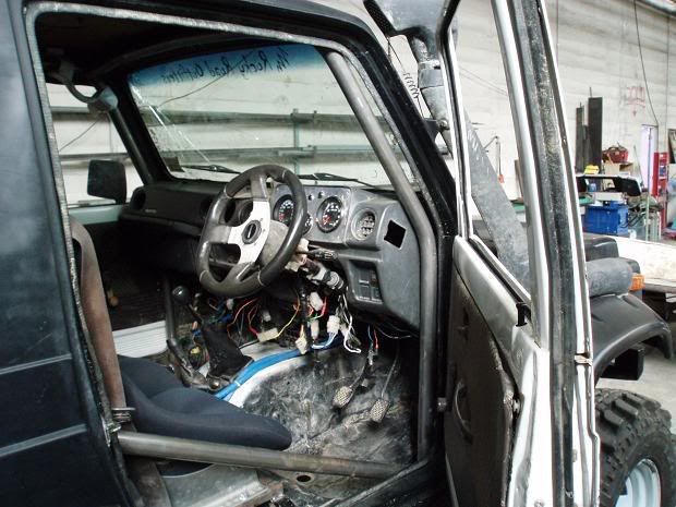

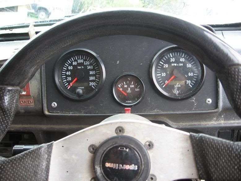

the rear bar is near done (needs the tow hook)
put in the dash and fitted the new VDO gauges only
temp is working right now still have to wire up the speedo
and rev gauges.

i will get same pics soon of the dash and rear bar

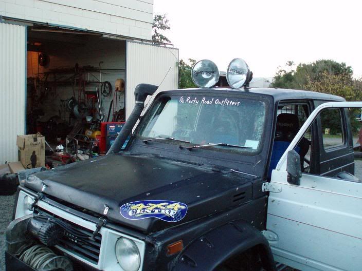

yep it was at Newport's. Still is should be done wednesday (rear bar)
thay have also done the front bar , side bars
and welded in the coil kit and welded the engnie mounts.

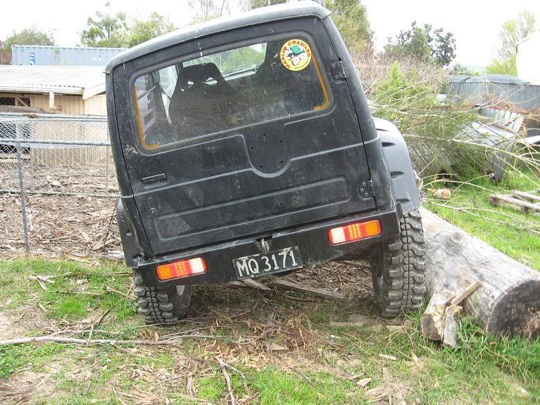

pic of rear bar and leds
pics of gauges and dash

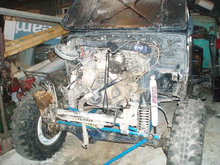

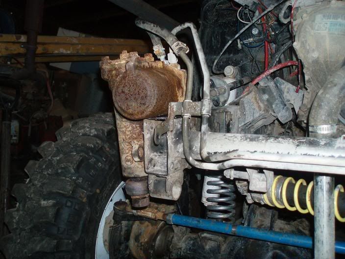

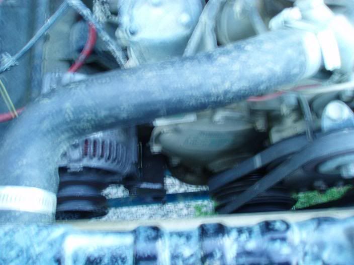

got the power steer box and found the pump and mount
but still need to find were i put the pullyes.
I had to take the frount clip off again and cleaned
up the front of the chassis to mount the box
also using a Daihatsu pit man arm as is a lot flatter

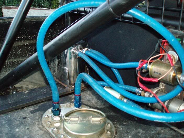

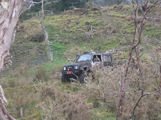

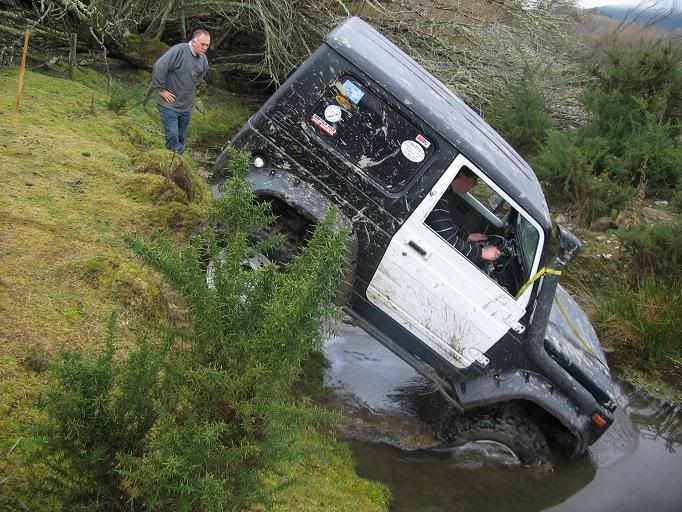

took the suzi up to the nelson club mag and turbo fun day
with power steering and fuel cell working
got the power steer pull and idler off trade me for $90
did not win but got fasted time in time trial and a lot of
air time
also lots of mud to play in as well

both the flares and the adjustable Proportioning valve came from rocky road outfitters
but you can get adjustable Proportioning valves from a few places in NZ
the flares are two rear sets of Jeep Wrangler in which RRO and trailtough have a deal
with Bushwacker so they can sell it as the one set.
the Radiator fitted fine with the std steering box just had to make a complete new mount on passengers side
and modified the drives side mount
i ran the std fan on the engine as well.

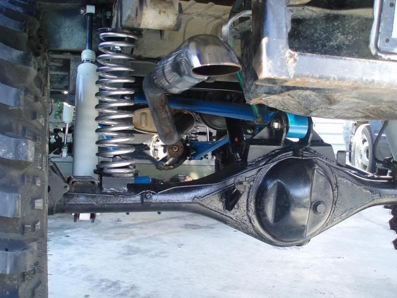

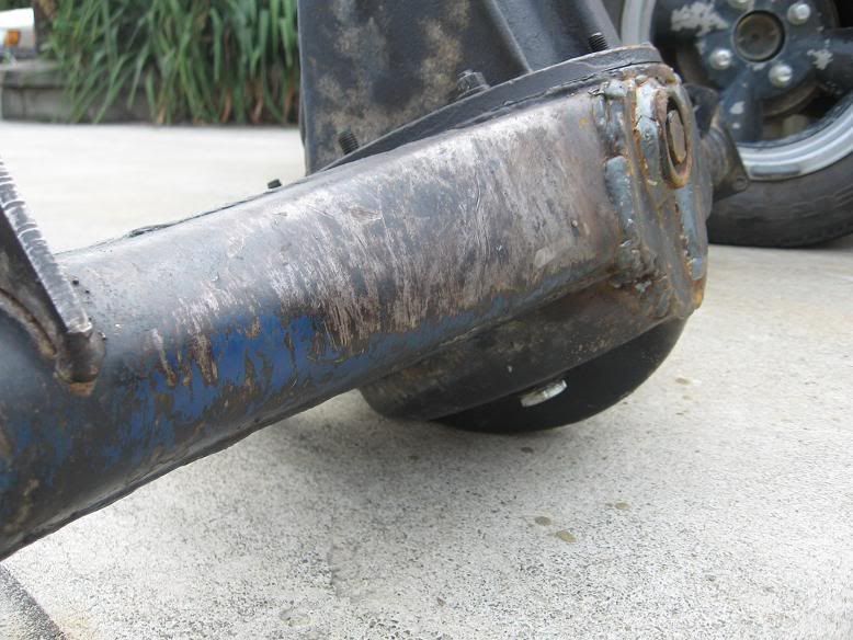

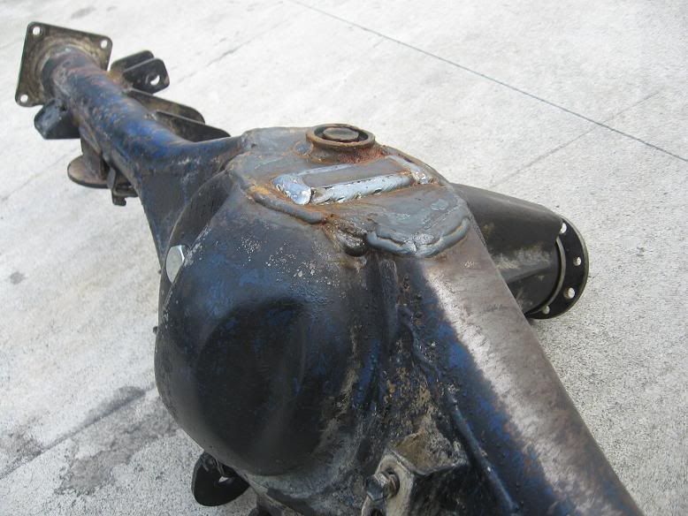

little more been done

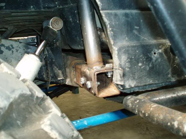

got some trans tunnel boots made
the rear drive shaft balanced
go the indicator lights working

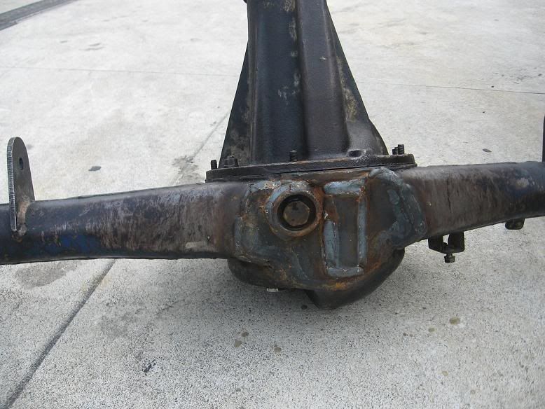

also shaved the bottom of the rear diff
and moved the diff spring mounts as was originally done for a normal drive shaft as was centered toy diff with suzi t-case
now has the toy t-case ect with double cardon drive shaft
still saving up to get the cage
with the diff i got +/- 15mm extra clearances so the same as a 30mm taller tire

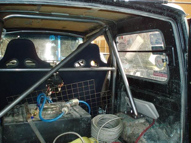

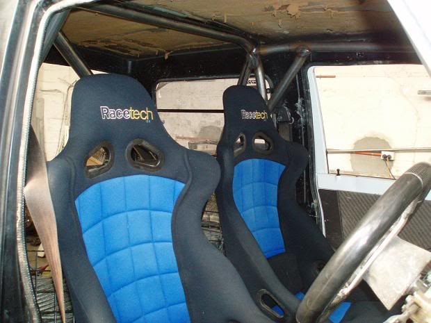

Entered the top the the south winch challenge so
at the moment we took the suzi around at altrax to get a 6 point cage
and bucket seats should be done by next week.

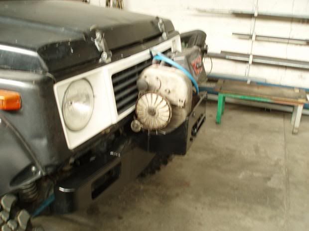

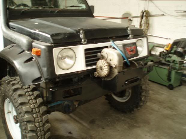

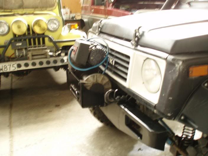

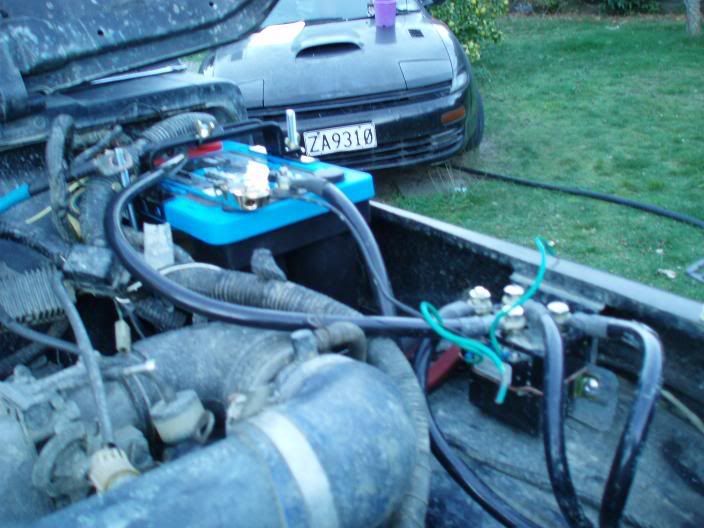

Also got a 8274 warn hi top winch and a 6hp warn xp winch motor
and 45 meters of 9mm Dynex Dux 75 Overbraid winch rope
pics to came when i get it back

toysuzi wrote:First off i put a hole in the side of one of the shocks so i got
rancho rs9000 but the body of the shock was a lot bigger
a little bit cutting had the new shocks are fitted

finally got same pics of the cage as well as the winch that has just been fitted
main hoop chassis mount
front winch/bar
front winch/bar

fist fitted a integrated Solenoid Pack
a pair of light force spot lights
also we fitted a 2nd alternator and 2nd battery as when testing we run out of battery power when winching
up a step hill
the alternator is a 117 amp jeep alt and we fitted a internal regulator out of a toyota surf kzn130
up a step hill

Can you describe the fuel system a little for me please? Is that a fuel cell or have you modified the existing tank? I am considering (way in the future) a fuel cell in the back of the vitara to get some clearance in the rear.
Heath
Heath
Re: toysuzi
mainly my problem was that the fuel cell is not set up for the efi (the one i got)
so i have a carby pump to fill the surge tank (to 1st of 3 fittings on top)
a line from the surge tank to the efi pump (bottom fitting)
return from engine to surge tank (to 2nd of 3 fittings on top)
and a return form surge tank to fuel cell (to 3rd of 3 fittings on top)
hope it helps
hope it helps
