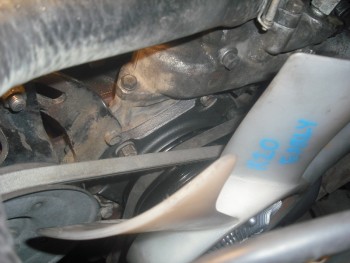

:lol: pretty sure the fans on backwards

BDR3M wrote::lol: pretty sure the fans on backwards
I agree....

I only just saw this thread and the first pic of the fan I thought that bad boy's on the wrong way round!

pain in the ass if i cant squeeze a socket n ratchet in there its rad out ....again! plus side i know the cooling system in this thing is a1 lol wish me luck flipping it at smoko

Turning the fan around won't change the direction of flow it will just be a bit more efficient and suck a bit more air, not sure that it will have much effect at normal road speeds, but you never know until you try, process of elimination.

That test would only work if you were reversing the rotation of the fan, Putting it on backwards will not effect the way the air moves just the efficency. Fix the fan as simion said( reminds me of my childhood) and put water wetter in it and your troubles will be gone.

rad out again must have gone through 10l of coolant during this process, yep better try everything, im hoping the extra air flow will solve it with the fan how it was im guessing the air was already hot from the transcooler and condencer.
