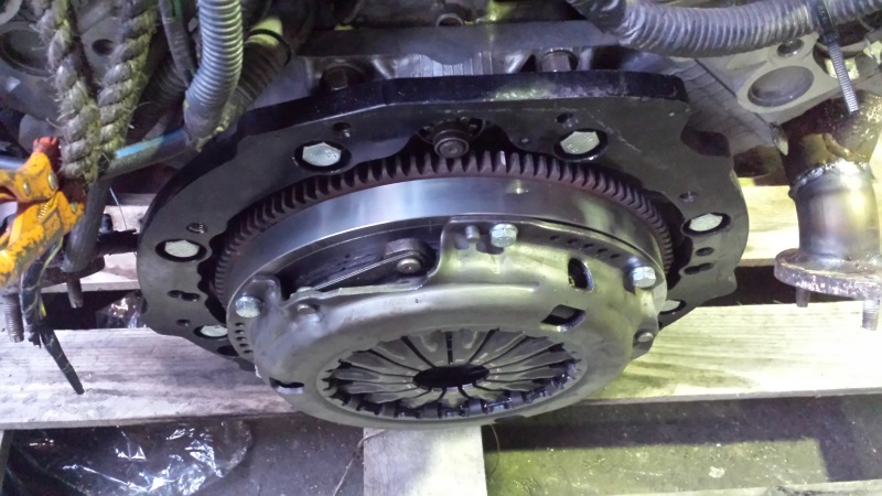

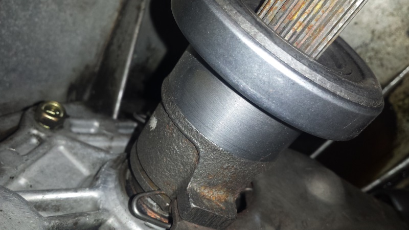

Some work from this week - it turns out the 3SGTE flywheel wont quite be suitable. So John the engineer is machining up a custom steel flywheel, which is looking awesome.
Also have an adaptor made up for the thrust bearing to extend it closer towards the clutch pressure plate fingers for proper clutch feel and action...we hope!!
Flywheel on lathe
Flywheel on lathe
Adaptor
Adaptor

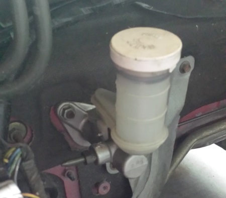

Finished off most of the clutch pedal and master cylinder install tonight. Looks good with 3 pedals and not two.
I sourced a manual brake and clutch pedal assembly from aussie and it bolted straight in.

My new flywheel is installed and ready to rock, its wider, stronger and heavier than the toyota stock 3sgte one it replaces.
Next image is the master cylinder for the clutch installed and ready to do its thing.

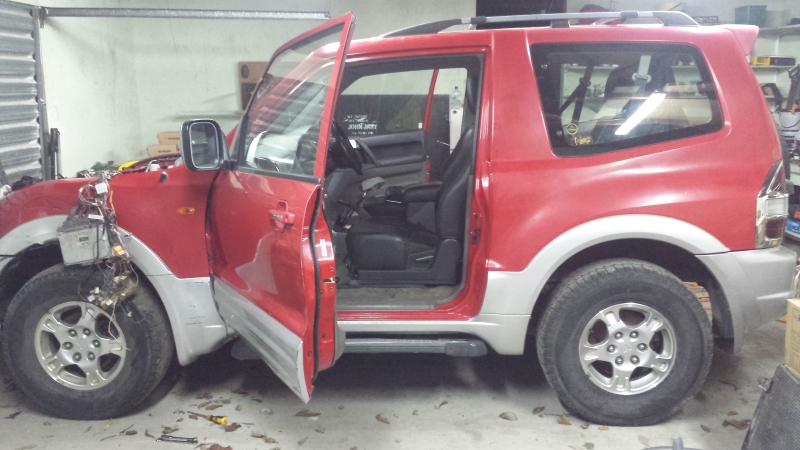

My Megasquirt has arrived and the engine, gearbox and all the running gear is installed in place for use now.
Next will be wiring in the ECU, fuel pump install and then taking it for cert and re-vinning, then the plan is for:

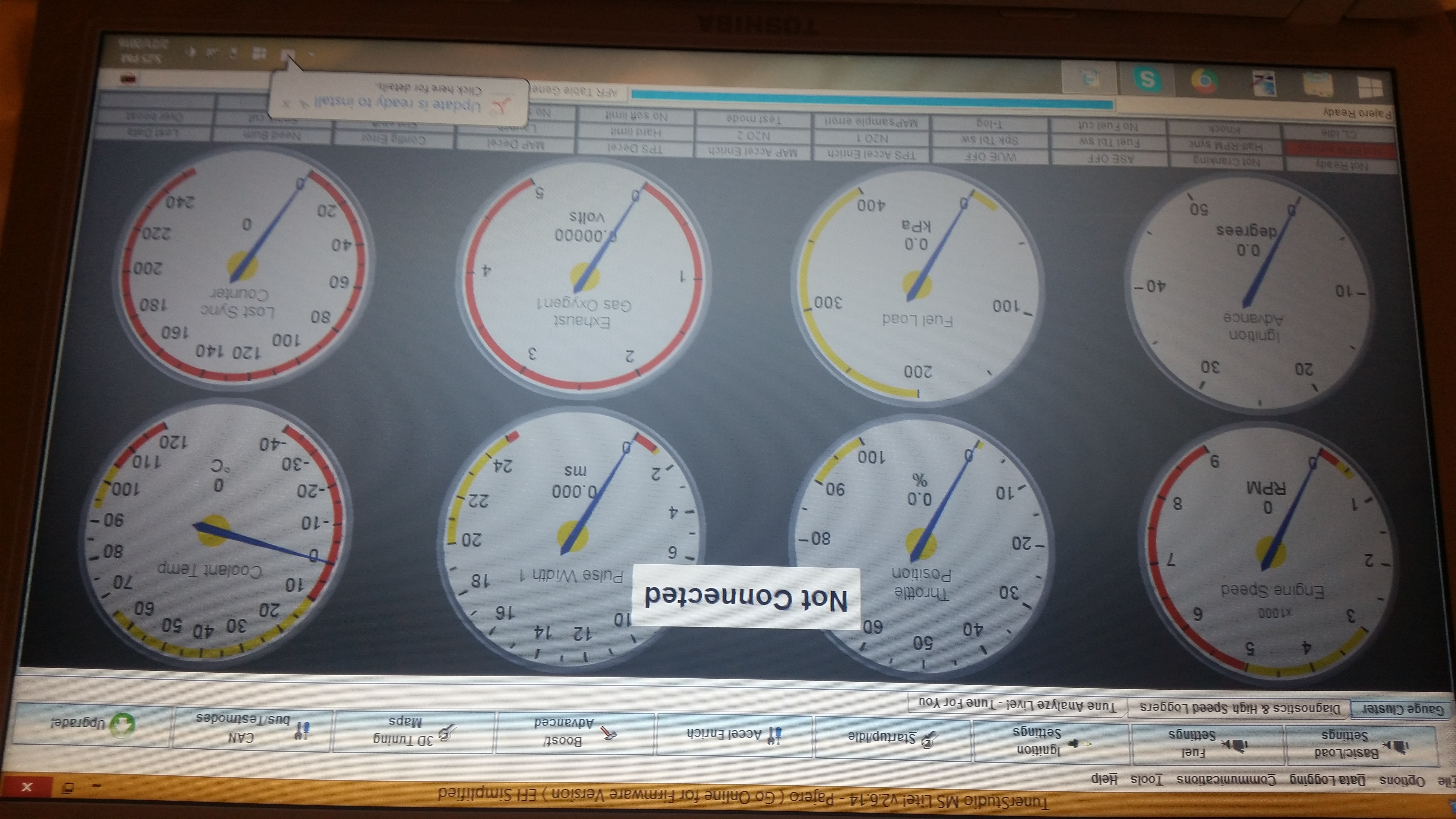

Ecu wired up and power on.
Opened up TunerStudioMS to start setting up parameters and the ecu already has a 1UZ base tune loaded.

there ya go :wink: weird why it upside down.. :lol:

Big wrote:Image
Yeah! But when clicked on, it loads right way up....odd!!
