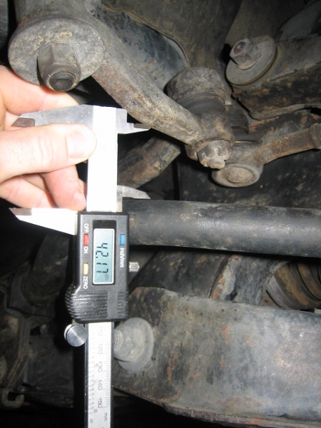

Crash can you put up a photo of your steering/swaybar setup

will do tomorrow arvo, it's at parked in the workshop where i work for the night.

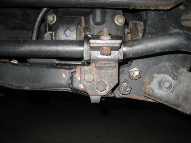

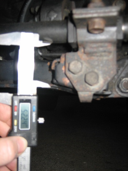

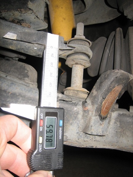

Here's some of the 95 widebody Terrano swaybar setup.
Not great photos, actual measurements a bit more accurate (give or take a mm) than the photos may indicate!

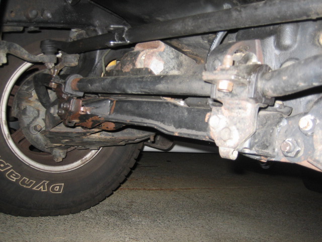

this is 98 nissan mistral with 2 inch lift.
I kid you not that sway bar is as thick as the front axles.
And even after the lift the distance between the sway bar and the tie rod is just over 100 mm
The picture below shows how low the sway bar is mounted compared to the chassi rail
please ignore the mud still packed in the diff mount from last years desert defenders trip

Also to note is after looking at the pictures of the WD21 above i suspect my front diff sits lower under the engine too.

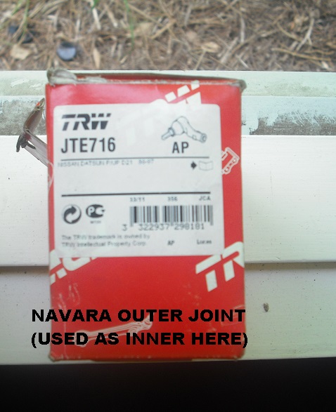

Here is the TRW part number for the 2wd Navara outer tie rod (used as inner here). I think I am going to add a grease zerk to the cover plate on my ones.
Hamboy yours is set aside

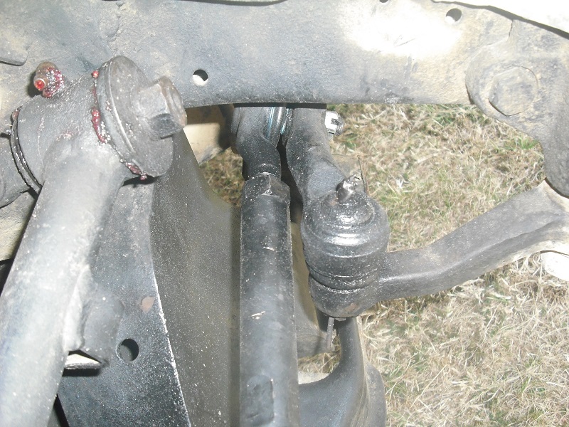

I dont see why not... this picture is the standard 2wd steering setup with sway bar on DEATH_INCs truck
The only potential contact point is the outer tie rod and the dimensions of that are not changed. This mod deletes the curved inner joint.

lax2wig, has anyone installed the new adjusters yet? Think I got it wrong about the swaybar being a problem - On the 2WD setup, that curve is there to clear the bj ends of the centrelink isn't it? OK when the suspension arms are hanging down, but they must get real close when the suspension travels up and the tierods are parallel with the centrelink?

danielbeek wrote:lax2wig, has anyone installed the new adjusters yet? Think I got it wrong about the swaybar being a problem - On the 2WD setup, that curve is there to clear the bj ends of the centrelink isn't it? OK when the suspension arms are hanging down, but they must get real close when the suspension travels up and the tierods are parallel with the centrelink?
as previously mentioned it may pay to look at the sway bar from a mistral as it is a different shapes but same lower arms etc.
Re: 18x1.5 Left Thread Tap = HD Nissan IFS Steering Links $9
Churchurdans still running front swaybar, maybe he can 100% confirm. As mentioned the only contact point was the adjuster closest to the outer tie rod at max droop, which isn't going to happen on-road anyway.
I'm also going to pickapart to try score a swaybar, I have a quick disconnect idea.
I've now given it a good test (on an airfield), no bumpsteer or driveability problems and everything feels good. If you notice the 2wd joint is slightly offset, it actually follows the same plane of the old setup.
RE; the clearance. Yes its close but, At the closest point there is still 5-8mm clearance.

Well I scored a $13 sway bar. Christ I forgot how nice it is for on-road stuff.
Not even close to touching, and this setup has more droop travel than a standard one.
I still need to trim my lower bumpstops
Lets it stuff the tyre more easily on full compression.
That sway bar was from a 1989 V6 Terrano.

Mine pitches around a bit more since the 2wd mod but it doesn't worry me to much now
. I think its to do with the tierod being further inboard than the factory 4wd setup.

thanks a lot lax2wlg for your input. Yeah definately bump steer my sasd bighorn with 200mm lift had less haha. Good to know what bushings to start with can see tons of movement in tension ones watching mrs hit brakes driving into garage so that would probably explain why im noticing worse handling than most. I dont expect it to handle brilliantly just felt it could be improved on. I guess the factory setup hides a lot of these worn out components. Might start with tension ones build up enthusiasm to do upper control arm ones.....
