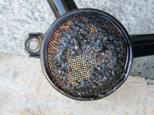

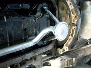

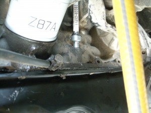

old pan off
look how clogged the old filter is
and how clean the new one is

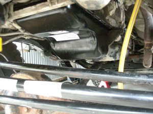

Re: 96 v6 surf
new pan on.

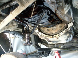

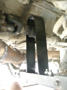

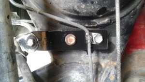

rear driveshaft hoop done. 50x5mm flat & 4x 10mm 8.8 bolts so hopefully pass cert.

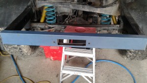

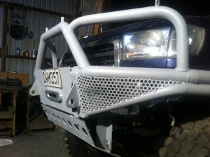

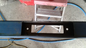

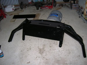

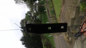

front bar made.
thanks baden.
next job bar off, paint it. next weekend swap rear diff for the prado diff & 4" lifted springs. bleed brakes. then fit (hopefully can figure it out) the TRD supercharger etc.
thanks baden.

1st coat of paint tonight.

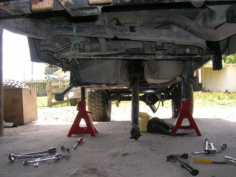

surf rear diff out.
Andrew 0272226292.
Andrew 0272226292.
Re: 96 v6 surf
and prado diff in.
put power onto locker to unlock it, jacked a wheel up and can spin one.
brakes bled, enough to get it to town anyway.
tonight's jobs are put another coat of paint onto front bar, & trim shroud because fan blades are hitting it, new viscous hub is a bit longer than the old one.

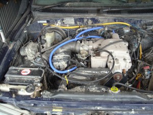

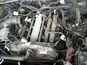

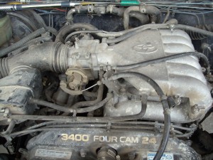

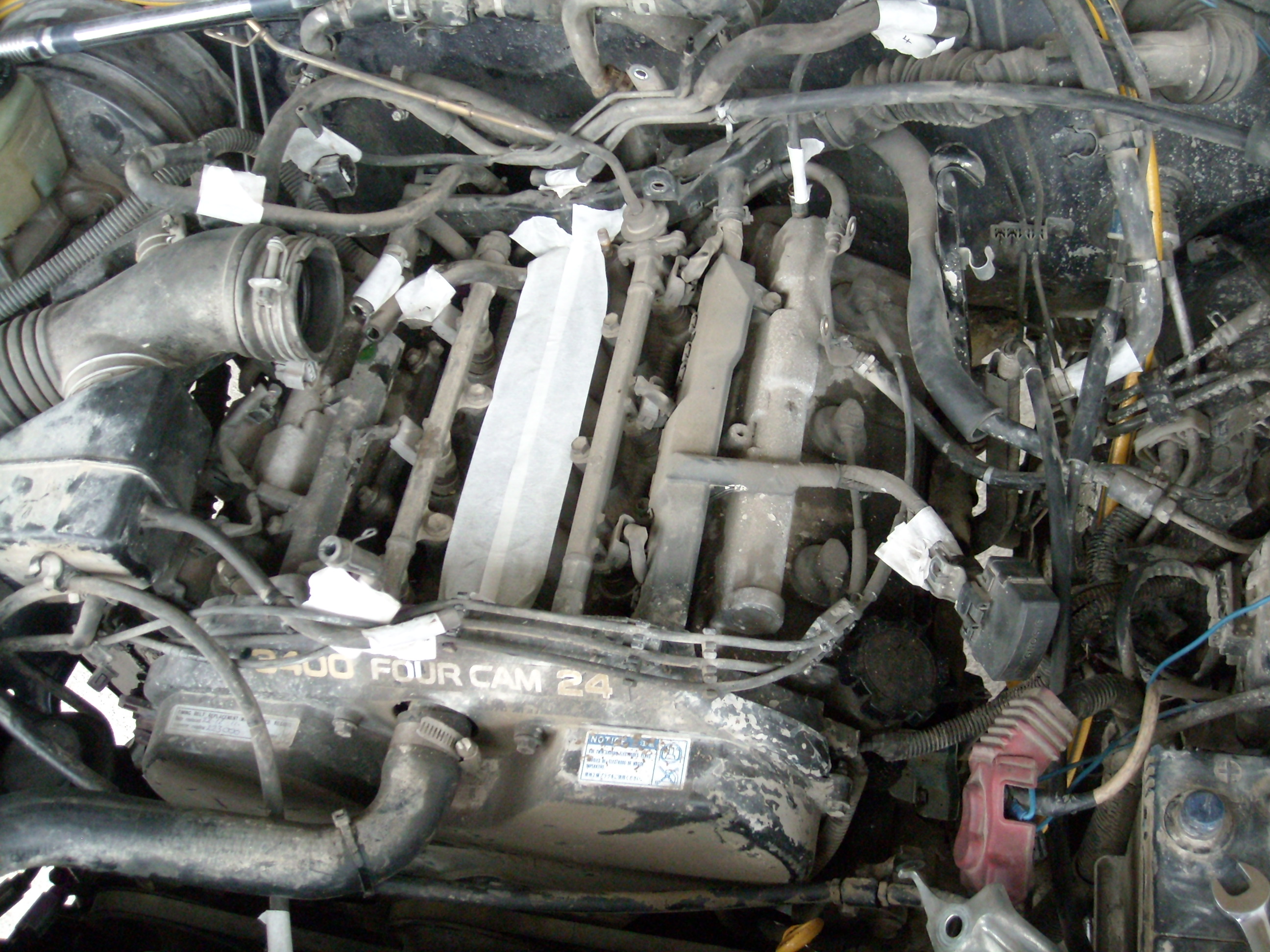

fitting the supercharger.
before
during
now just need the done photo.
still some vac hoses to hook up, and one wire left on the computer and hopefully will be going.
before
during

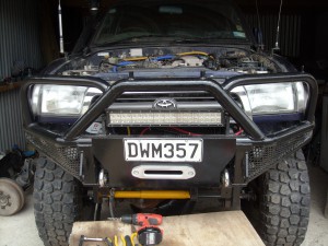

Re: 96 v6 surf
supercharger on, hoses hooked up. can't try it cos it won't start.
130 windscreen washer in, 185 one was where the steering box is now.
bar on, lights fitted apart from indicators. winch in but rope not on yet. bash plate will go on when I have made some 90 degree bends for the trans cooler hoses. still need to swap hubs to surf ones, will be a bit wider then to match rear.

That's a pretty neat fit with the supercharger with regards to manifolds etc, nice and compact
Toyhatsu Bitsalux
Re: 96 v6 surf
TRD, so just bolts into place. vacuum hoses are different lengths but otherwise straight swap.Mehrts wrote:That's a pretty neat fit with the supercharger with regards to manifolds etc, nice and compact

front hubs are done, front wheels are in about 10mm each side compared to rear, so will get a fresh bite on side of rut.
photos to come....
is now running, ended up being a plug unplugged behind dash

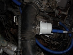

removed intake silencers, americans reckon a gain of 5-7RWHP so must do something,
and supposed to sound gruntier too.
hopefully let the supercharger breath a little bit easier.
removed these.
removed these.

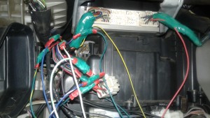

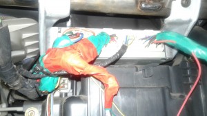

Re: 96 v6 surf
Sc computer wired
in, haven't started it yet.
Auto sparkies close eyes now....
And a bit tidier.

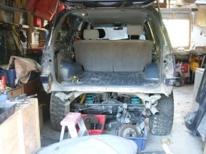

Re: 96 v6 surf

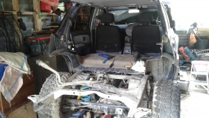

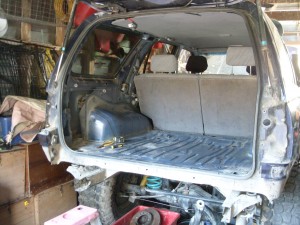

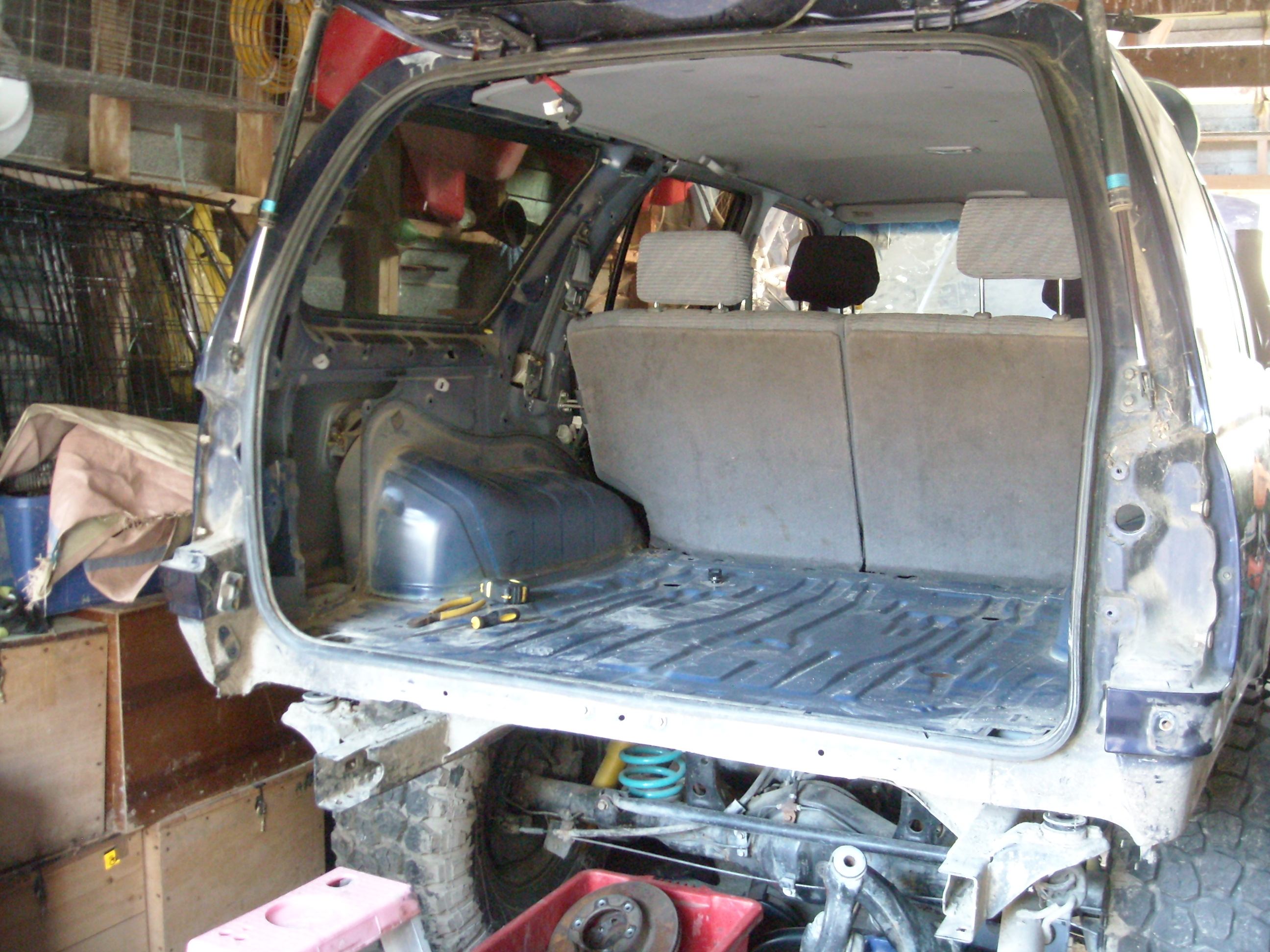

back nearly stripped out ready for cutting. roof lining to unclip and windows to take out.
seats can stay there until back is in right place then take them out.

no going back now.

Re: 96 v6 surf
Now just got to measure where it's going to fit and cut it neater. seat belts dictate where back goes.

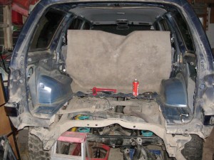

Re: 96 v6 surf
A bit done, partly bird pood in. A few gaps where not cut flush, will cut guards and pull gaps closed, won't be visible behind deck anyway.

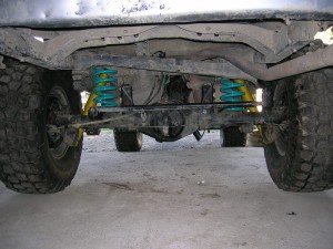

Re: 96 v6 surf
Got sick of spot welding panel steel so started on rear cross member.

I'm pretty sure that drive shaft hoop will require another piece in the middle to encapsulate the drive shaft more . If it broke and traveled the length of the u bend it would have no trouble whipping all that off
Re: 96 v6 surf
I have wondered if that would be the case, so will end up making another piece to bolt in centre closer to the driveshaft. another job added to the list.sirLachlan wrote:I'm pretty sure that drive shaft hoop will require another piece in the middle to encapsulate the drive shaft more .

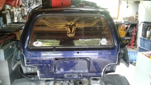

Re: 96 v6 surf

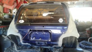

All closed in, just some bog to smooth off and paint.
quite pleased considering it's the first time i've used a mig.

Re: 96 v6 surf
awesome, been waiting for this stage. Any side on photos?
Can i assume you are retaining the rear window function of being able to be wound down, electrically?
Re: 96 v6 surf

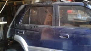

that was the plan, but would only go down to top of arches, which is about half way. also I had to cut the bottom off the runners the window slides in to fit around arches. so window now doesn't move.BlakeNZ wrote:Can i assume you are retaining the rear window function of being able to be wound down, electrically?
plus the rear radiator will either be behind window on the left, or horizontal on roof straight above rear window so be safer if window didn't open anyway.
have tried to take a sideish on photo but not much room in shed, i'll add off my phone.BlakeNZ wrote:Any side on photos?
