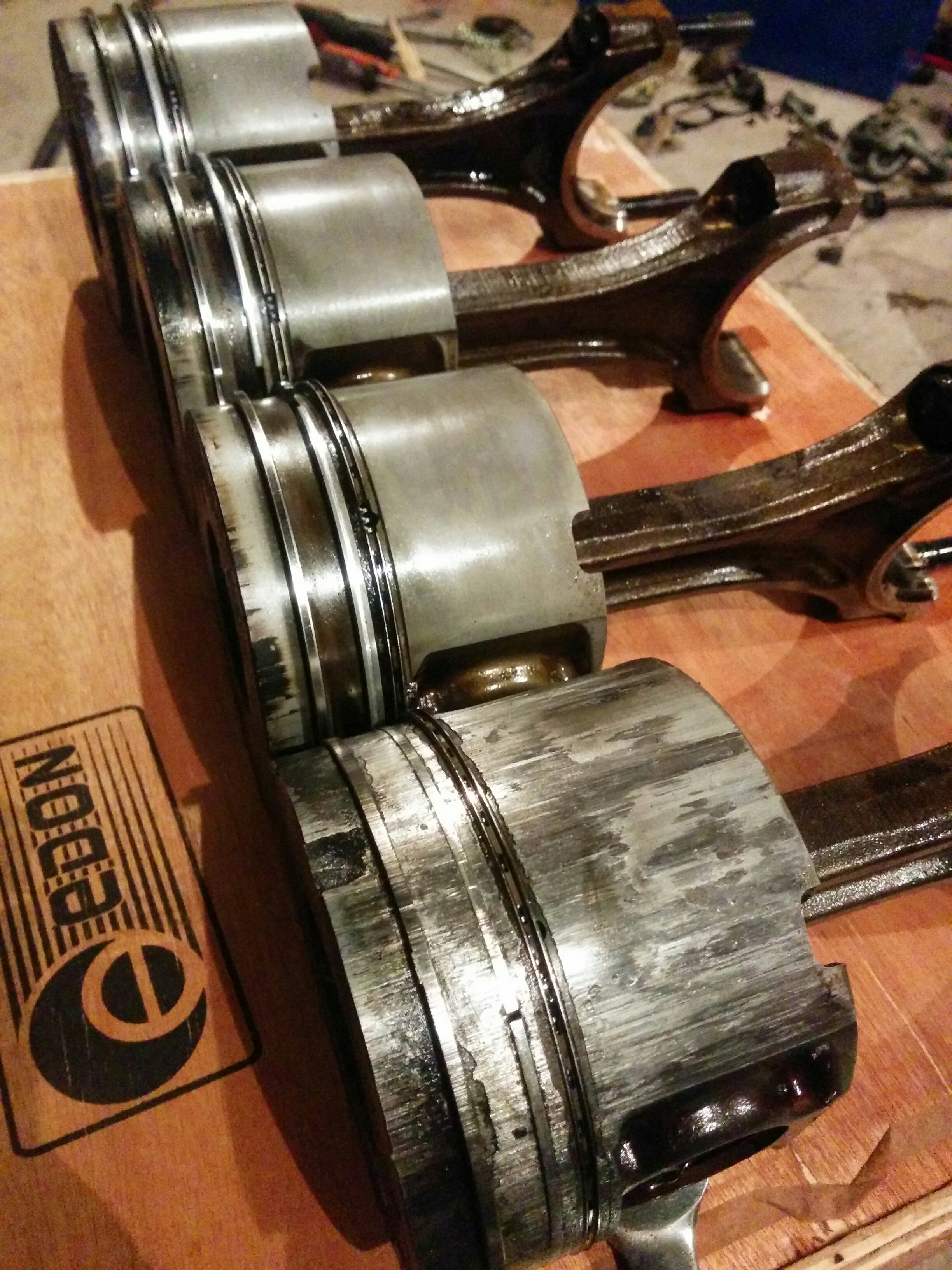

For anyone that was following this,
The correct answer was extreme piston slap!
Finally got the block dismantled and its now pretty obvious that something has caused #1 piston to flap around. Exactly what will probably remain a mystery. Did the 2nd comp ring seize first, causing the piston to bang around, or did one of the chunks break off around the crown first and get jammed down the side of the piston, or is the oil jet clogged with one of the bits of liquid gasket I've found inside??

what condition is the face of the piston like in relation to the other three.
Re: ZD30 - Name that tune!
Posted: Wed Sep 09, 2015 11:25 am
by 3VILC
Crown wise they don't really look hugely different apart from the chunks missing around the edge obviously

i wonder if no1 injector is leaking and caused piston to over heat.

That is also possible. The worst looking injector was #3 but I suppose hard to really tell without a way of spraying liquid thru them at high pressure. It would certainly seem something has caused only the one particular piston to run hot. They've all gone in the scrap bin now, that 2nd ring I couldn't even budge with a screwdriver, parts of the oil run were also stuck in the groove. That piston was also the only one that required a hammer to get the gudgeon pin out

The pistons went to the scrap metal shop in the sky without thinking to photo the tops. But this is what the combustion side of the head looks like. #1 is on the left, looking at it now it does look a bit darker and doesn't have the pale colour on the valves like the others

slide wrote:my bet is a damaged piston (and probably a scored up bore). Probably not a hole in it, maybe cracked or scored up. I doubt it'll be a damaged valve
shit damn I hate it when I'm right... :P :mrgreen:
