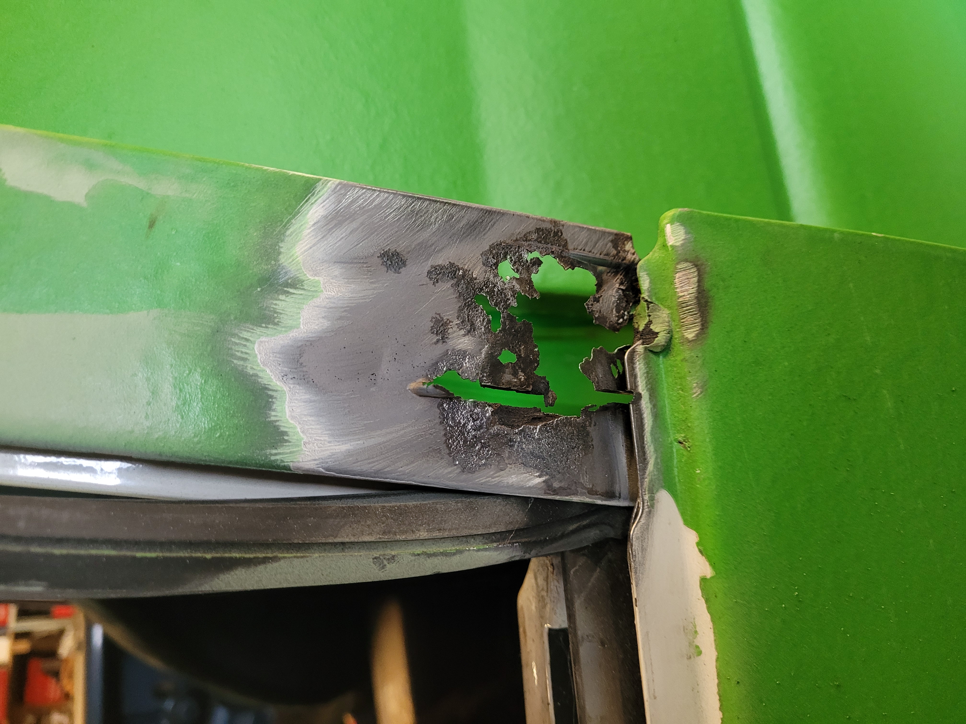

The nasty rust....
Will cut it all out and replace with new steel.

Cut out any rust and welded new plate in.

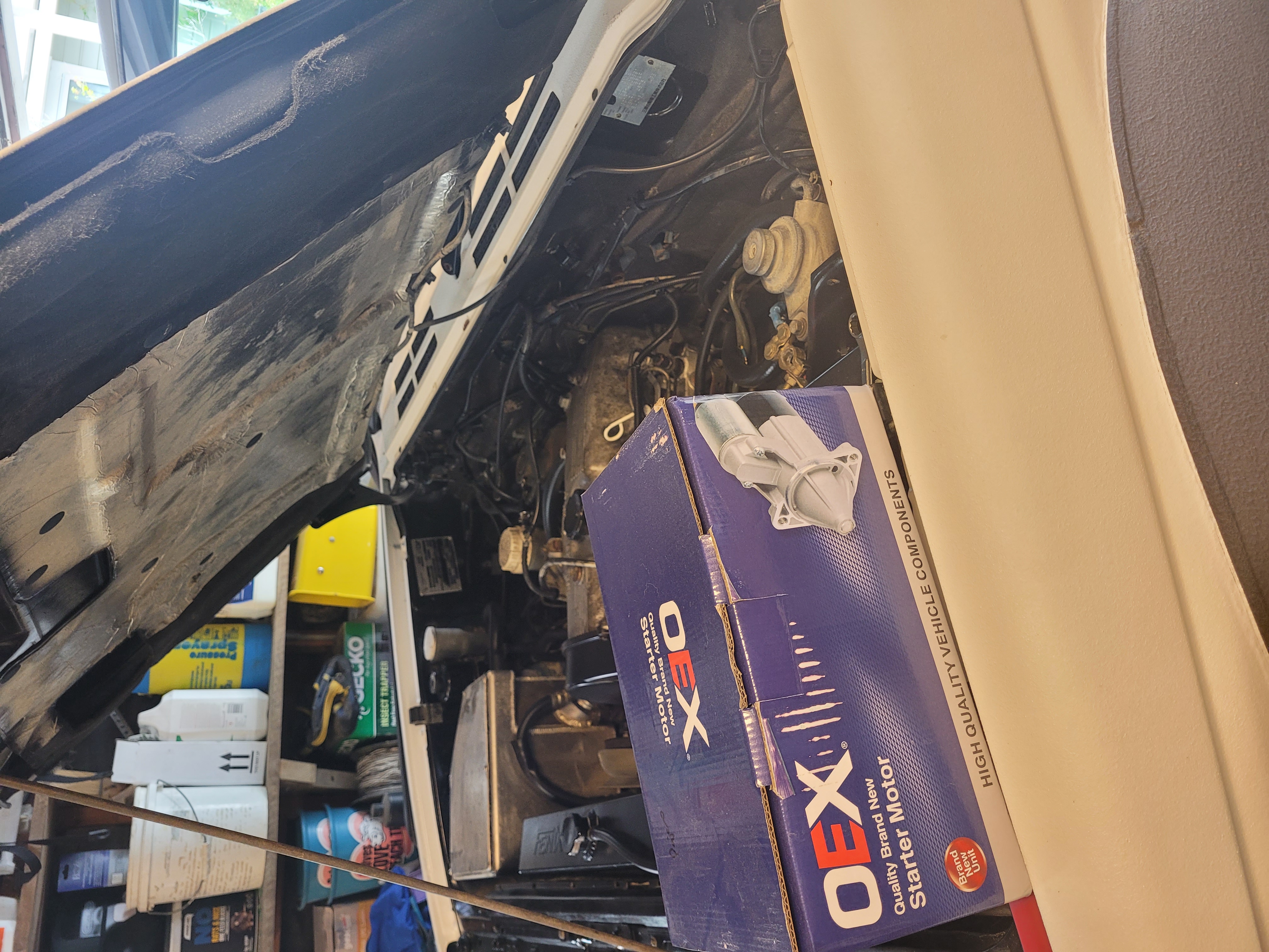

The starter motor...bought a brand new one probably 9 months ago and so finally put it in.
Originally you would have to hold the clutch in for the starter to properly engage the ring gear. But now it's immediate engagement, more power and even quieter. Cleaned up all the electrical connections with a bit of sandpaper.
Once all in, give it a coating of soft seal for the terminals and she's nice and secure.

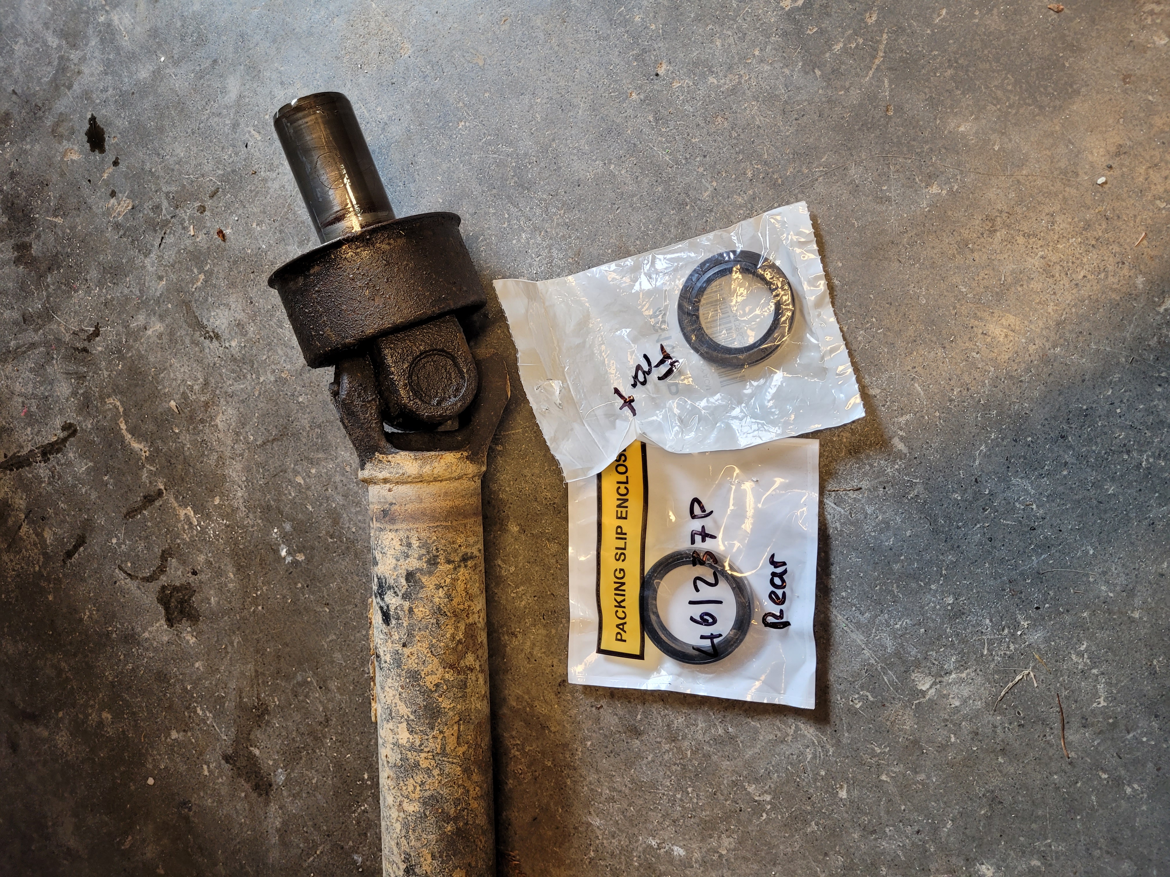

Next up was the leaking seals in the transfer case, where the driveshaft are inserted. Pretty common for them to perish over time, so both replaced and while I'm at it, fresh oil for the transfer, gearbox and diffs. The good news is that from when I changed the diff oil in Sept 2022 till now, it's still nice an clean....MAGIC!
Seals
Seals
