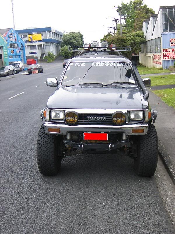

well bit more of an update,spots are all fully wired up and working well,front grills back in and looking tidy,ball joint spacers are in and suspension is set so lloks alot more even now,and my windows all work again,(had a wee accedint and cut out the control box which i mistook for the old alarm brains :oops: )but yeh all good now :D ,heres a couple pics
mates ute is lowered on 16s but yeh,and as for flew,these are before i removed the rear sway bar,which made a real difference
after seeing how its turned out i probly could have got away with just a 3" body lift but i suppose ive now got room to run some 36" simexs if i eva get them

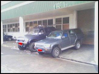

also couple pics beside my brother n laws nissan d21 and my mates surf from work

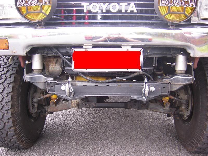

got the front plates made up for attching the snatch hooks,bloddy solid and doesnt look like itl disadvantage me much in the way of approach angles

pics above for all you pic whores,will get some more up asap including ball joint spacers chris
