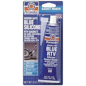

what is the blue gasket/sealer? i use 3 bond for important stuff or the red high temp stuff for general things but haven't found the bling blue stuff..
Build looks great by the way..

[quote="rangimotors"]what is the blue gasket/sealer? i use 3 bond for important stuff or the red high temp stuff for general things but haven't found the bling blue stuff..
quote]
Its not Blue Shit, tastes different. :shock:

rangimotors wrote:what is the blue gasket/sealer?
exactly that.. blue gasket sealer stuff.. :wink:
sorta like this..
