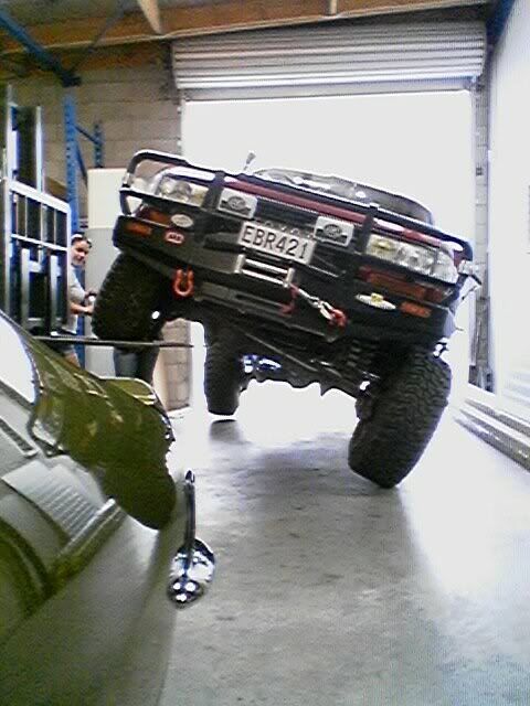

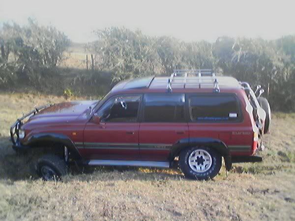

The crusier likes flexy time!... Damn that thing flexes like theres no to morrow!. Would look better if it had bigger wheels:D

Who knew Prados could fly?

Nice Flex DB :!: now how can I get this with my 71

Well, seeing as i was measuring the distance between shock mounts so i could start to track down some longer replacements, i naturally had no shocks connected and no swaybars connected so i could get maximum articulation in order to correctly size my new shocks. You can still see the shocks in the pic's, but they are disconnected at the diff.
I have never tried the radius arm bolt trick, always ment to on the safari, but never got round to it. Seeing as this is a soft roader poser truck, i don't think i will ever bother.
Besides, articulation is over rated if you have lockers :D

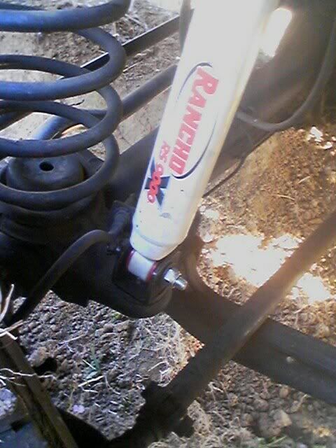

Some updated pic's with the new shocks under it: (crappy cell phone pic's)
The Eye to Pin adaptors Ben and I made
Doesn't look like i have lost any flex even though the shocks are fractionally shorter than i needed. I don't even need to extend the bump stops either. Saying that though, i haven't flexed it on the muddies with the new shocks. Its possible the tyres may rub on the inner gaurd or flares, so they may need extending yet.

what are the extended lengths of those shocks you got on your wagon there DB?
Hilux DC stock as a rock,leaks everywhere
DieselBoy
Posts: 4568
Re: D.B's 80 Series Bus
Post by DieselBoy »
lockie wrote:what are the extended lengths of those shocks you got on your wagon there DB?
700mm extended, same shocks used front and rear.

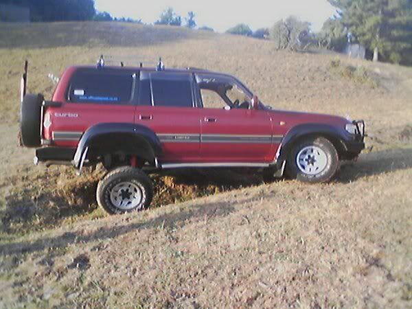

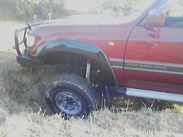

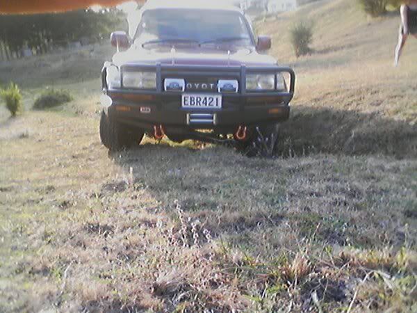

Couple more flex pic's.........
Have removed the front radius arm drop box's in favour of offset bushes. Since doing that i have had to trim some of the inside of the flares off in the front due to increased front flex:
Seems to work pretty good now 8)
