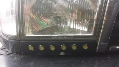

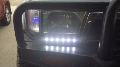

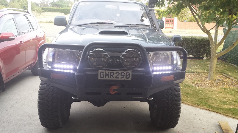

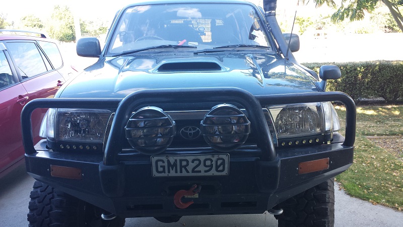

and LED driving lights
smurf182
Posts: 590
Re: VVILLY TONKA-KZN185
Post by smurf182 »
Those LEDs on the tailgate are a mean idea, nice one
Heath
Posts: 3297
Location: Rolleston, Chch
Post by Heath »
Those lil driving lights are cool. What's the set up for those?
vvilly
Posts: 1134
Location: Rangiora
Post by vvilly »
smurf182 wrote:Those LEDs on the tailgate are a mean idea, nice one
ive wired them up to the boot light so when the boot is opened they come on
vvilly
Posts: 1134
Location: Rangiora
Post by vvilly »
Heath wrote:Those lil driving lights are cool. What's the set up for those?
they are individual two wire 12v domes with a threaded shaft on the back..
linked them all in series and wired them to my park lights
vvilly
Posts: 1134
Location: Rangiora
Post by vvilly »
it all makes my head lights look like candles...
what to do with the H4 bulbs....... what avenue have others taken
Parallel?
Do they put out much light?
vvilly
Posts: 1134
Location: Rangiora
Post by vvilly »
Mattman wrote:
Parallel?
lol yup haha.... not series
make my headlights look like candles
Just be wary of what the LEDs are lighting, obviously off road at night they will be awesome, lighting up whats immediately in front but on-road at 100km/h you don't want a lot of light in the foreground. Too much close range light and your ability to see into the distance is greatly reduced.
vvilly
Posts: 1134
Location: Rangiora
Post by vvilly »
smurf182 wrote:
Yeah talking to one of the techies at work today he said the same thing. Will look at re wiring them up differently soon
Heath
Posts: 3297
Post by Heath »
You could rig a relay so when the main lights are off the LEDs are on and when the main lights are on the LEDs are off.
Heath.
hamboy
Posts: 286
Post by hamboy »
Hook them up as daytime running lights, I had to take all my pretty lights off for a WOF :evil:
vvilly
Posts: 1134
Location: Rangiora
Post by vvilly »
Anyone got a wiring diagram for that
kiwipete
Posts: 2328
Post by kiwipete »
vvilly wrote:Anyone got a wiring diagram for that
Pin 87A is a normally closed contact and the LED's will run happily until you switch on the park lighting circuit, then the energised relay will put the 12V power across to pin 87, thus killing the supply to the LED's

A switching relay as Pete has shown would be the easiest way
vvilly
Posts: 1134
Location: Rangiora
Post by vvilly »
Thats easy cheers guys
Nicely put Pete. Just like we talked about today (See I did listen and learn something :wink: )

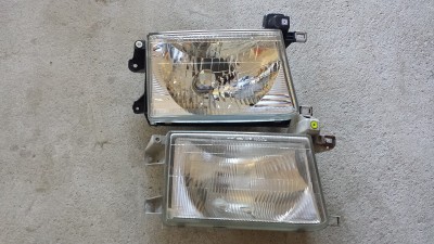

out with the old in with the new
got some h4 100/90's as well but i dont want amber lights on the front.
is there a bright Ice bulb that will work in headlights????
Post by evolution02 »
Since you've fitted the higher wattage bulbs you need to fit a relay/wiring kit to the headlights otherwise you're going to burn out your h/l switch
The relay kit will also put higher voltage to the bulbs as won't have voltage drop
You will need a Toyota specific kit as Toyota switch the headlight different
I hope your 100/90 bulbs are hella as others are poor
I have fitted those bulbs and wiring kits to heaps of vehicles. Less now as most vehicles have polycarbonate lens so can't do those

ChurchurDan
Posts: 574
Location: North Canterbury
Post by ChurchurDan »
Be careful with 100/90 bulbs as they make a lot more heat for not a lot more light. You can get HID kits for H4 lights, They will give you more light and look heaps cooler. I know they are technically not legal but 100/90 bulbs are not either.
http://www.trademe.co.nz/motors/car-par ... 071121.htm
It might be good to check your lights on a beam setter as a lot of the after market lights are made for the USA market and dip the wrong way.
vvilly
Posts: 1134
Location: Rangiora
Post by vvilly »
ChurchurDan wrote:Be careful with 100/90 bulbs as they make a lot more heat for not a lot more light. You can get HID kits for H4 lights, They will give you more light and look heaps cooler. I know they are technically not legal but 100/90 bulbs are not either.
Yeah looking into hids atm....
With the right hand drive dip. Bryan from braxton lights has tutued with these to correct them thanks.

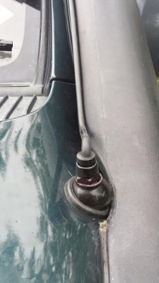

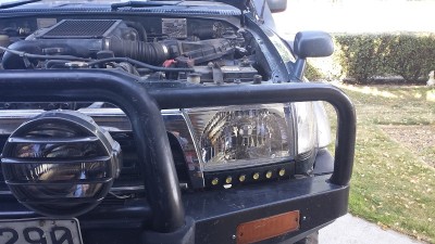

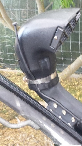

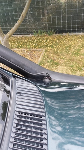

So re wired up the driving lights correctly. ordered some ice bulbs from repco they should be here Tuesday. and i also fixed my no radio reception issue.
broke two electric factory ones. brought a repco one and lost reception so made a new antenna up.
used a welding rod and some rubber hose
