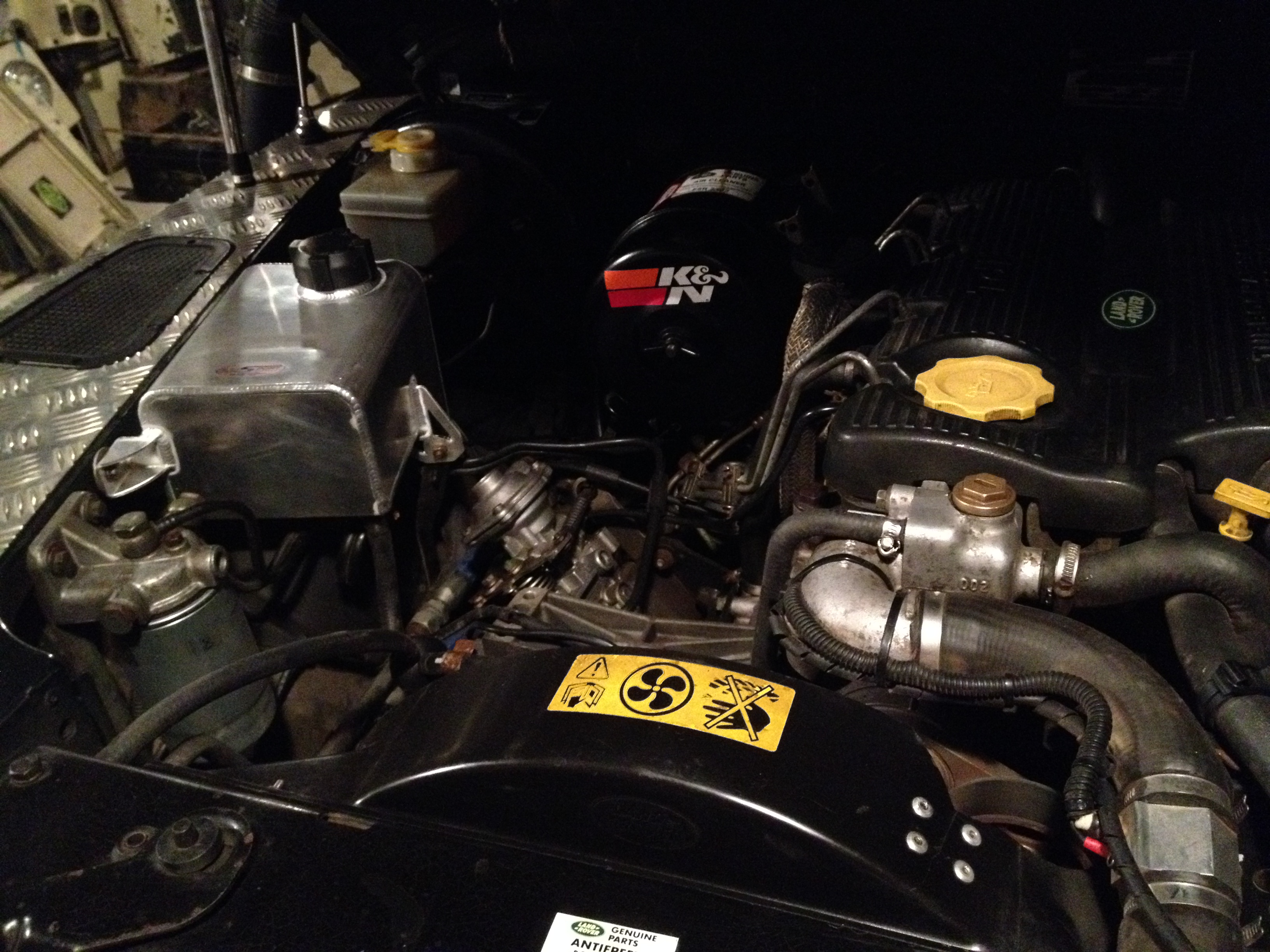

After a long wait, the alloy header tank showed up from Alli Sport in the UK 8) 8) 8)
Man its a nice piece of kit for 75 pounds!!!
Its a perfect fit, and takes the factory cap, so it retains the 15psi pressure relief valve.
Recommend this if your worried about the age of your plastic header tank :D :D :D
