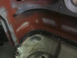

Almost done on this corner but lots of fiddly bits to sort (bloody rusty post to do yet :? )

About 95% of the way to finishing this cab back now. Some little bits to fabricate (reinforcing for bolt holes and base of cab back) and weld into place.
Will need to use a little bit of filler to smooth things out completely but I expected that anyway. At least all the rust is gone.
Fixed the rusty post too (cant see it), put in a new piece (rolled, put inside and welded into place)
