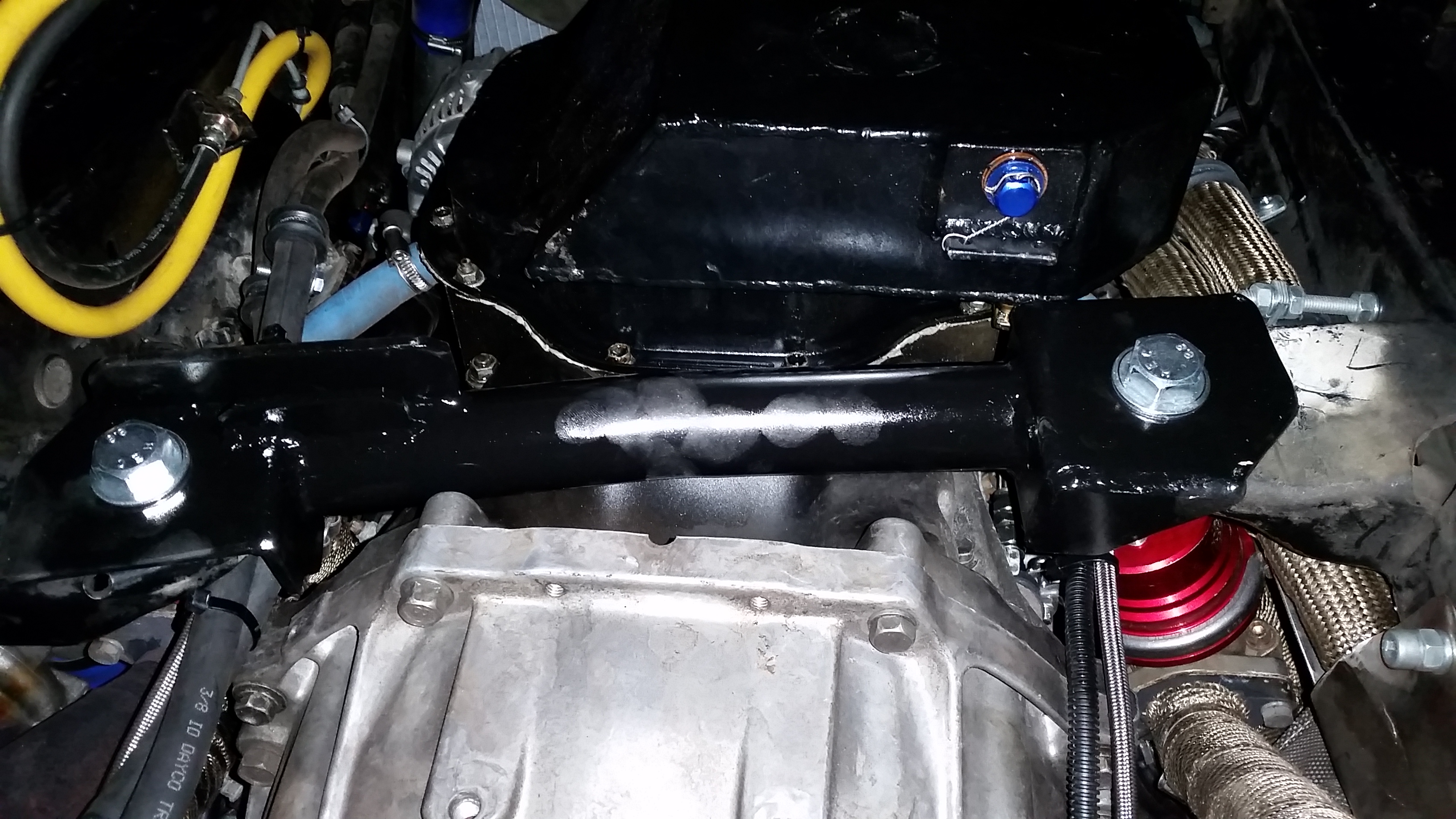

He wanted a Xtra x-member on the original ifs diff mounts, had to tuck it up flush so still have pinion clearance on full bump.

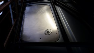

Have replaced rh window with alloy sheet for fuel filler. Thoose were the major issues anyway

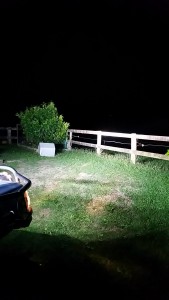

Went for a drive out to parents lastnight to test my lights/just go for a drive..a couple small issues, beadlocks definitely need a balance/balance beads something anyway.

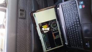

Also need to sort the boost issues out.. sometimes over boosts sometimes fuel cuts etc. Will try investigate this weekend..

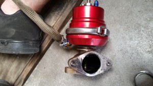

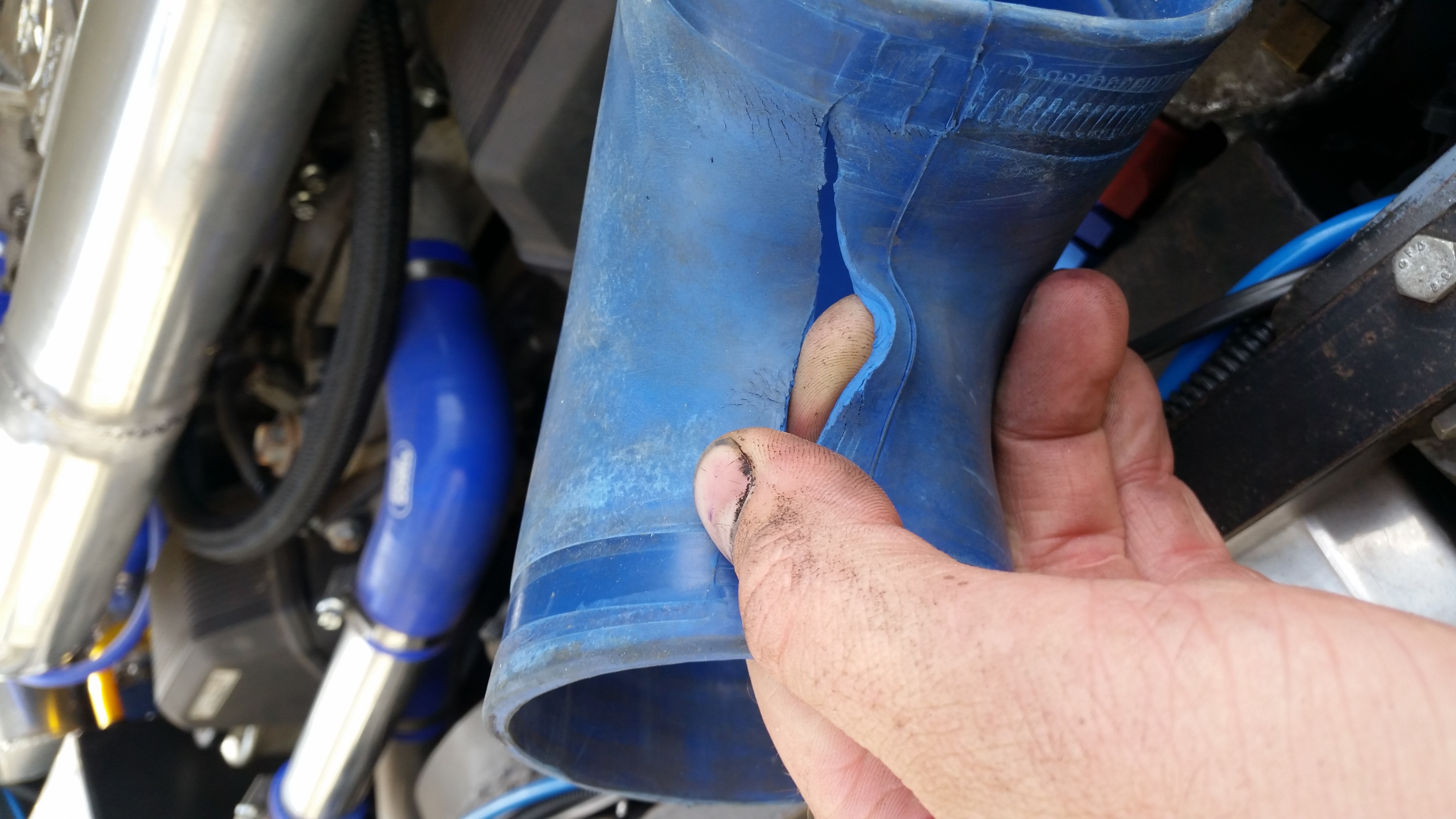

Knock off parts strike again.. didn't want to cough up for genuine wastegates at time of build (should have ) and found both wastegates have slow leak from diaphragm into the exhaust valve,but one seized in the shut position..appears to have a steel bush the plunger moves in. Looking In to genuine replacements now
fh2014
Posts: 304
Location: North Shore AKL
Re: first surf build.
Post by fh2014 »
skidmark wrote:Knock off parts strike again.. didn't want to cough up for genuine wastegates at time of build (should have ) and found both wastegates have slow leak from diaphragm into the exhaust valve,but one seized in the shut position..appears to have a steel bush the plunger moves in. Looking In to genuine replacements now
crazy how much you find you get what you pay for eh? I had 50 dollar bonnet pins snap on me. ended up going the genuine aerocatch pins, the comparison puts the genuine things second to none.
Exactly I thought I could get away with wastegates,brought genuine fuel pump, pressure reg and bov etc but needed 2 wastegates... Ohwell lesson learned

Have fitted a pair of turbosmart wastegates,brought the low boost setting back in spec, and stopped the chufing I thought was bov opening turns out that wss compressor surge of one turbo....
High boost occasionally hits the boost cut mark, coming back into boost it spikes faster than the tune reacts...will have a tutu there.

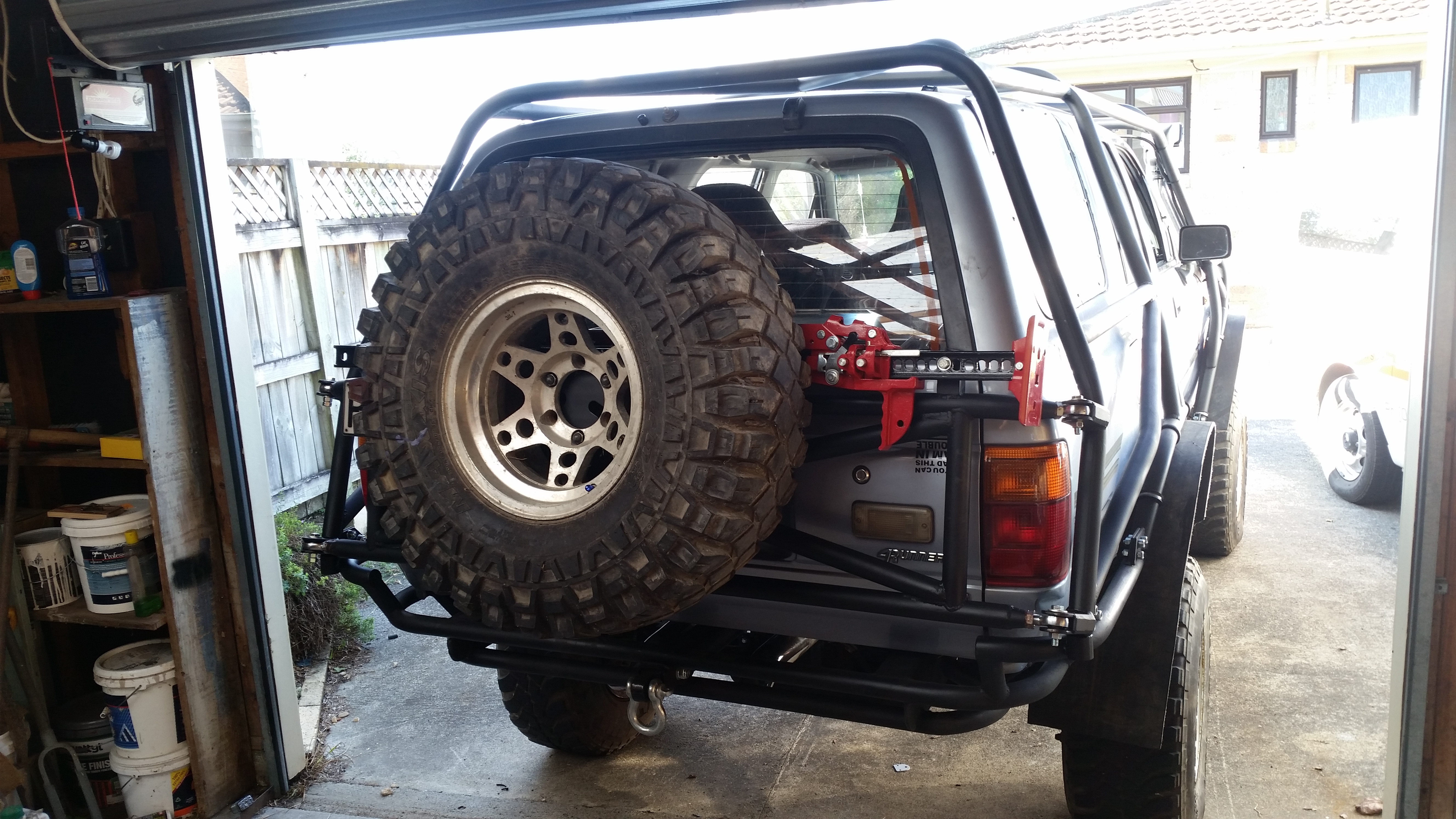

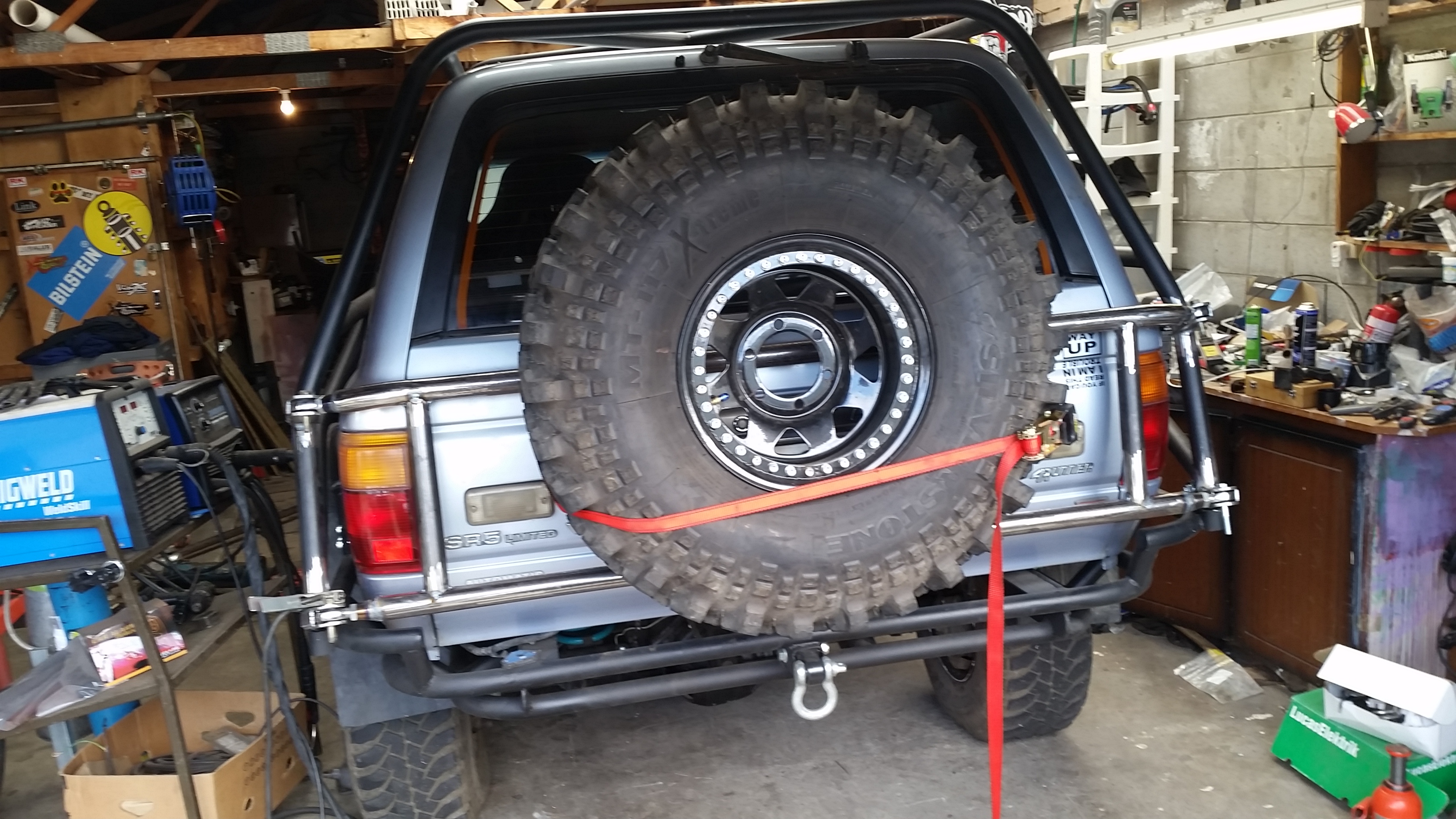

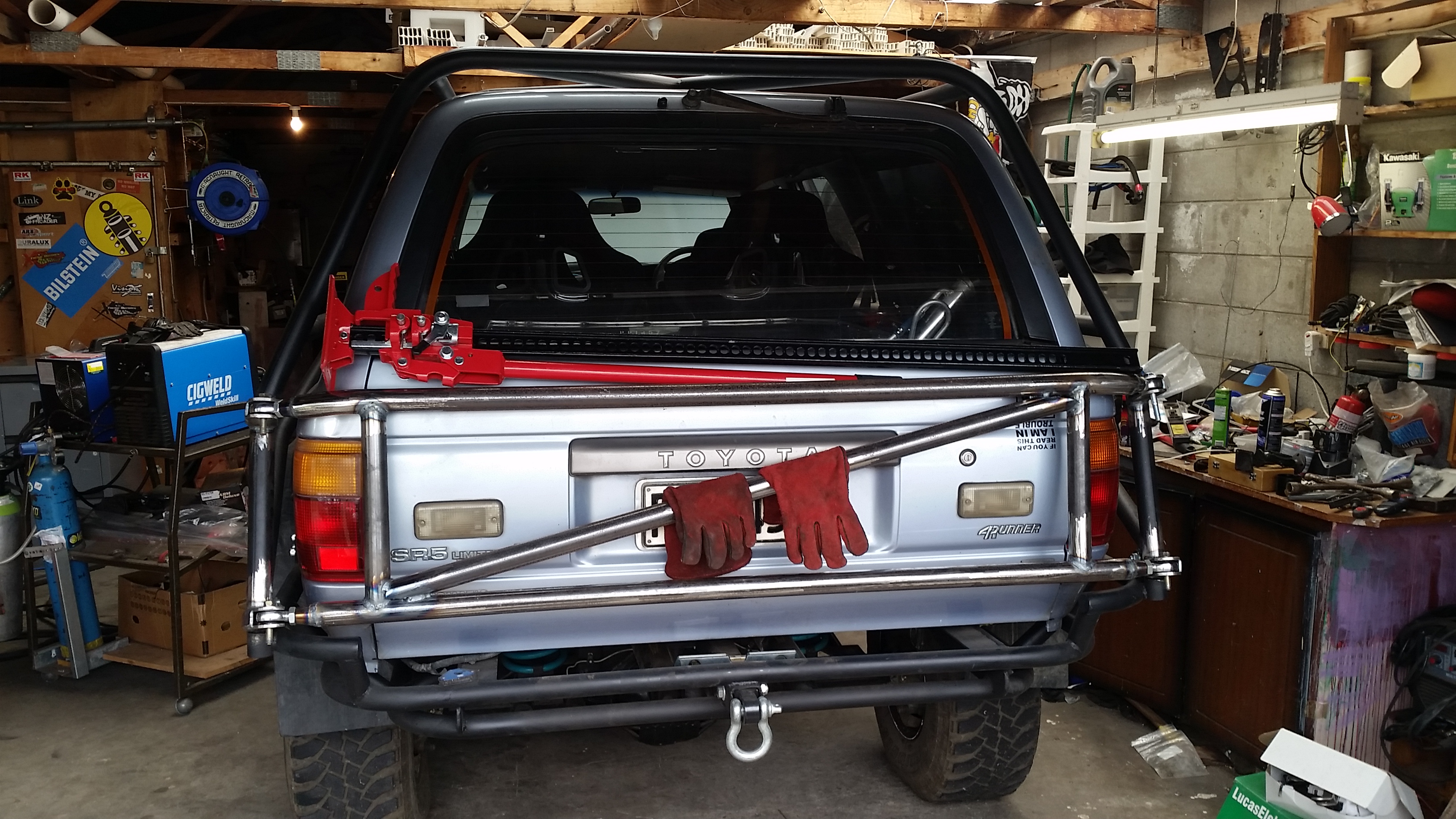

Started making rear frame to mount high lift and my spare tyre that doesn't exist yet..kinda using it to add a small amount of cross brace into the rear cage aswell. Not finished yet..

Have fitted another one and went road tuning for a bit..sorry neibours

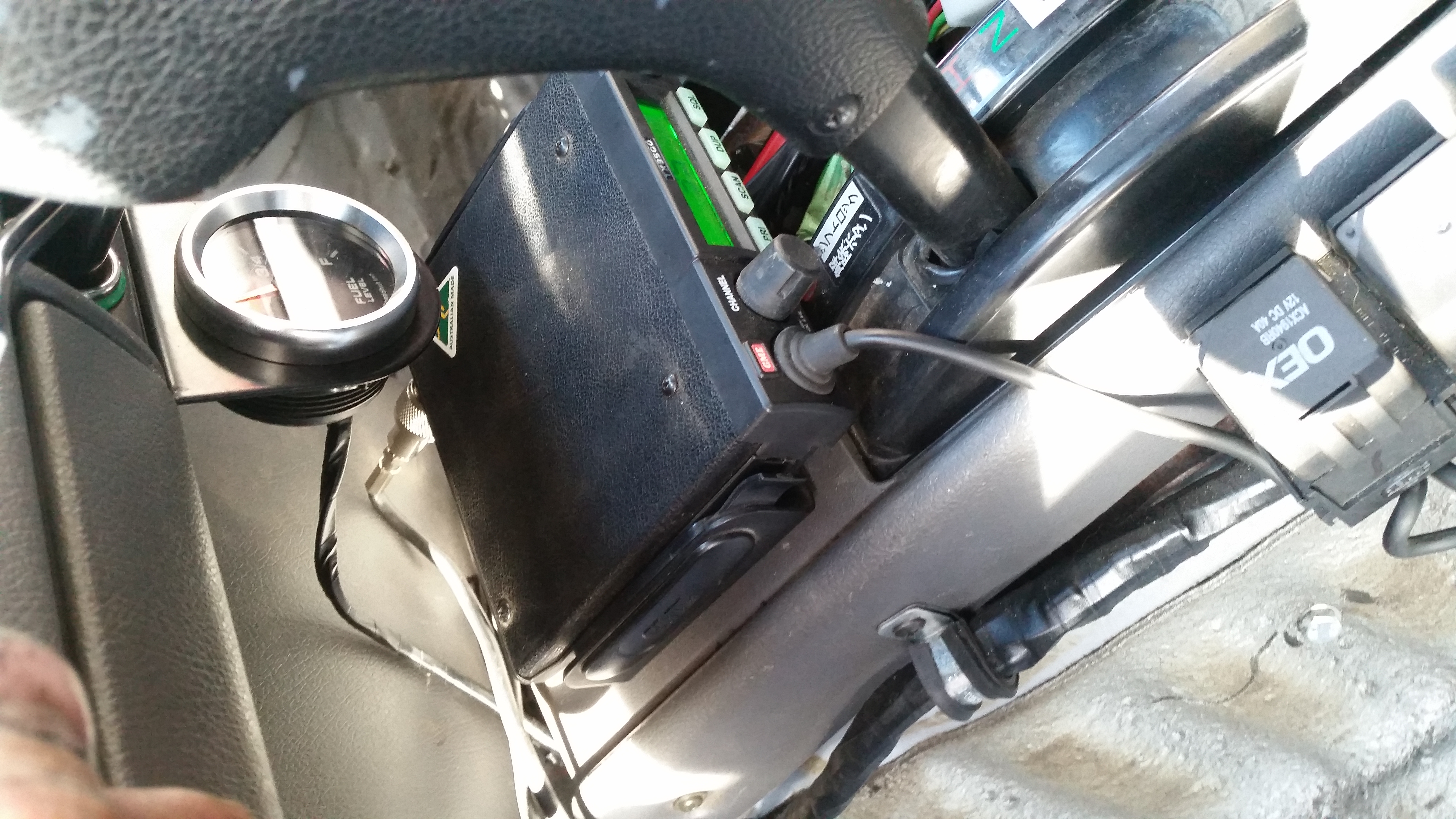

Got radio installed aswell
Cheap shit...
Cheap shit...
Radio fitted
Radio fitted
Rear frame painted up

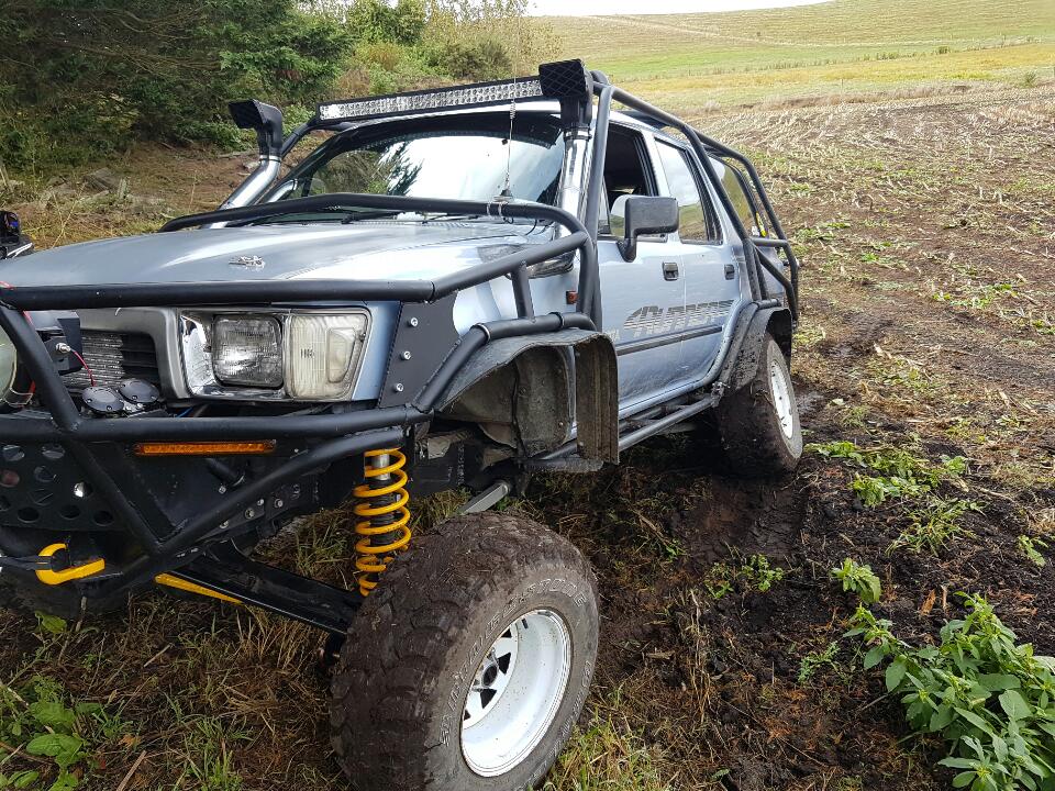

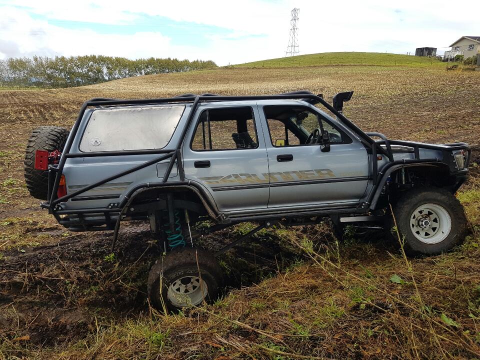

Went for a small play at parents maize,couple issues I found,when oil temp gets to 100 oil pressure light comes on at idle...not sure if this is cause I have two turbos suction get all my oil pressure or not.or if I just need thicker oil.15w40 atm.
Also rear guard rub so have repositioned guards with a hammer,only had worn 32s on but there on 15x10 so slightly wider than my beadlovks.. no videos sorry bit hard by myself.
Hopefully might try a Woodhill mission next weekend
Also hopefully pics work have new phone and need to resize photos before uploading
skidmark
Posts: 616
Location: hamilton
Post by skidmark »
Also the first car I've owned that'll light the rears up at 60 KS. Coming out to power in 2nd..albeit one wheel on wet road but still...
