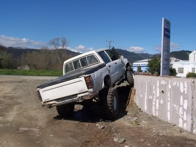

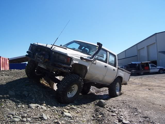

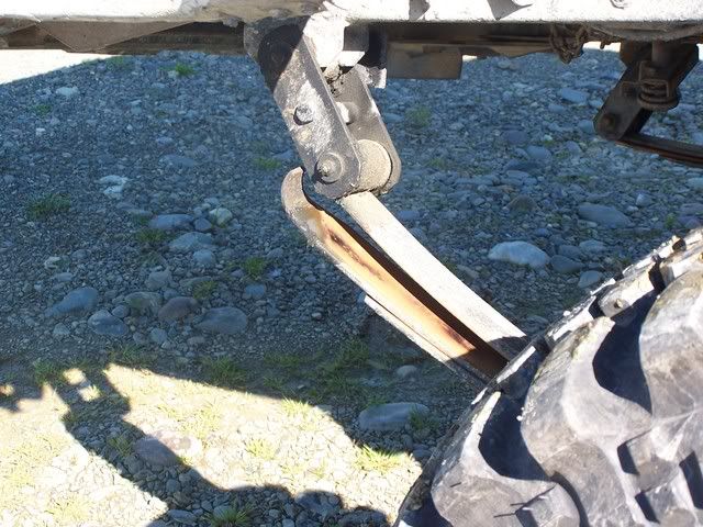

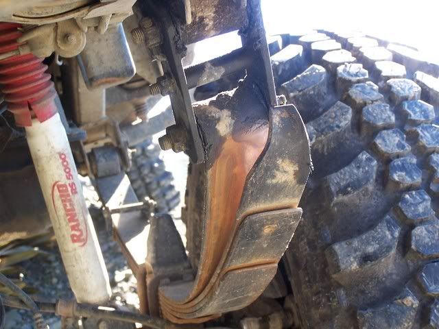

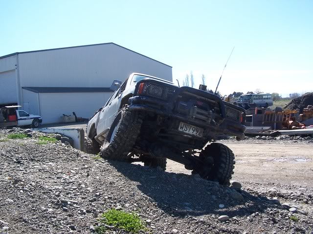

I have never claimed to have a lot of articulation and as I have said before with double diff locks you dont need it. What the pictures show is not the maximin as it was still 20mms from touching the front bump stop as I couldn't get any higher on the loading ramp. Showing about 800mm
I have also said I do the exact opposite of most people with most travel up to keep positive pressure on the wheels.

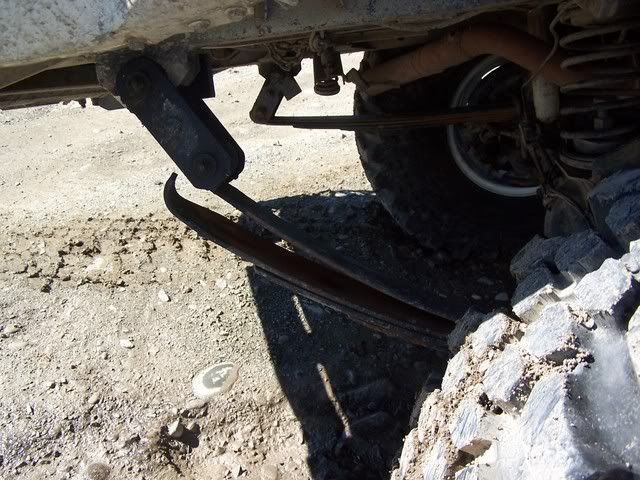

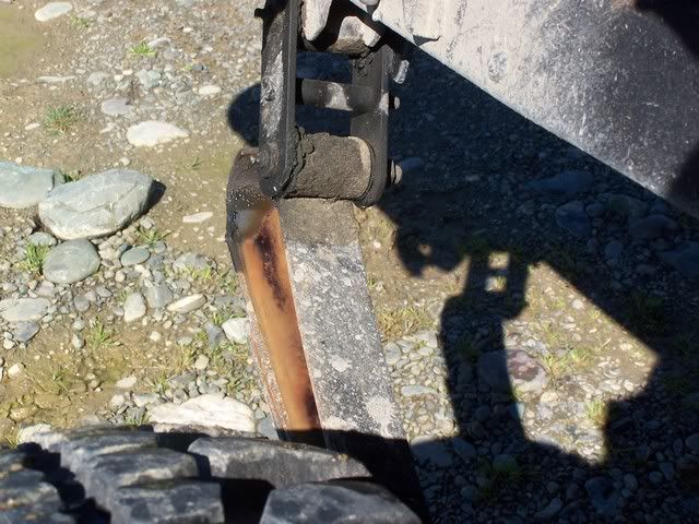

The secret with Leaf springs is to remove the ties and take the stress out of the springs.
Here are some pictures of my articulation and what happens to the springs
Notice the coil on the top of diff putting positive pressure on the dropped wheel
Also notice the shackle has gone straight but the wheel drops further without the tie on the spring

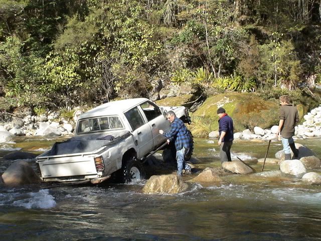

Hung up on a boulder trying to get across a west coast river last weekend
Richard

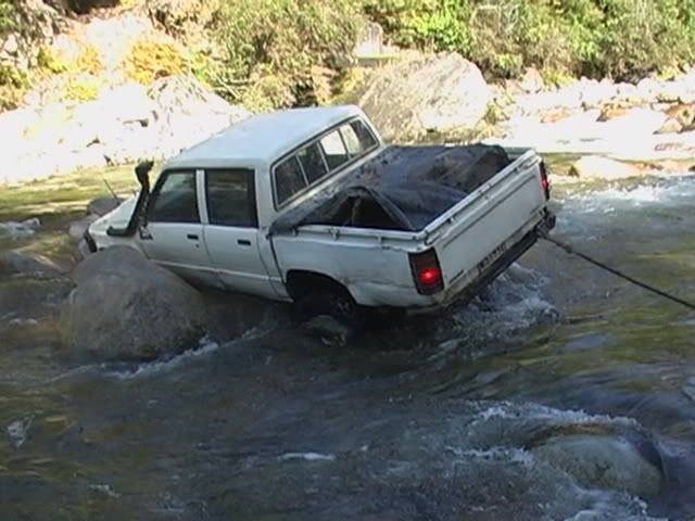

This will destoy your faith Wayne. Perfect driver and perfect truck, mud was a fault this time.
On the Westcoast Queen Birthday 2008
Cheers Richard
