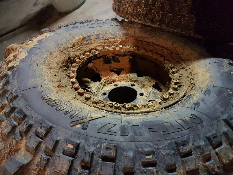

The most disappointing part though

skidmark wrote:The most disappointing part though
Awesome bud ran that on the back and double the tiye size foot print :lol:
Madaz
Posts: 1042
Re: first surf build.
Post by Madaz »
Far out................ :shock:
What brand of wheel were they?
I think that's the problem....they arent
Madaz
Posts: 1042
Post by Madaz »
Yeah, but most people are running chinese shit rims, and I havnt seen too many people with that result?
Especially not just driving round Woodhill................
Even the roll in this clip didnt do the damage you got............

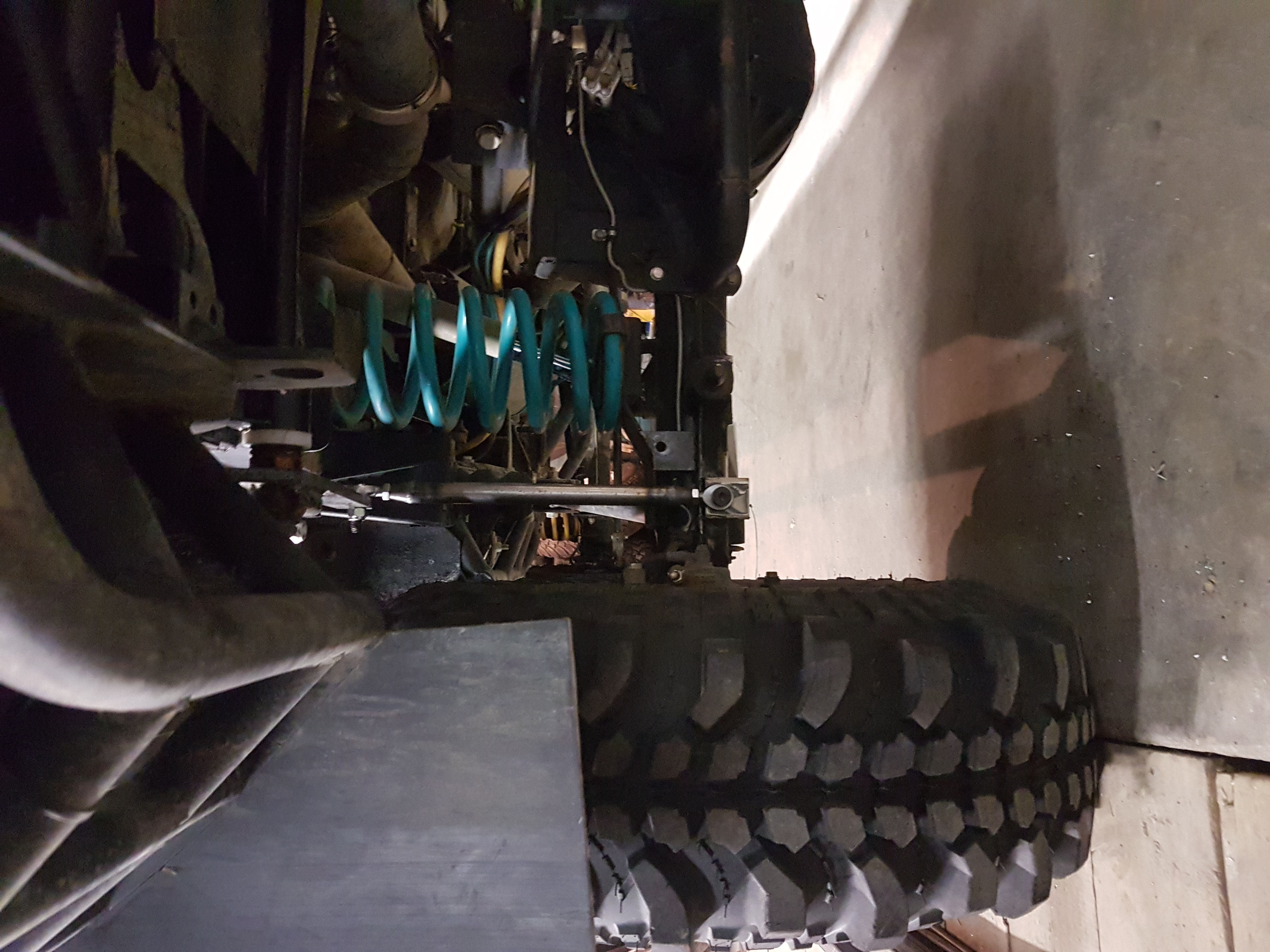

Things havebeen a bit slow since the last outing... had rim repaired with a new centre fitted...only got a shitty rattle can black this time round.
Fitted a efs panhard from force 4.
Noticed a couple things i needed to do. Fitted a set of winch horns.
Orederd and fitted a set of limit strap front and rear as suspension outflexed shocks and didnt want to cause premature stress to them.
Also wired up trailer plug and reverse lights onto rear frame.

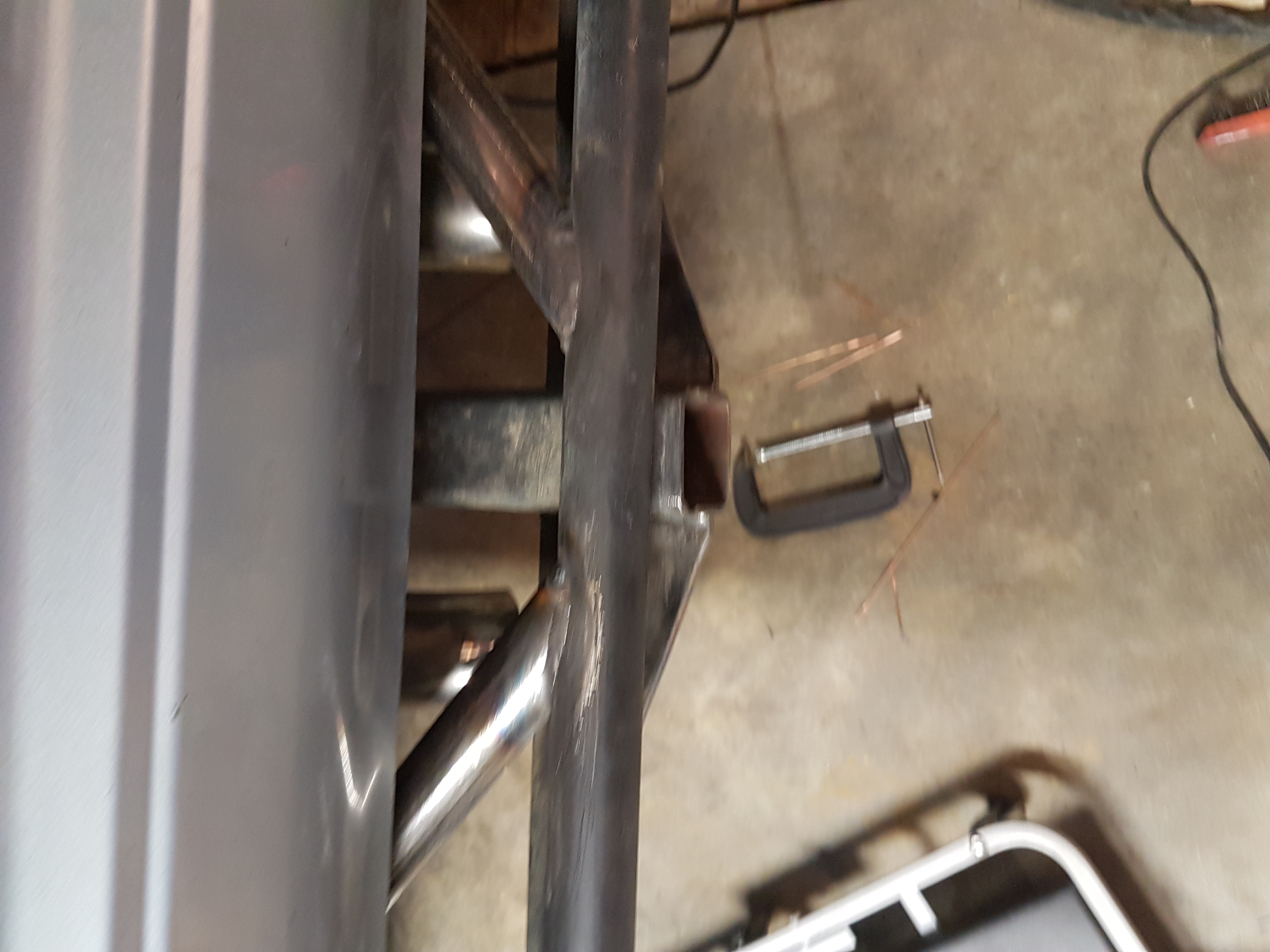

Going to look at making a rear sway bar from a torsion bar, to help improve roll stability. And hopefully make the front work better
skidmark
Posts: 616
Location: hamilton
Post by skidmark »
Brought it out of the shed once since my last post, got a wof and back in the shed....
But have roughed up a sway bar haven't driven with it but grabbing the cage and rocking it makes a huge difference.
Just waiting on some misalignment spacers, to give the heims some more movement then slap some paint around.
