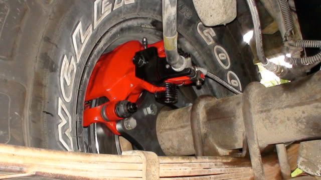

The calipers are painted. 8)

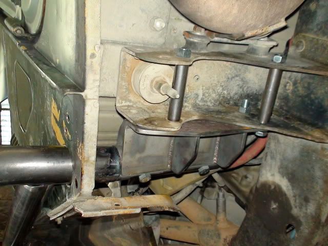

This is the new engine oil cooler, sandwich block and fittings ready to go in. I've brought 2 meters of braided hose to connect them. I'm hoping this is going to help keep things cooler.
The cooler is going up here somewhere. :?
Removed some steel. Ahh that's better. :mrgreen:
The oil cooler will be mounted on a removable vented tray protecting it and making it easy to drop down and clean.

what calipers did you use, any chance of some closer pics? Need to do this mod on the lux

haynzy wrote:what calipers did you use, any chance of some closer pics? Need to do this mod on the lux
Yep I'll get some close up shoots tomorrow for you. No probs.
Hey hayny. If you want the mark1 adapter plates and spacers for this job let me know. I'm selling them. The mark one kit is being modified to the same specs as what i had the second set made to. Only the spacers are 10mm thick. I had new spacers made up same shape just thicker, 16mm thick to suit the caliper's dimensions.
The calipers on the rear of my 40 are off a Toyota MR2 Turbo.

Here are some close up as requested.
Rear.
They work a treat!!! :mrgreen:

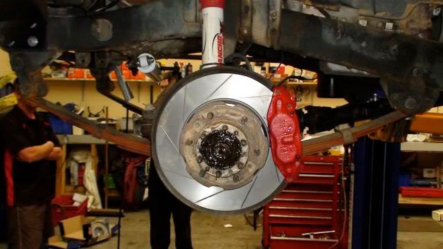

HI pete, your front discs? are they the factory set up for your your 40, or are they after market ones youve put on?
petefj40
Ms Daisy
Posts: 4218
Location: The Mainland
Re: petefj40's never ending mods!
Post by petefj40 »
arkfj40 wrote:HI pete, your front discs? are they the factory set up for your your 40, or are they after market ones youve put on?
The original rotors before the new ones were off a later model cruiser. 70 series I think. It did have drums around before then. The new rotors on the front of the 40 now are Prado ones. Same as the rear.

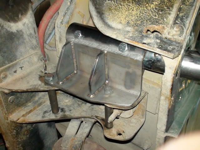

The oil cooler was fitted today.
Looks like there's plenty of room to clean it (if it ever gets dirty). :lol:
I'll be putting some heat rap around the pipes exiting from the sandwich block. They are pretty close to the headers.
