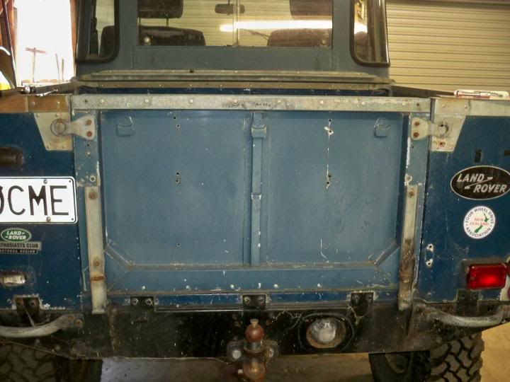

Well seeing as I finally got it home I thought I'd better do something with it........so I thought I'd start at the back. The tailgate that I'd got, when I swapped the Station Wagon for the Truck Cab, had rather dodgy looking struts, they'd obviously been broken & rather badly welded back up.
So I pulled a tailgate off an old S2 & guess what....the struts are identical (well actually the whole tailgate is identical! - you gotta love Landies 25 yrs difference & still the same parts!). I also added the fittings to hold it up.
That was last night, tonight I looked at some of the electrics, first up I wired up the spotties, most of the wiring was already in place so just a case of hooking it up. Then time to look at why the horn & indicators weren't working. Obvious really ....... the fuses were the first place to look & whilst the fuses were OK the connectors were not, so a bit of emery paper & all is good, except for the rear left.........that was also full of water and corroded so was also cleaned up for now but needs replacing........LED's would be nice!!!!!
That's all for now folks.......
