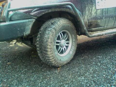

Here is the photo of the current setup.....which really doesn't solve my diff problems.
I also have a question about how much tyres effect preformance because I have chipped this truck...whcih supposedly bumps it up to 149kw(?....I believe).....but to be frank.,......with the big wheels.......it slower than in original form with the 31's on it. Could this tyre change...(to the current size),......make that much difference? But then again.......maybe its not worth asking the question if I get the same response as the last time I asked one

So.....only solution now hasbeen putting on the tyres I have now.......Maxxis Bighorns 305x70x16s (buggered if I know what size that is in inches).........and I now still have a set of simex 36x12's sitting in my yard.....where I can't use them.
The tyres on now rub bad enough.....never mind the others,.........now .......I have a toyota guy sourcing something to remedy my problem.......but again....I ask my original question........does anyone know where we can source the kit that fixes this.....I have heard about somehting that changes the whole front end.....obviously thats what I need.

Yes the bigger tyres will make a difference, the weight difference is huge and adds to the un sprung weight and also adds pressure to the driveline, more friction on the road etc.

This 4" Lift Kit from Snake racing will let you run 33" Tires
http://72.34.32.141/~snakerac/product_info.php?cPath=3_107_233&products_id=1835&osCsid=9b1d3c9697c459fbba1776385c22c562
305/70/R16 = 32.8"
305/70/R16 = 32.8"

Cheers for that..........it would solve my rub at the moment.....but wouldn't help me fit the simexs.......lol........and fix my diff height prob

Would be interesting to hear what size lift you would need to run the 36's on the lux though.

Are these trucks monoque? (Ie no separate chassis)
If not, then what about a body lift. It will allow you to fit the tyres, which will lift the diffs up (by the difference in tyre size).
Not sure if this can be done with modern airbag systems though, but someone else might.

well... I'll retract my negativity now.. I think I know the vehicle you own.. it does look great.. I have found the 05 hilux i use at work now with its 32's and 3" old man emu lift a heap more useful offroad. but its really lost its go around town.. and bugger trying to take off with a load on a hill, first gear is way too tall..
vehicle has chassis.. so body lift would be possible.. Talk to Ryan at Snake racing. I was certain he had made a kit to give lift to run 33's for a new hilux. http://72.34.32.141/~snakerac/product_info.php?cPath=3_107_233&products_id=1835&osCsid=865501412393f10ec99f592e9d581584
Im sure with a bit of persuation you'll get your 36's under..

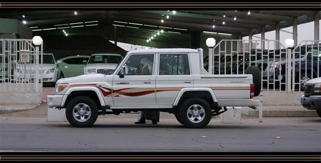

A cut down 70 series would be nice
some thing like
or
but the deck is too long
http://forum.ih8mud.com/70-series-tech/205700-new-70-series-2007-body-fabrication.html
there was a real nice earlier one on trade me recently
some thing like
or
http://www.skyjackeraustralia.com.au/toyota.htm#Hilux
is the kit we used, we got 35's under the truck but with rub, when we got the kit about 6 months ago he was talking of a 6" lift kit, he also stated you want bigger than 35's you need to relocate entire front suspension forward to give clearance,
we found them good to deal with and easy to talk to, worth giving him a call
