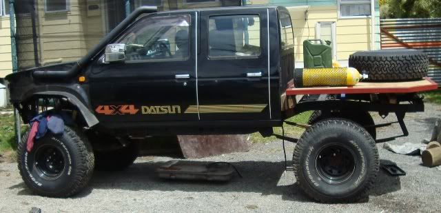

ok,for anyone still out there watching
,IT NOW HAS CERT
took truck into freelance automotive thismorning,lance went over it with a fine tooth come,road tested with stop watch etc,all the things that should have been done by previous certifyer,and done,ws happy the handbrake ws safe and worked,happy with all other work completed,and very sharp price,to all guys i recomended previous certifyer,disregard that comment,my appologies,USE THIS GUY

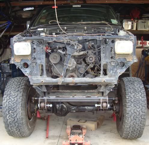

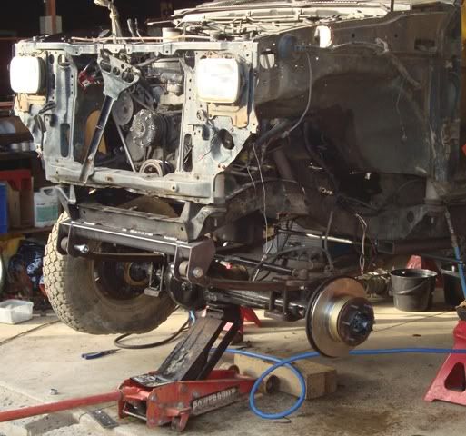

couple of spring and axle fitting pics

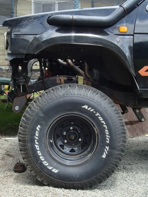

possible position of wheel

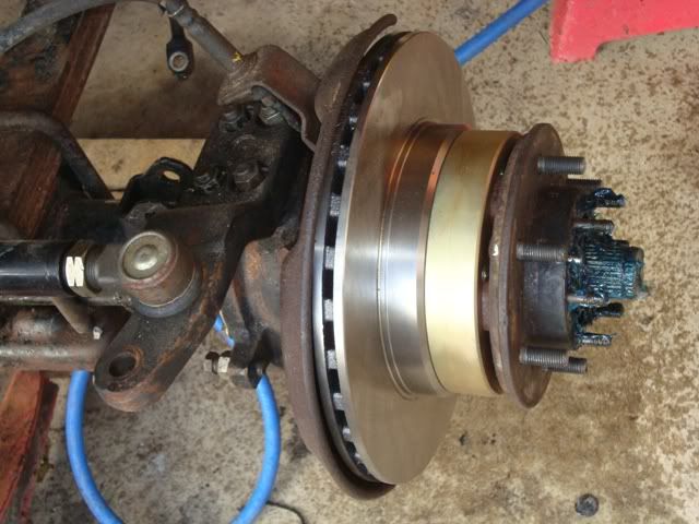

ifs hubs and rotor moved with snr spacer,so easy

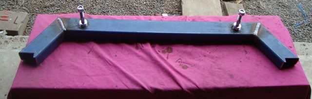

new xmember i fabd up after the one we had just wasnt right
weight on springs
as it sits from side
and front

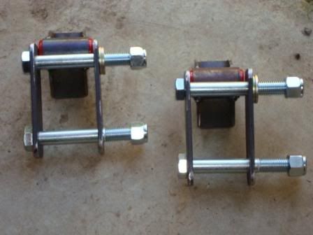

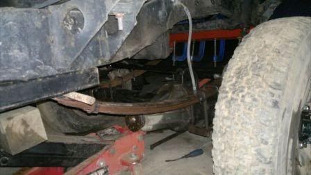

mounts and shackles for rear of front leafs

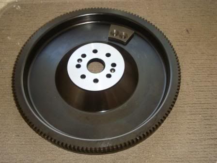

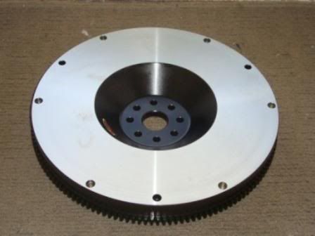

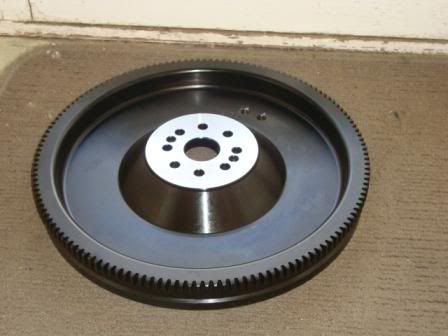

new flywheel
with weight
without weight
and front surface,got to love new parts

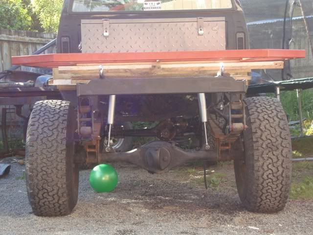

and new 14" travel shocks for the rear

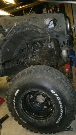

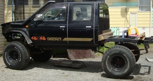

as she now stands with no bodylift
at the back of last pic you can see rear shock tower in place
better pic of approach angle

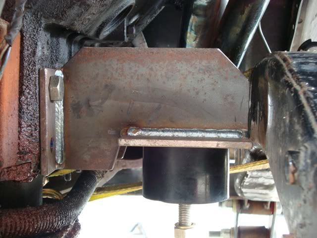

close up of mounts,both sides the same just mirrored

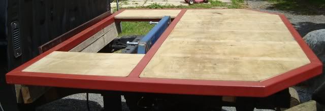

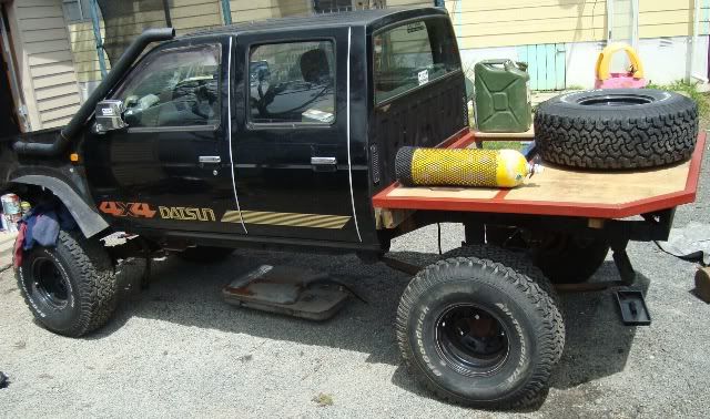

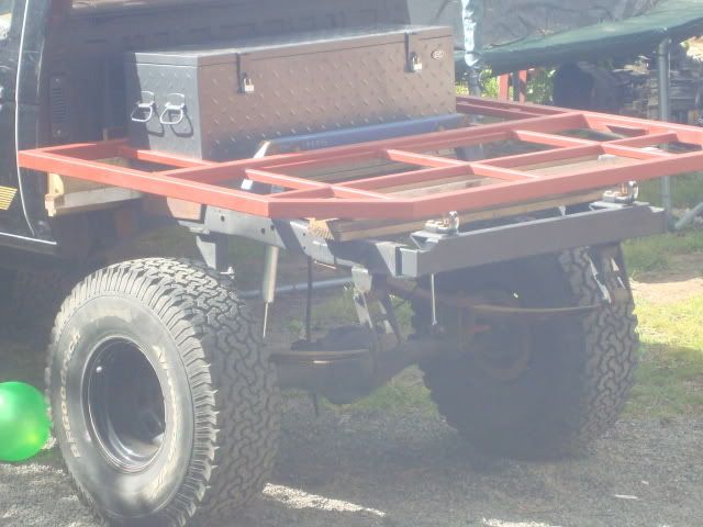

new deck,yes with a big hole
this is what fills it,sits half under half over the deck to keep weight low
and what it'll look like when its got the toppings added
shock x member welded,shocks in,where box will sit and deck frame shot

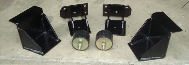

all eng mount brackets ready to be bolted on and zapped to chassis

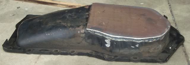

start of rear sump conversion

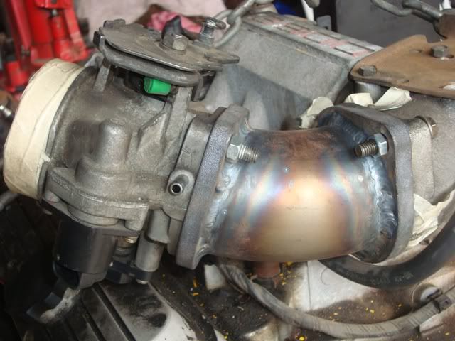

throttle body moved with new pipe / bracket

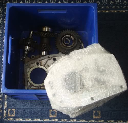

reduction box parts and dual transfer adaptor ready to be put together

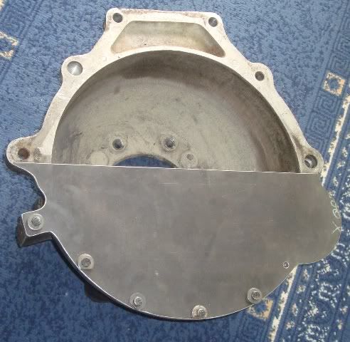

start of bell housing cover plate

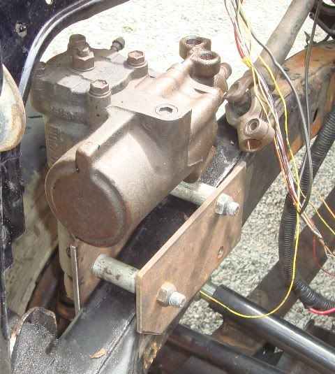

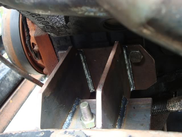

steering box with plates and crush tubes,just needs to be dropped down 15mm and zapped

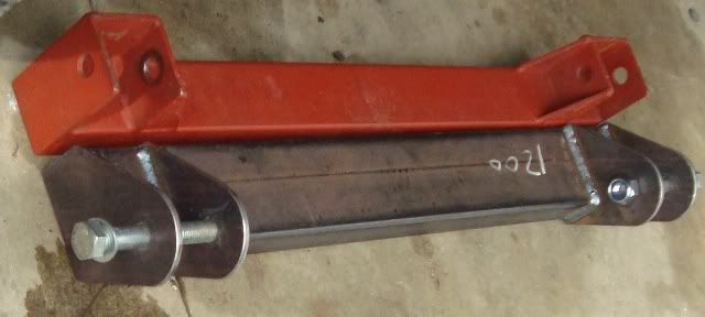

weight on springs
and front

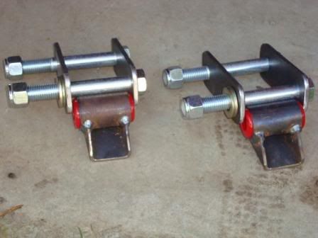

new flywheel
with weight
without weight

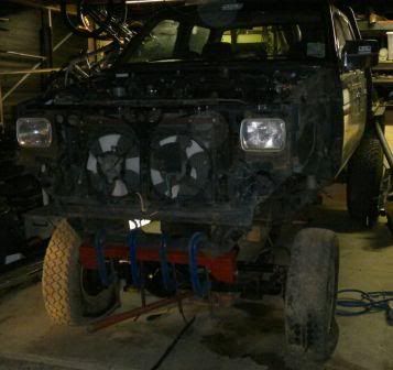

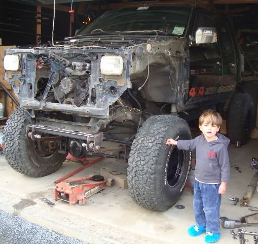

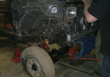

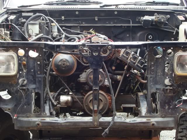

well made some good progress for the week.all ifs crap removed and in the bin,main bits of the ifs brackets removed so we could start eyeing things up (unforunately i cant grind all hours of the night in suburbia
then got into it sat night with the boys,rolled the front end under and she's looking good.with it all sitting at ride height the vehicle should now sit almost completely flat as instead to nose down and the approach angle is looking really good,all pics in post above
also looking like we'll be able to remove almost all of the body lift which is really going to help with the height thing

few more pics added in page 5,you can see in the photos how much hook the chassis has at the front so x member we had just wasn't right and would have meant losing spring radius length,so I fabd up a new x member which you can see sits flat with front of truck and gains us 40mm of spring radius length which were happy with.oscars removed everything engine related from motor,he's also picked up a new air tank each for his truck and mine,bottom photos is how it sits now on all 35s.height of truck body is at 1950 and that like I say should be coming down to 1860 after body lift is removed
oh and dont look at the weld in the centre of the x member,bloody wind
.i was in overalls gloves and helmet and didnt relise the wind behind me had oicked up,after 5 mins of thinking my welder was playing up i took of mask and gloves and what would ya know,its bloddy blowing a gail
,so that needs grinding off and redoing

That new x member looks much better mate , definately looks better sized for the truck anyway and wont bind up on the inside now like the old one did ... bet your glad Oscar and yourselve decided to scrap the other one !! Good to hear and see more improvements / progress its coming along nicely !!! Keep the pics and the posts coming , I have " subscribed " to this thread now to keep up with ya guys

photos added on page 5 of new rear mounts and shackles for the front springs,planning to zap them in this weekend so that'l have her on all four again.
also picked up the new flywheel which we tracked down through bnt,$680 but still cheaper than going to aus and far these middlemen so oscars happy,only thing now is ive got to work out weather we need to run the counter weight or not and buy some new bolts to put her on with along with collecting clutch next week
gearbox xmember is in and holding up the box but needs 2x inside chassis brackets added and then 4x holes drilled,front edge ive got to fold up and a slightly bigger scallop for the oil drain plug and she'l be sorted
