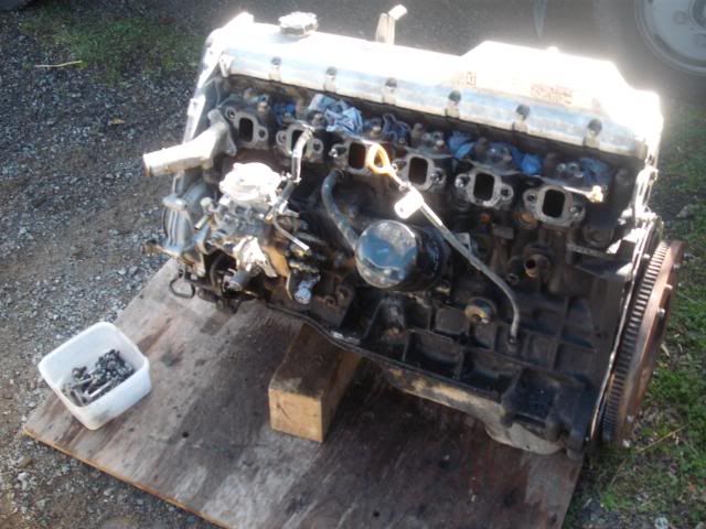

looking at the pics i can't help but wonder whilst the engine is out if it's a good time to give it a new coat of paint. A nice shade of yellow i'm thinking.........

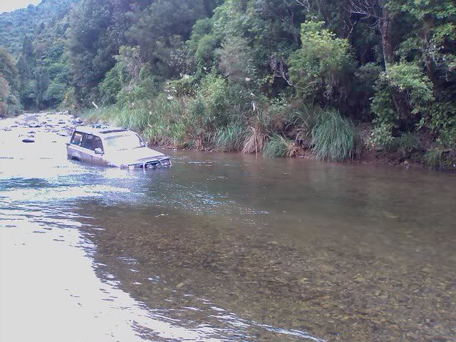

Also, this is a fairly accurate re-enactment of what happened and how deep it was except for the fact that I was in a flowing river, so water was coming in fast and beating up my cruiser...........

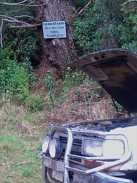

Shouldn't that sign on the tree say "ENGINE BREAKING"....
- wgtnnewbie
- Posts: 708
- Joined: Sat May 26, 2007 12:00 pm
- Location: naenae, lower hutt
Re: WANTED URGENT: 80 series snorkle for Skid
altering the sign was discussed but i can't remember why we didn't.....

The message gets across though
altering the sign was discussed but i can't remember why we didn't.....![]()
No tape to change it

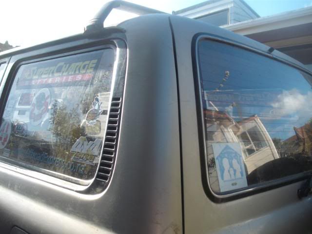

skid wrote:upon further investigation, I have found yet another sticker that was placed upon my 80 whilst I was at work and the boys were pulling motor...................
THANX GUYS, LUV YA WORK![]()

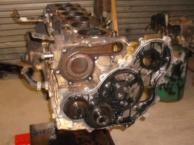

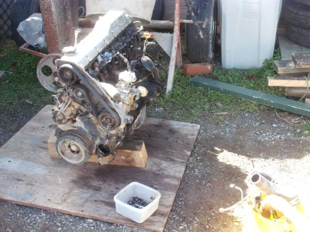

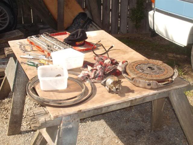

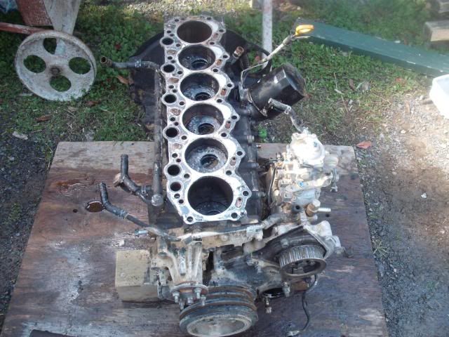

had a bloody busy day today at work so did not get much looked at, but did get most of motor stripped down........
it may be a bit blurry, but if you look close enough, you will see balck marks on the pulleys and one on the block in a different place, this is far as the crank turns round. It isabout 20mm away from doing one complete revolution, so it seems we may have a couple of bent rods or something. We suspect the middle 2 pistons due to them being the ones that don't do a full cycle.......
the head seems fine. The camshaft spins freely and all the valves look like they are doing what they are supposed to do with no odd movements or anything like that. A clean up and it should be good.............
I will be pulling sump off on Wednesday night to investigate deeper and hopefully having an accurate answer to the inability to turn over and then the list of bits will be made and sought![]()

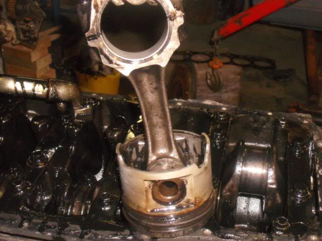

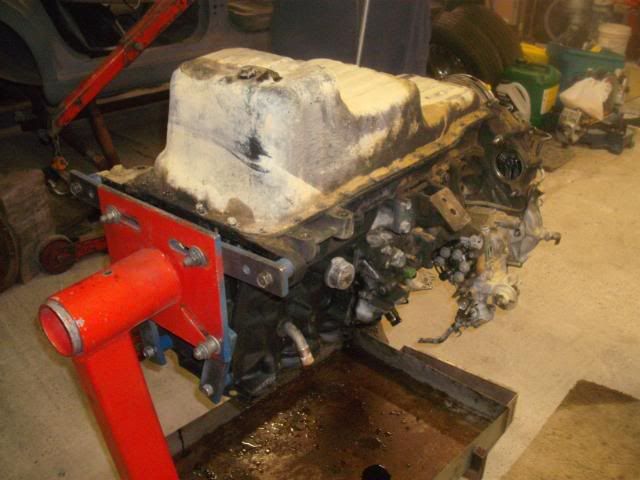

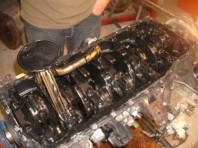

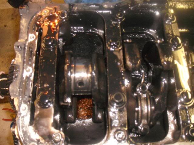

righto then
went round tonight to pull sump and determined why donk not wanting to turn over....................
so, once the sump was off we were turning it back and forth and shining torches etc in there but could not see any problem at all........
so we decided maybe the gears behind the front cover were jammed or something.........
but they looked mint as well, so by now we were getting dumbfounded and scratching heads, when I spotted some shiny parts down around the bottom of the number 1 rod, so we took out the rod and piston........
and wouldn't ya faaarking know it.......
ITS BENT............
So we only have one bent rod,which is a piss to find after pulling the whole motor down, but it had to be done.
So tomorrow I will price up a new rod, head gasket, water pump, cam belt and then it goes back together
hope you welly boys remember how the faaark it came out
p.s. gotta repair chassis cracks first
