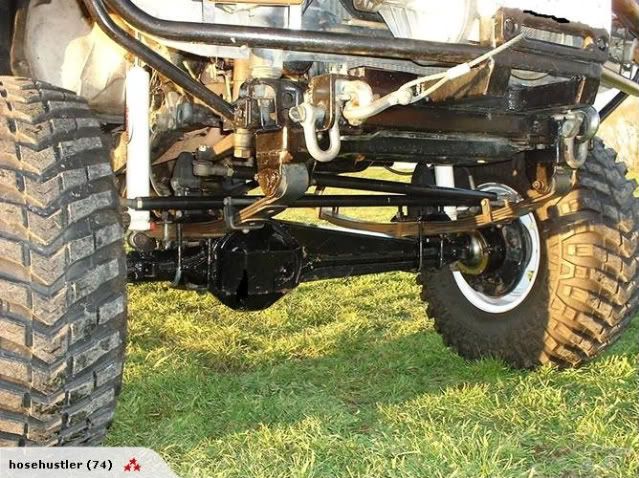

Re: chopping and modding yn60 hilux surf
Are they they original u bolts? I thought you had to flip them with custom ones or something? I pan on doing ruf and cross over etc would be good not to have to worry about new u bolts! Great write up mate I look forward to the updates. Make sure you take lots of pics of the steering. What did you do for the hand brake?
can you post a side pick showing shackle angle?
im using a transfer brake
i dont see why you have to do a U bolt flip for high steer, i know its the other way round ie: you cant do U bolt flip with standard steering.... but thats why ive left them untouched as i think i will do a U bolt flip, but at this stage it wont hold me up..
haynzy wrote:can you post a side pick showing shackle angle?
hhmmm so you knew shackle angle would be touch n go..
its mm away from touching chassis, without the weight of engine in either.
Longer shackles will just drop your pinnion downward an you might find the d/shaft slipjoint will seperate during articulation
Didn't barbie drive a jeep??
you need to drop the front spring mount about 65mm this will help immensly, most do a full new crossmember, this also helps keep the castor angle right
isnt that effectively just raising it?
i know this is done on most rears up front but I cant get my head around how droping the front mounts alter the shackle angle?
the rears are longer hence the shackle angle being pushed right back, but by dropping the front hanger the length still remains the same dont it???
im keen to hear the ins and outs

some times it best not to wonder why as this has been done many times before and the same problem you are encountering always pops up,the only other way is to move the rear mount back but you are best to lower the front, no point doin the hard yards and being left with a truck that dont handle too good....
I know where you are coming from J_dub want the crossover and rears up front but without a massive lift as you will still do lots of road ks. I have the same plan. There are plenty of ways to skin a cat. Do it once and do it right for how you want it.
If you lower the front mounts then you could try taking out more leafs but that might make it a bit more tippy not being as stiff?
Move the shackle back and then adjust the pinion angle at the the diff?
I'm sure there is a solution....
haynzy wrote:J_Dub wrote:isnt that effectively just raising it?
all very well, and im not at all doubting whats been done before but i still want to know why im doing it and how it works
You need to drop the front spring mounts the SAME amount as you lengthen the front spring shackels, either a new cross member or fabbing up some lengthened mounts, this will keep castor angle close to factory, very important other wise "death wobble" will occur, not nice. As others have already pointed out RUF always need a longer slip joint for your drive shaft due to flex, and no you don't have to do a U bolt flip but if you're goint to the trouble of doing the above you may as well tick it off at the same time.
awesome cheers
is it an option to lengthen shackles then re-position spring perches on the axle??
as by lengthening shackles then dropping front hangers is gona give me alot more lift, and im trying to keep this relatively low.. as possible anyway....
cheers for the info fellas
Jared
Jared
- hosehustler
- Posts: 2051
- Location: Brooklnands
basically you can't keep a low centre of gravity and run hi steer without drastically modifying the chassis (check out pirate4x4 some have done it), you need room for the drag link and tie rod to be while flexing, and with hi steer they are both above the springs soooooo the only room is between the chassis rails and the springs........ a significant lift is req
I hate signatures
extending bumpstops is a have to then aswell??
