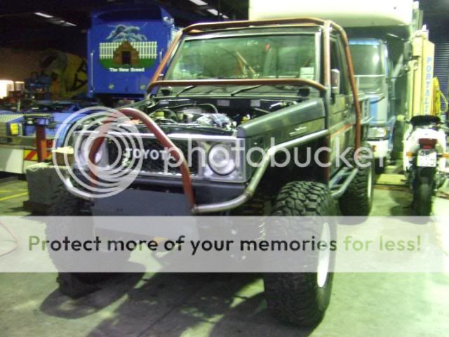

Finished the basic design of the front tube guards, still hadnt decided how I wanted them to look till I started kinking them up :roll: but they turned out pretty good

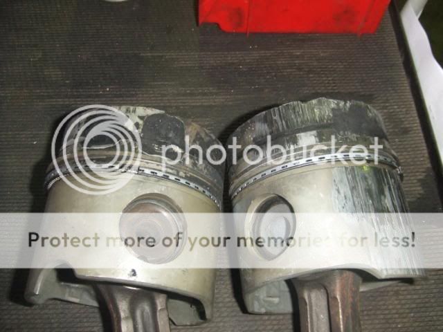

Been meaning to take some pics of the 13bt pistons after the rings decided they werent keen on being in their grooves anymore :lol:
2&4
#2
#4
:evil: :evil: :lol:

Big
Posts: 2134
Location: central Otago
Re: BJ74, UPGRADE!!
Post by Big »
looking good Fakey.. Love the front bar gaurds.. was thinking how you were going to get that done.. very 8)
