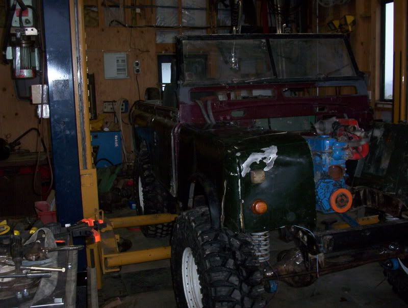

heres some update pics for all you pic whores :wink:
I dont have anytime to do writeups at the moment.

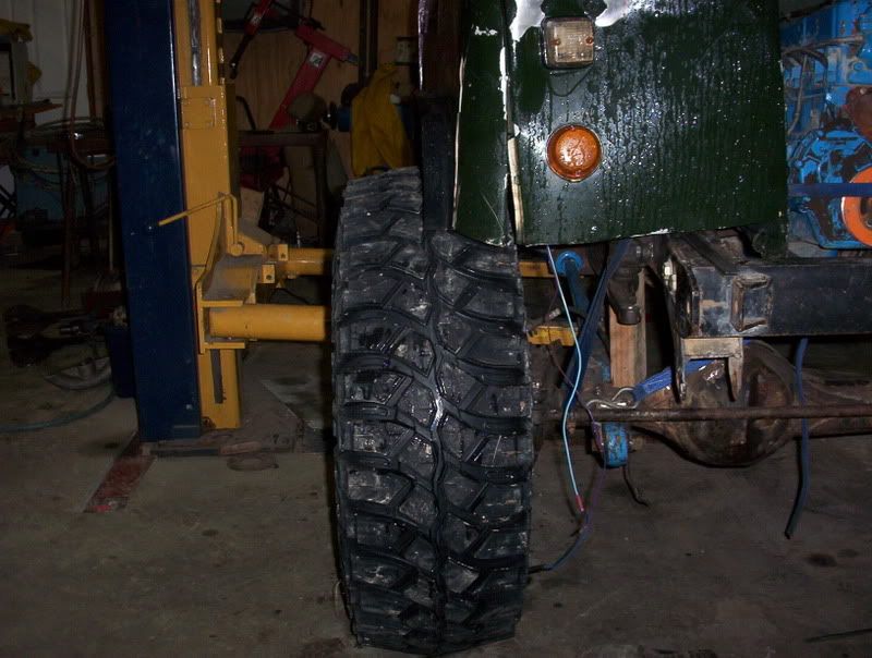

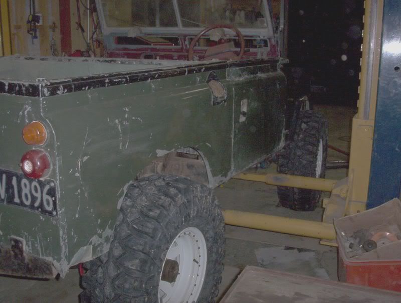

Got width :roll:
And from the front
Front on with inverted colours to make it look cooler :lol:
and heres a random one. Sorry about the bad quality pics. There wasnt very much light.

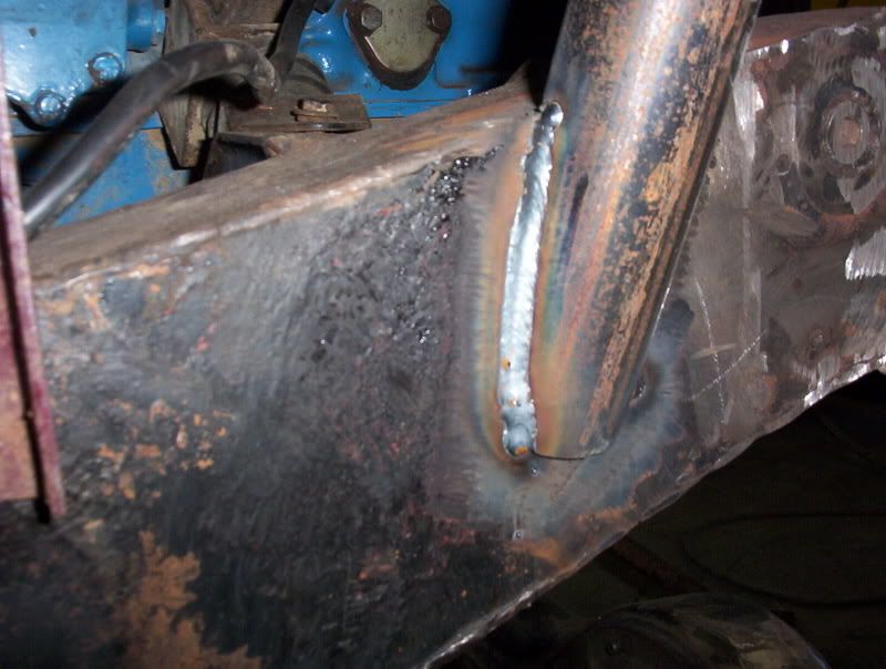

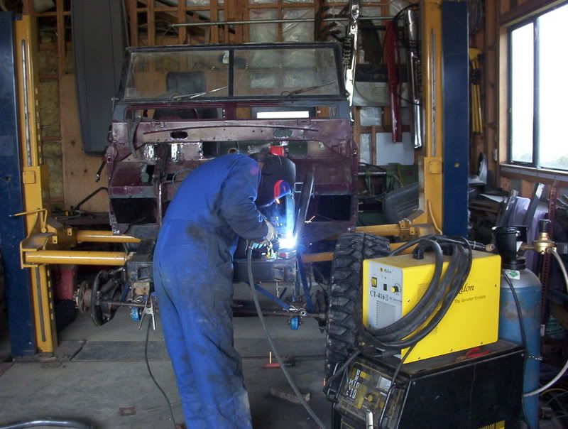

pics to make it look like im doing work on it.
Old man welding

Ok who photoshoped Turoa into a photo of his truck sitting into the garage !!!! :lol:
WACKO
Pyro
Posts: 990
Joined: Sat Feb 11, 2006 12:00 pm
Location: Lower Hutt
Post by WACKO »
is that tu? looks too tall to be him.... :?
