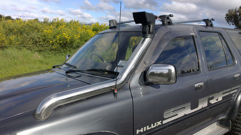

bit more progress:
relocated the plugs for the ignitor packs and afm
got snorkel shortened then fitted it up
finished the air intake
Still got to sort out a bracket for the throttle cable and then be driveable again.

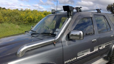

- KIWI_TERRANO
- Posts: 1138
- Location: Kirwee
Re: John's surf project v8 and SAS
looking good mate,
is that a stainless snorkle?
where you get it from and how much if you dont mind me asking?

cheers mate.
yeah its stainless. got it off of a guy on trademe who got 2 made 1 for himself and one for a mate but his friend sold his truck so thats why he got rid of it. i paid $200 for it
And heres the origional snorkel, I sold that one to him after I bought it for a mate but he sold his surf before fitting it.
Awesome solid and great looking snorkels and full credit to the clever bugger who made them but sorry to say I think that one was the last one hes making for a while.
That one was a prototype for a new polishing method hence the welds visible in his compared to mine but either way they look the part.
