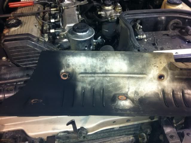

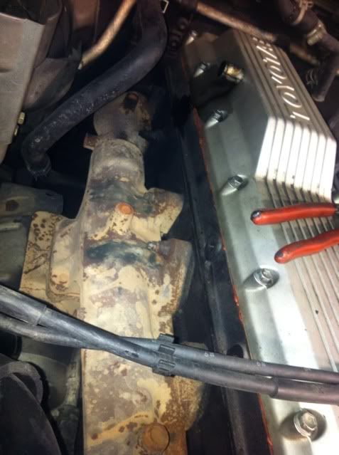

Halfway through installing the pyro gauge I opened a can of worms.
Toyota haters. Please be gentle.
Mainfold leak. There's been a crack bronzed up there too. But that not the worst part.

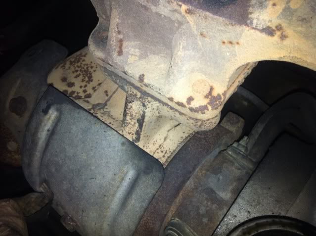

Spot the crack in the turbo.
:cry:
At this point I'm just gunna throw the pyro sensor in and drive it till it goes BANG!

petefj40 wrote:At this point I'm just gunna throw the pyro sensor in and drive it till it goes BANG!
the housings not too bad dude, as long as the impellers are sweet than you'll be good. if not, then ya gotta be careful that if/when she goes bang, the engine doesnt ingest the impellor parts. then you'll be up for a rebuild.
petefj40
Ms Daisy
Posts: 4218
Location: The Mainland
Re: petefj40 looking for a 24 valve turbo diesel 80.
Post by petefj40 »
The crack is on the exhaust side of the turbo. I'm told it could last for ages till it gives out. I'll see how much and aftermarket one is of the same size.
I'm also told the mainfold is an easy fix. It's the explanation seals that have gone. Replacing those will fix the leak and I won't be loosing any boost either. Mind you it says that I'm getting 15psi at the moment.
