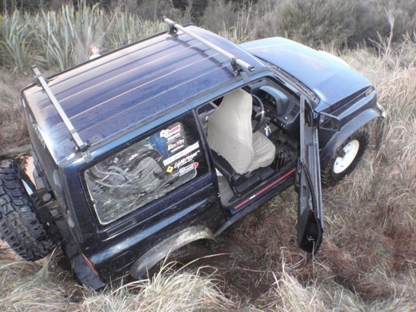

Having some fuel pressure problems. Pump loses prime on an angle with the nose up. It's not great as when I'm stuck and winching out, wanting the engine to keep running so the alternator charges the battery. Also on long hillclimbs she fades. Will move the fuel pump down to near the tank. Wanted it up top of the engine bay to keep it up out of the mud and water and mud. Just have to carry another one in case of failure.
Snapped a cv, could have been easier to change. That stub axle mod is looking like a good idea.
The fuel pump is on the left, blue non return valve further left. Pressure regulator right of the pump,
