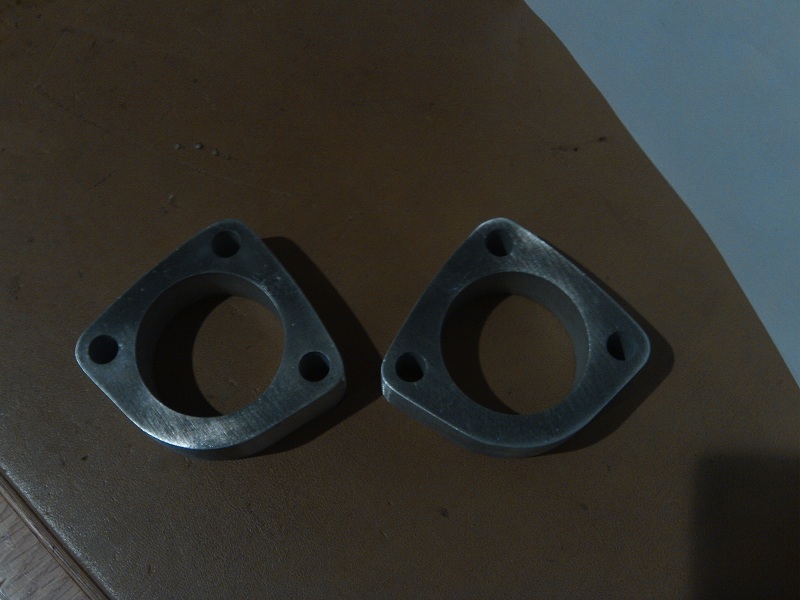

O and heres a pic of the f ball joint spacers i got made up for $75 pair by a local guy on the shore,
Ha gave me a tip aswell how to make up some rear spring spacers for cheaper aswell so will do a little research there. but the fronts all finished now. getting onto the rock sliders now.
