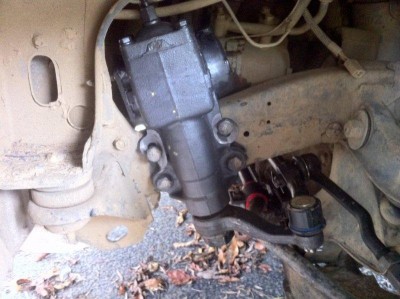

wax wrote:OK well here is the steering box all cut down and almost ready to go on.
I have to slot the holes but I decided to paint it and will touch it up afterwards as well.
Looking real sharp :mrgreen:

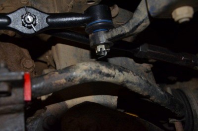

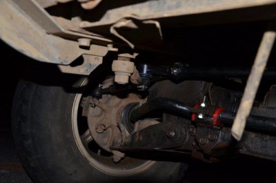

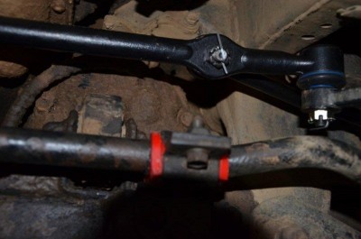

Well I put my 2wd steering ontoday. Im not sure why the other guys say the steering felt really light with no feel. My one feels just the same except it now has no bump steer. It feels more soild and when you turn the wheel the tyres move at the same time. its awesome.
The old steering was brand new and was in good condition still. Its one of the best mods you can do. I love it

18x1.5
takes a little effort to cut the threads but hey its worth it. Got to love having a lathe at work. I didnt have a 16.5 mm drill so I had to use a boring tool.

Thanks I was just out under my car with a flash camera at night. Im not sure what the neighbors thought :lol:

Thanks guys. I havent fitted the power steer box yet but I will be fitting that. I have some play in the idler already.

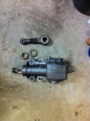

Well here is the steering box modified and ready to go on this weekend.
New bushes in the control arm and a suspension lift. Good wheel alignment and she is done on the suspension side.

I fitted the steering box today and the play in the steering is all gone.
I have the other set of control arms ready to go in and the lift will go on next week as well.
Wheel alignment and that bits all done.
