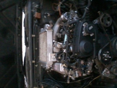

Hey dirtydog, space is not to bad limited front ways but quite abit on the sides which is also nice can reach over and change oil filter ect from the top... The grill hopefully will not need modifying as it is spaced from the bonnet latch cross beam.. fingers crossed anyway. Got the part today i was waiting for so driveline will be finished this weekend and the truck will sit once again on all 4 wheels. Pics will follow

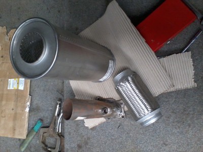

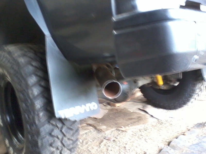

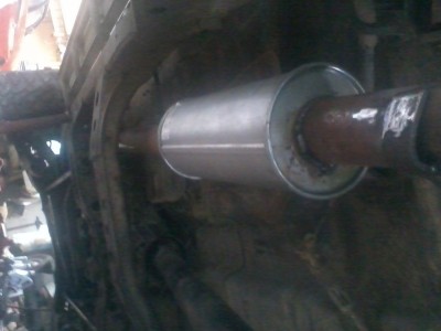

Well today i finished fabricating the exhaust system and i have to be honest i will never attempt to stick weld a exhaust ever, ever, ever again. Most frustrating jobs i have ever performed.

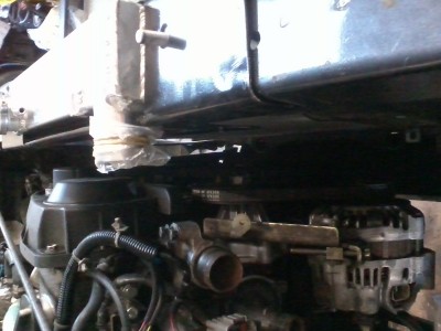

I have also had to modify the power steering pump to get it back 13mm as it originally ran off the front crank pully which i machined off to get clearance, since i dont run a/c i used its groove to run the power steering. Will have to monitor pump as it is a bigger driven pully now so it will be running at a higher RPM, will change p/s pully if problem occurs.
I purchased a new radiator which would of fitted snug, the guy gave me overall measurements that are 30mm smaller than the actual size so more mucking around trying to get him to refund it. When things get this tight its down to the mm. Are waiting for my new power steering lines which i got the local hydraulink shop to make up, also installed front drive shaft which i had a 30mm (drive train moved back that far) machined. All the small jobs are starting to really slow progress.

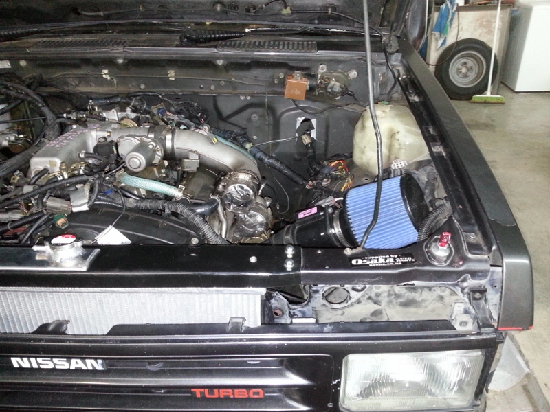

Well managed to spend few hours on the old girl today, ended up using the radiator i had purchased as refunding it was a hassel.

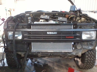

I mounted the radiator today, i fabricated a new front cross beam out of 1.6mm plate that i pressed into a channel, this holds the radiator snugand secure and allows for easy removal the only problem with the bigger radiator is i have to now use bonnet pins as the bonnet latch will not fit, some flush fitting ones are on the way. Room is pretty tight up there but will think of a way to get a fan in there even if its to one side. Managed to fit it behind the grill also so thats a plus.

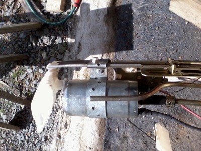

I also mounted the fuel tank, there is a picture of how i convertered the diesel tank into a petrol, that is a rb25 fuel pump mounted onto the original outlet pipe at the correct height and a brace made for it so its nice and secure.
To finish the day off i started to brain storm ideas of how to mount the intercooler, this is the isuzu b/h one i had purchased but am think about purchasing one that has inlet/outlet on the same side. This will save alot of pipe work and can be positioned as pictured.

have you thought about a water to air intercooler?
the subaru ones have inlet/outlet on the same side.
Re: RB25Det Nissan Terrano
Hey Dirty dog looked into the subaru intercoolers they were good but decided to go the hard way about it as usual and use the bighorn intercooler.

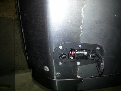

*Mounted new bonnet latches

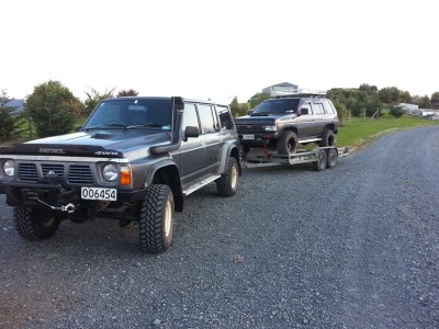

P.s what better way to tow it into town than with another trusty old Nissan, and i must admit due to the turbo big enough to suck a small child through the patrol pulled the terrano very well even up large hills...take alot to break this bond with Nissans

make sure the sealant you used was not a silicone based sealer, silicone and petrol do not get on and will quite rapidly fail as a sealer.

Yup your right there Pedro, i have tested the stuff in a small fuel bath and it seemed to with stand quite well...
