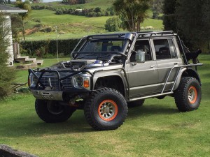

right got quite abit achieved today although it looks like nothing in the pics...
gearbox crossmember is done, all of the extra bracing/capping bits for the front have been cut and some tacked in. Know where the final mounts of the lower arms are going, decided to move them. Just need to do spring pads and shock tabs next then the 'unknown' part of the build will be done.

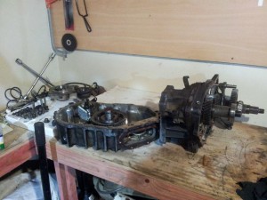

rebuild front diff,
