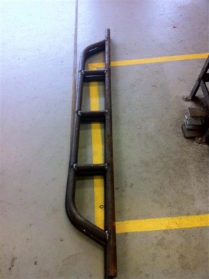

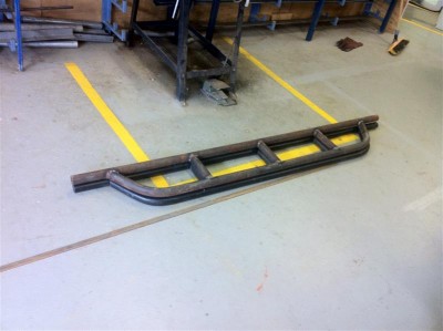

Well the sliders are sort of finished, I just have to make the brackets to hold them on there now. Now you can see the reason for the jig.
They are identical
They are identical

lax2wlg wrote:Its the difference between a professional craftsman and a redneck with a pipe bender...I want sliders like that, just chopped down to suit the 'finder wheelbase.
Hardly, If you went into a fab shop and said I want a pair of sliders I can 100% guarantee they wouldn't make a jig off the first one to make the second one, any good fabricator could make a pair and get it within a mm.
The more likely scenario would be the boss riding the workers ass cos the customer complained about the bill because of the extra time.
The jig did serve a purpose in this case, Jigs have there place.

wax wrote:Well the sliders are sort of finished, I just have to make the brackets to hold them on there now. Now you can see the reason for the jig.
They are identical
Now for the fun bit, are you bolting them on or welding them?

Mmm not sure about that. I have seen some crap jobs by fabricators that would make a person cry. I like to use jigs where I can so that I know things are spot on. I guess it's just me and maybe I am a bad fabricator
I'm going to be bolting them on. I will make the brackets next week, sandblast them then paint them

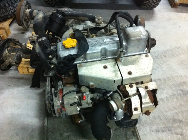

I have been busy finishing the painting on my truck so the guards and doors will be on soon. I have to pick up a new bonnet and then its good to go. I was looking to put in a qd32 but I had a stroke of luck and was given a bd30.
If you dont know what that is its a direct injection not indirect injection that bolts into a d21 / d22 Nissan platform
It uses the td27 bore with a qd32 crank. and no need for glow plugs.
direct injection makes about 30% more power on average than indirect diesel. They also run cooler as well so its a win win. 300hp is not out of the realistic possibility for this engine.

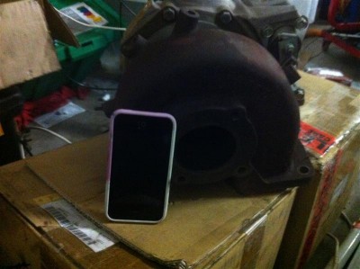

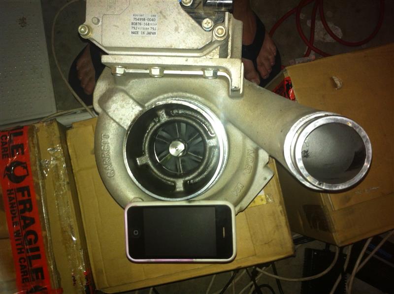

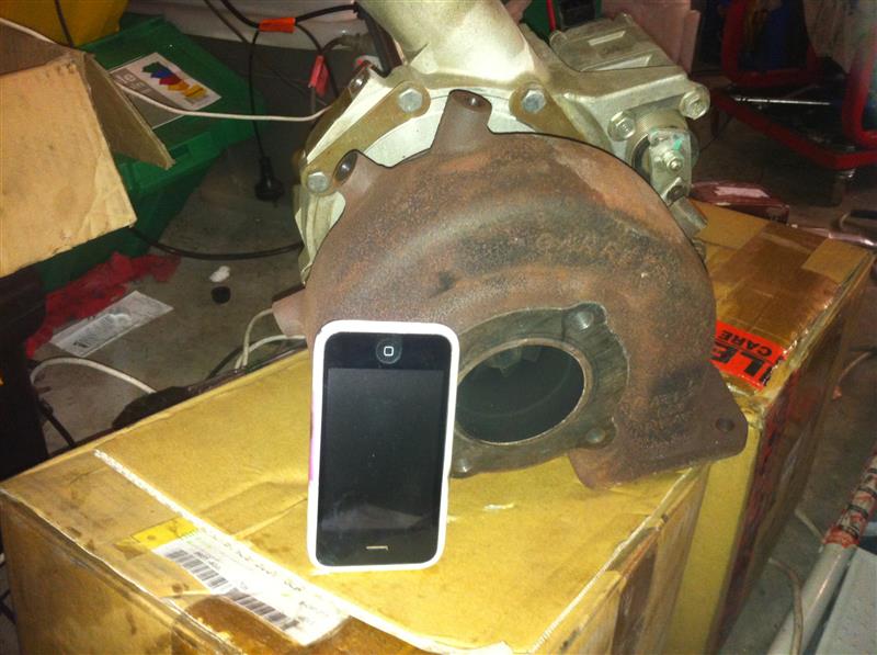

This is the big turbo im going to run on it to make the grunt. these turbos can make 200kw on a big diesel that spins to about 2500 so on my bd30 at 5000 it should be quite the little rocket.

Yup holy cow is right. These things come with a 12mm pump std. Its out of a jap import cabstar/ atlas. The ultimate td based engine you can get / build.
I wanted one so bad but near impossible to get one in aussie. More power but more economy , direct injection is awesome. They are noiser but so what I dont care about a bit more diesel clacker
Bd30 in a patrol
http://www.youtube.com/watch?feature=pl ... pJEg2Xr79Y
Bolt straight to a td box and mounts
Bd30 in a patrol

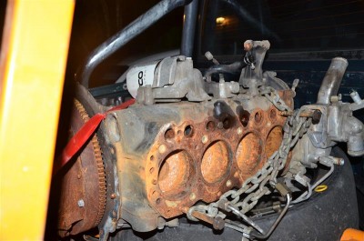

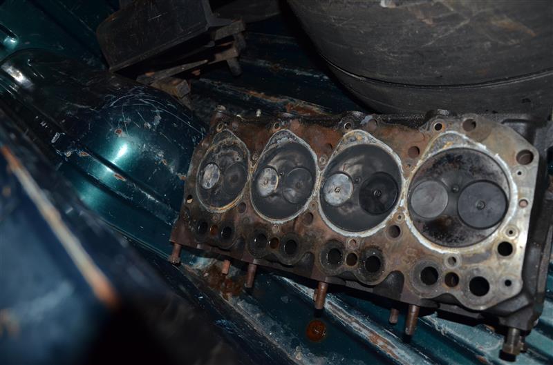

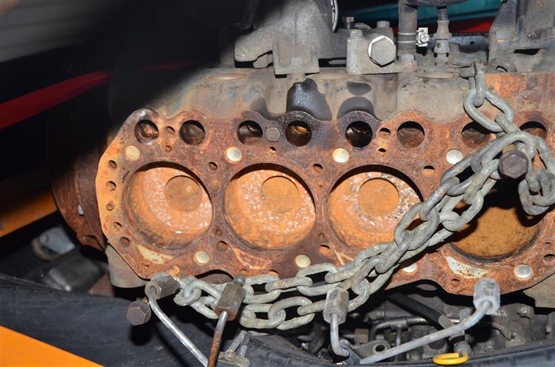

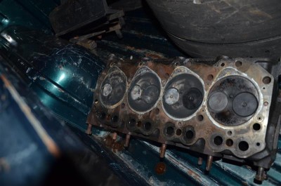

Ok picked up the engine today
Going to need some work and a conrod but all good. I can fix it

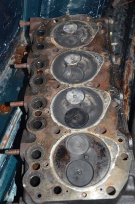

Looks its a td27 with di pistons.
Its also a td head with out precoms

This is the ultimate in the td bd qd series if it ever pops. Its direct as well so more torque just what you need

Sensational. Now it makes sense what the South Americans are on about when they talk about their 'cabstar conversions'
Are there any bottom end differences ie; in theory could you bolt the d/i head & fuel system to a td27 block?
Re: The navara terrano morph
Yes you could its pretty much a td27 block with a qd32 crank.
I need a con rod and im just trying to figure out if that one just for the bd30 or its shared by something else as well.
All the other stuff bolts on manifolds fuel pump etc, flywheel
If you got hold of a bd25 from the Philippines you could make a bd30 put of it.

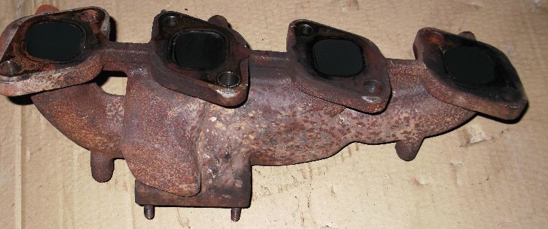

the td27 and the bd30 use the same headgasket. thats how close they are
The bd30ti comes with a 12mm pump std they just have a 1900 rpm spring in there so that will stop the fun at 3800, just a quick upgrade on the spring and you unleash the revs and more power.

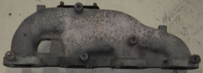

The bd30ti has a much better exhaust manifold as well than the td27t.
Its the hot rod of the td/qd/bd series

Hi Wax,
Nice sliders. Just wondering, how did you bend the tube? Look mandrel not crush bent....
Is the 'outside' tube with bends one piece, or joined?
Cheers.
Cheers.
Hi daniel, its a bender we have at work. Its not mandrel but its close it sort of rolls it. I will try and post a picture of it, but it is one piece of pipe. Its 2000mm of 32 nb pipe

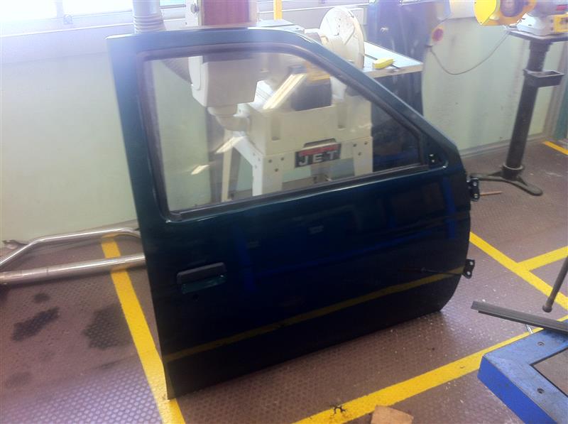

Well put one of the pathfinder doors back together. Its now got all new rubbers in it and being full piece its going to get rid of those big stupid mirrors it has on it.

Went into work today and finished welding up the rock sliders. Just have to make the mounting brackets now.

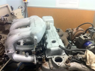

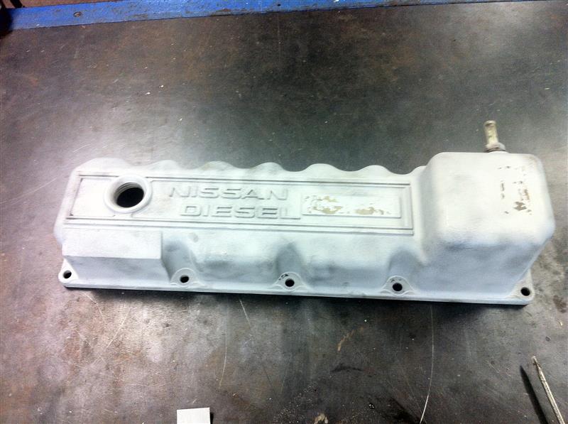

I sand blastered the rocker cover in preperation for its paintjob, kinda cool looking cover it looks heaps better than the stock one.
I cant wait to get this engine going
