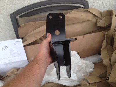

4x4part wrote:
XJCrawler wrote:RHD track bar and bracket arrived yesterday
can you let me no if it fits they are having problems with the track bar fitting with out hitting anything its when you have the wheel turned all the way to the left they mainly having the problem with the rhd over the nucle steering sistom hitting the track bar
How have you overcome it?

4x4part wrote:im waiting for them to fix it they trying to get hold of a right hand drive jeep if it hits with factory steering it will hit more with over the nuckle steering
So they sell a RHD track bar and bracket, and a RHD over the knuckle steering kit and haven't tested them? Find that to be a bit hard to believe, specially after seeing the quality parts they provide.
Sure you haven't been given a LHD over the knuckle steering?

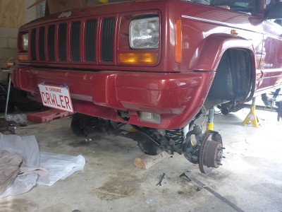

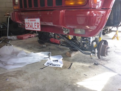

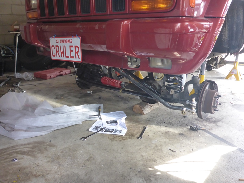

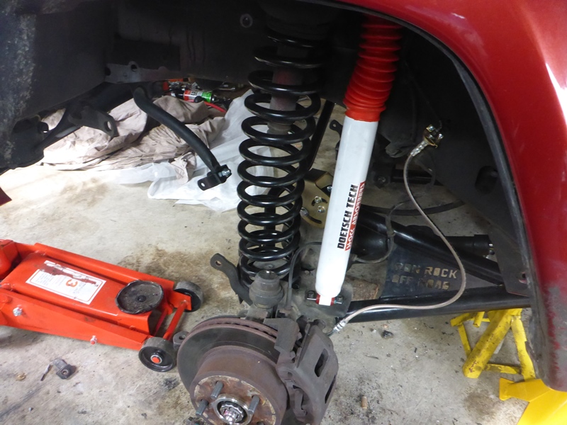

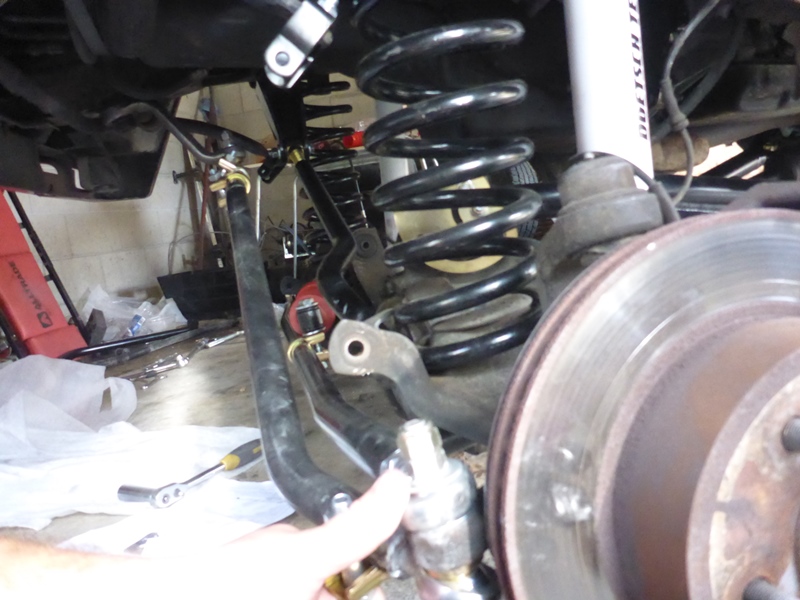

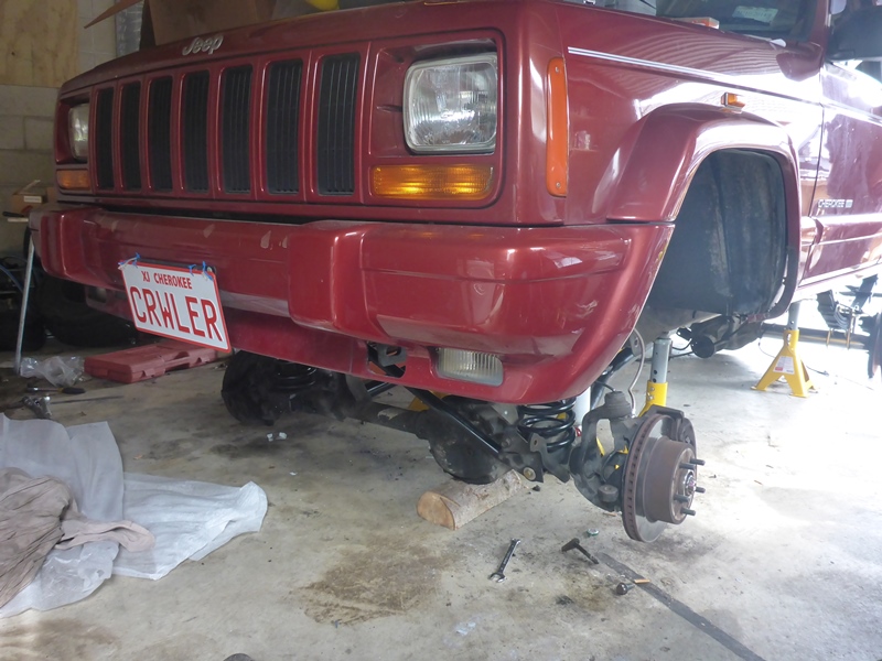

I'm back. Had a great time. First weekend back and decided to have the Sunday working on the Jeep.
New beefy over the knuckle steering installed. So far I can't see this being an issue with the track bar, the clearances seem fine to me, plenty there as you can see in the photos further on.
A starter shot to get back in to the project.
Full frontal nude of steering linkages.
Front under carriage shot before starting.

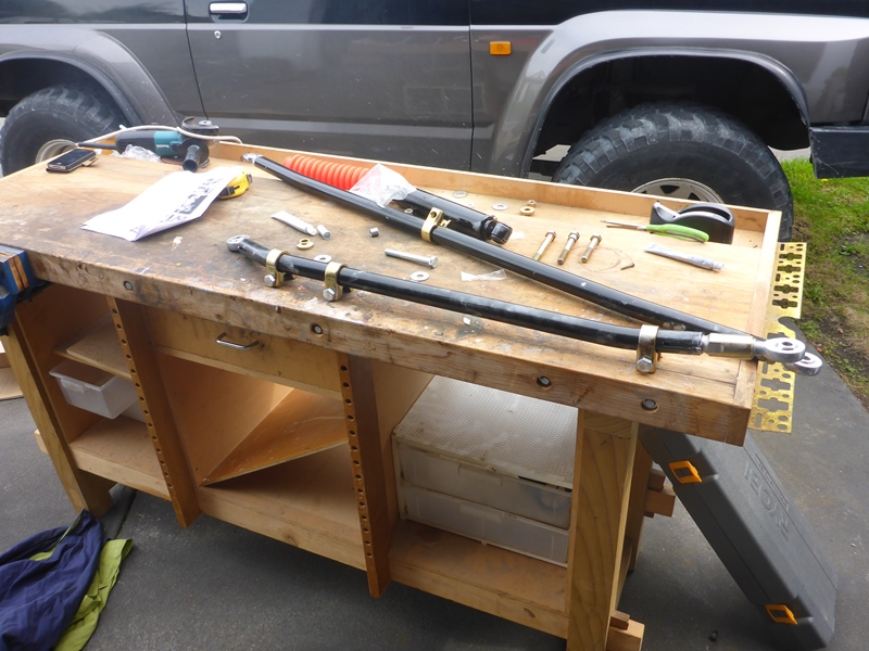

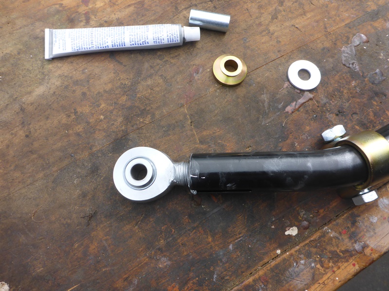

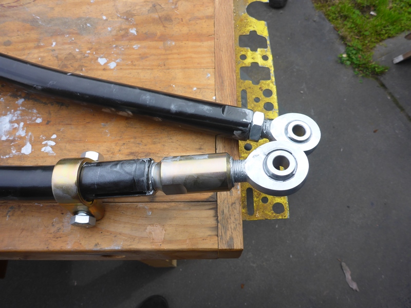

So I have actually bought a half decent camera now, so I hope the photos are a lot better for everyone.
These shots are the preparation of the kit. Didn't involve too much, you'll see I got messy with the anti-seize compound. The step by step instructions provided with the kit made this a breeze.
Close up of the sphere rods.
And another.
And another.
Components on the outdoor work bench on the driveway.

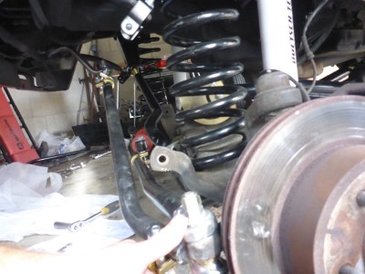

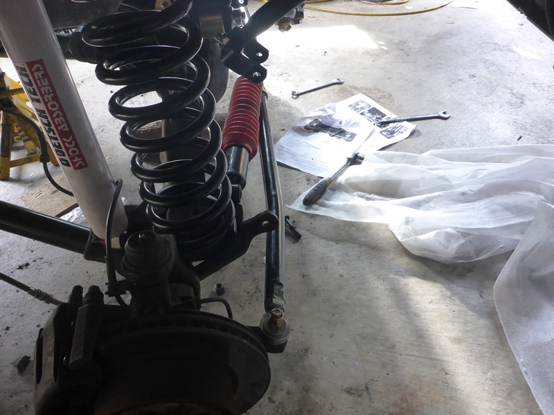

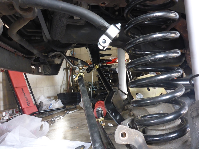

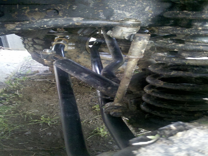

Photos of the new steering kit bolted up on the truck.
A shot showing some of the clearances and angles of the new steering components.
A more overall shot showing the clearances between all of the components. Plenty of clearance between the tie rod and the trackbar.

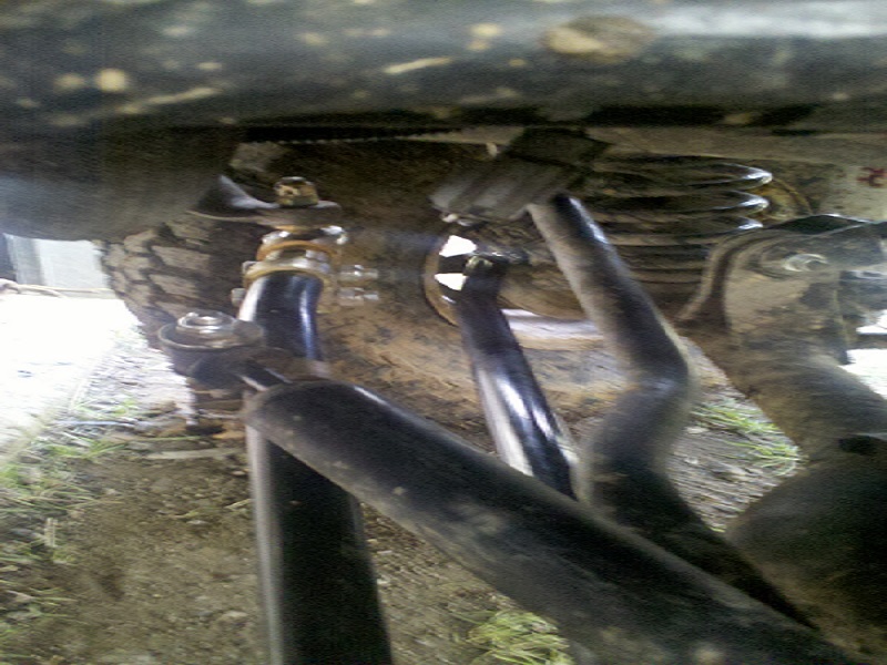

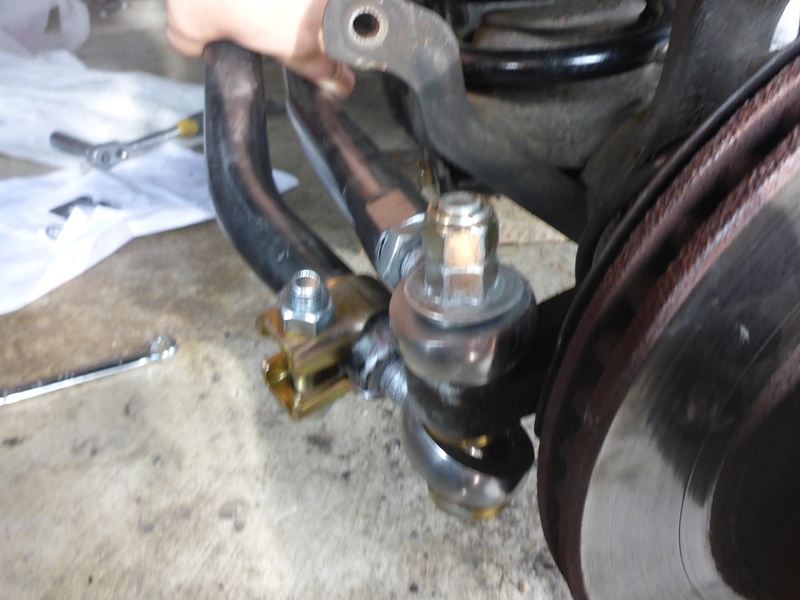

Apologies, this one come up a little unfocused. This shot shows the over the knuckle tie rod with the drag link on the bottom of the knuckle.
A close up shot of the draglink at the pitman arm end. This shows the double adjustable adaptor.

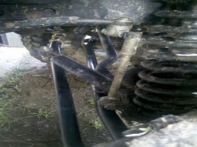

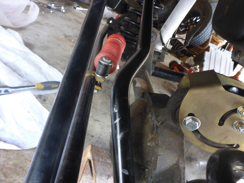

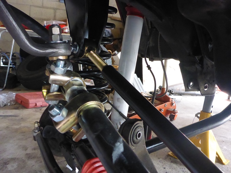

A couple more shots showing a location I've chosen at random for the steering dampener (please comment if you think it's not an ideal position). Also a general shot from the front after it's mostly all installed.
I did start working on the rear again. The Ford 8.8 is roughly aligned within .5mm, angle is roughly set. Just got to get a better measuring tool for setting the alignment as I did use a tape to set it roughly in the right place. All going well plan will be to have the ford diff leaf perches welded on completely, and possibly the shock mounts too by next weekend. However I've got an issue with snapped bolt where I think I'm going to have weld a plate with a stud coming off to suit. I'll replicate the same on the other side since I'm fussy like that. (except snapping the bolt).
A look from the driver side of the vehicle down toward the steering dampener.
Steering dampener rough position.
A final shot of the kit the installed.

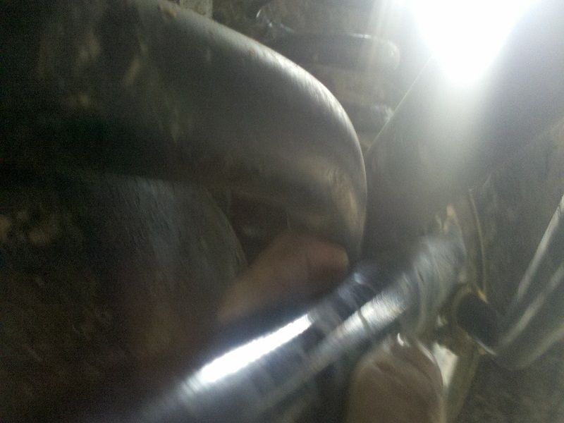

can you put a photo up for me of it on full lock to the left i want to compare to mine if you can could you put some whate on the axle as if it had wheels on. this is a photo of mine you will see the problems im having i have.
XJCrawler
Posts: 209
Joined: Mon Mar 12, 2012 1:47 pm
Re: Project XJ Crawler
Post by XJCrawler »
I need to try it when it's on the ground, but I've loaded the axle up and full locked left and I've got an inch clearance between the track bar and tie rod. It does however get really close to the factory mount for the sway bar, like 2mm of gap

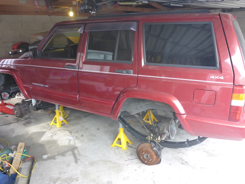

Rear diffs aligned, pinion degree set, leaf perches tacked. Shock mounts go on today. Photos to come
