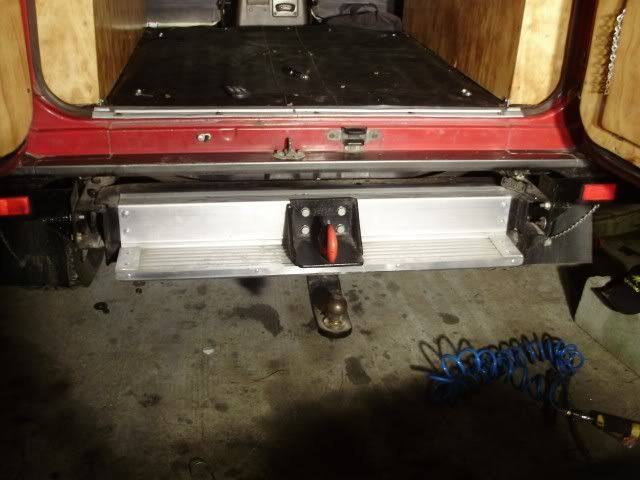

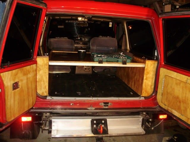

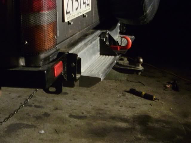

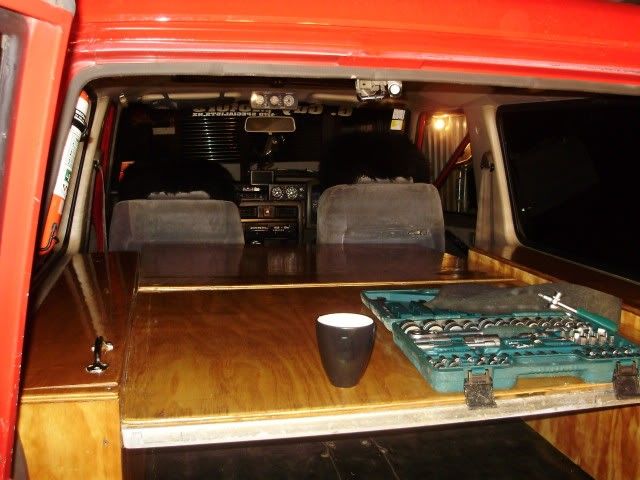

Decided that I needed to make the bed easier to get into, so tonight after work I fished out the remains of the original rear bumper and grafted part of it back on and capped the ends to tidy it up a bit:
Makes access easier
The cool little end caps I made 8)
Doesn't hang out as bad as I thought it would:
The Bed for those that have forgotten (yes, its a SWB) :lol:
Good effort the evening I thought :mrgreen: :mrgreen:

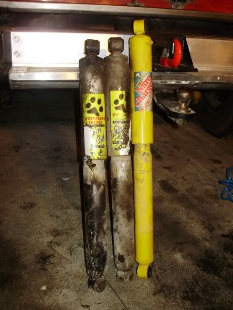

I pinched some OME Nitro Charger shocks off Wopass to try in the rear with the new EFS springs I put in a week of so ago.
The TuffDog shocks I have in it were to hard, they were a competition shock, it was like driving a lowered car on the road :lol:
The shocks:
OME are slightly longer extended and the same compressed, so will have more down travel. The valving is fixed, but set so that there is minimal compression damping but strong rebound damping. They should make good touring shocks.
The Tuffdogs are just rock solid, even after years of use, and they are a foam cell shock. The valving is wrong for your average four wheeler!!!!!

Awesome truck mate. Would really like to see more pics of this bed setup that you have, would like to something similar with mine
