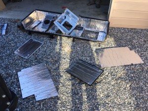

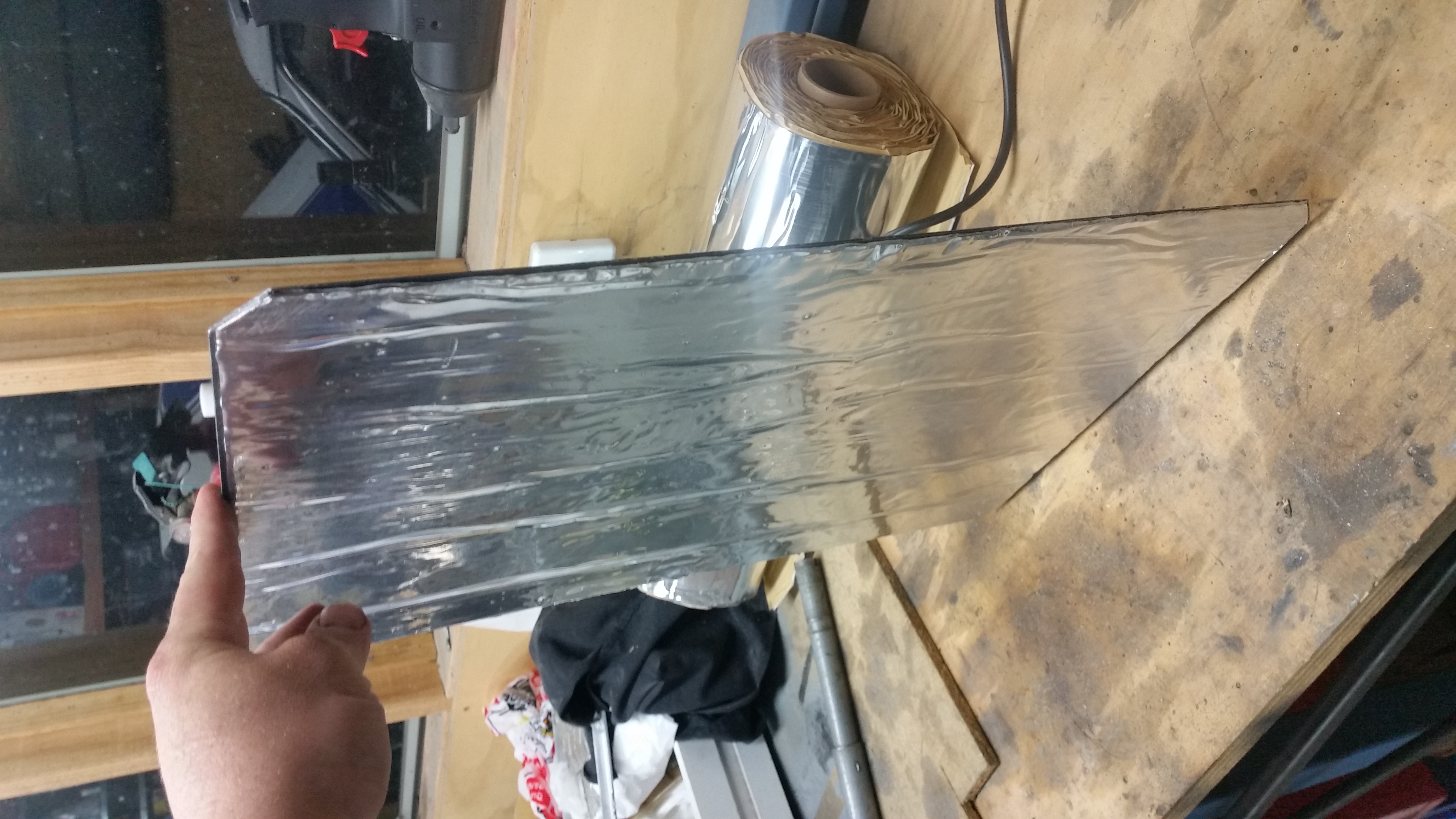

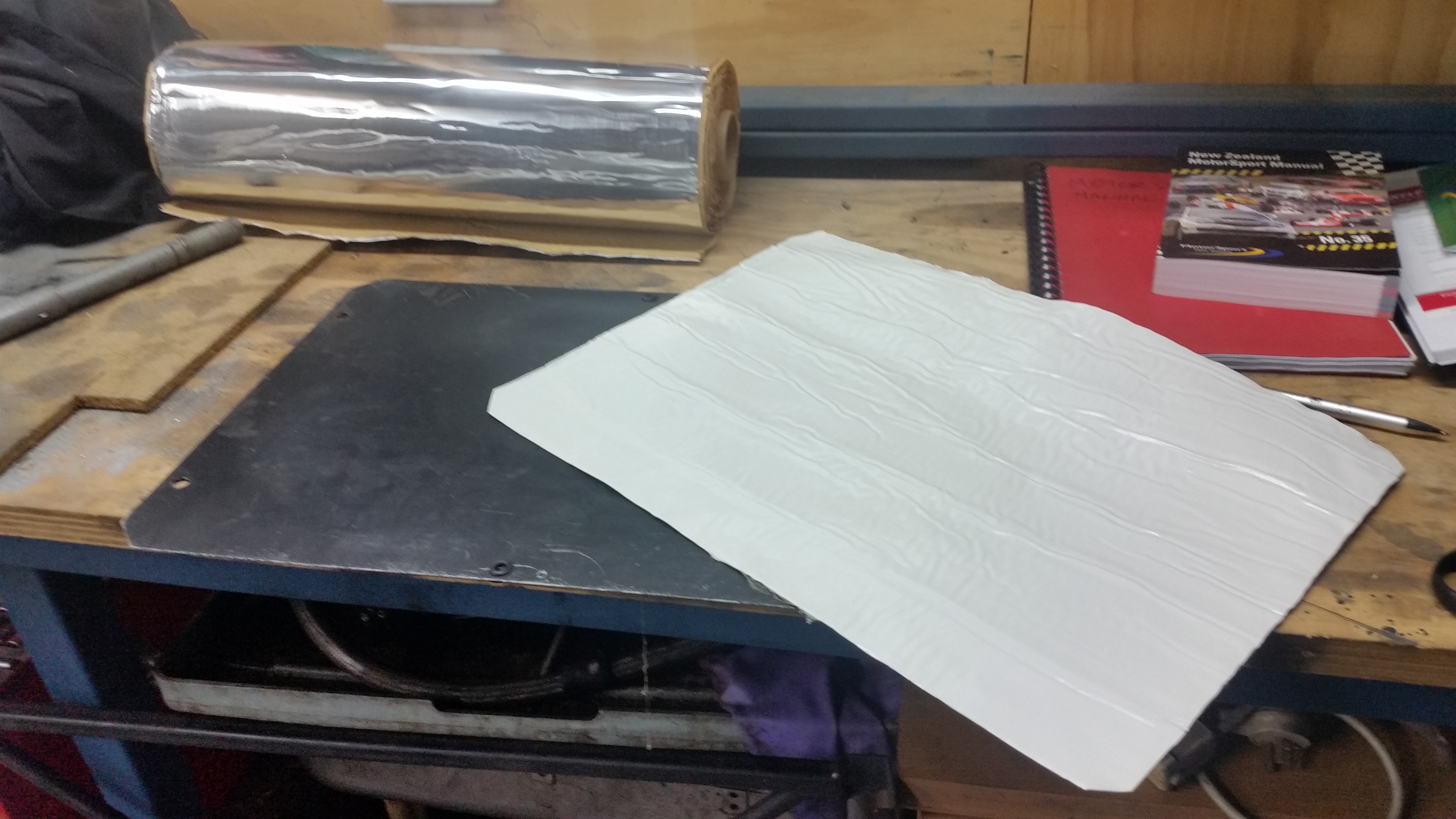

Finally bought some sound deadening. 6m roll 460mm wide for $165 to the door step off trademe.
Just did little trial on part of seat box tonight. Will rip out the whole seat box on Saturday.
Thought I'd take a few pics of this one. I'm not planning on sticking any to steel at this stage, only alloy.
Want to do entire seat box, floor, rear bulk head, doors and double layer the gearbox tunnel and I think that will pretty much shag the roll.
wjw
Posts: 3420
Re: V8 Land Rover project
Post by wjw »
I need to get some of this now, have changed my plan. Have bought a new moulded marine carpet for the 80, and want to put stick stuff like this to it as a backing. are you going to glue it? let us know what the sound absorption's like.
Who knew Prados could fly?
oldyella
Posts: 570
Post by oldyella »
So this is the seatbox and underside of the floor all done. Also took it for a small test drive from Cromwell to the new place in Tauranga :lol: Noticeably better. Also managed to do the rear bulk head with the one roll and the gearbox tunnel got a couple of layers for good measure.
It seems to be handelling the underside of the truck fine in terms of heat and oil but I haven't hit it with the water blaster yet which is probably the only thing which would make a real mess of it.
Other than that, any joins it spooges out, kinda has the consistency of dried up chewing gum. I overlapped everything because I figured it would kinda deform and seal where the panels join more than if I had cut them short. Also less likely to peel off I figured.
